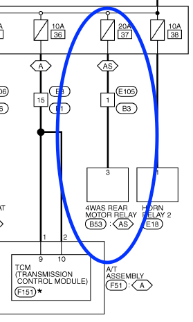

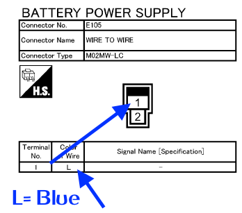

Hi i replaced the body compartment wiring harness and can’t find out where this connects to on the driver side kick panel area. (1) Blue thick wire

That appears to be the power wire for the 4WAS (4-Wheel Adaptive Steering) relay. Your car may or may not have that system (I doubt it, but possible).
Is there a empty "slot" next to where the blue wire is?
Unless your car has 4WAS I would just leave it alone.

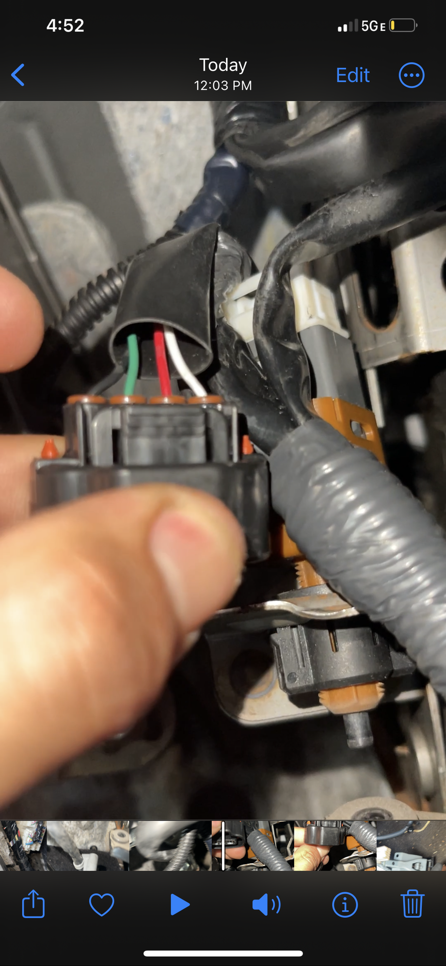

Do you know what the connector may look like?
There is one more connector thats loose and I can’t find where it goes to. I believe its a 4 pin black/orange connector thats rounded.

re: mystery connector, please provide a pic and/ or location for me to identify.

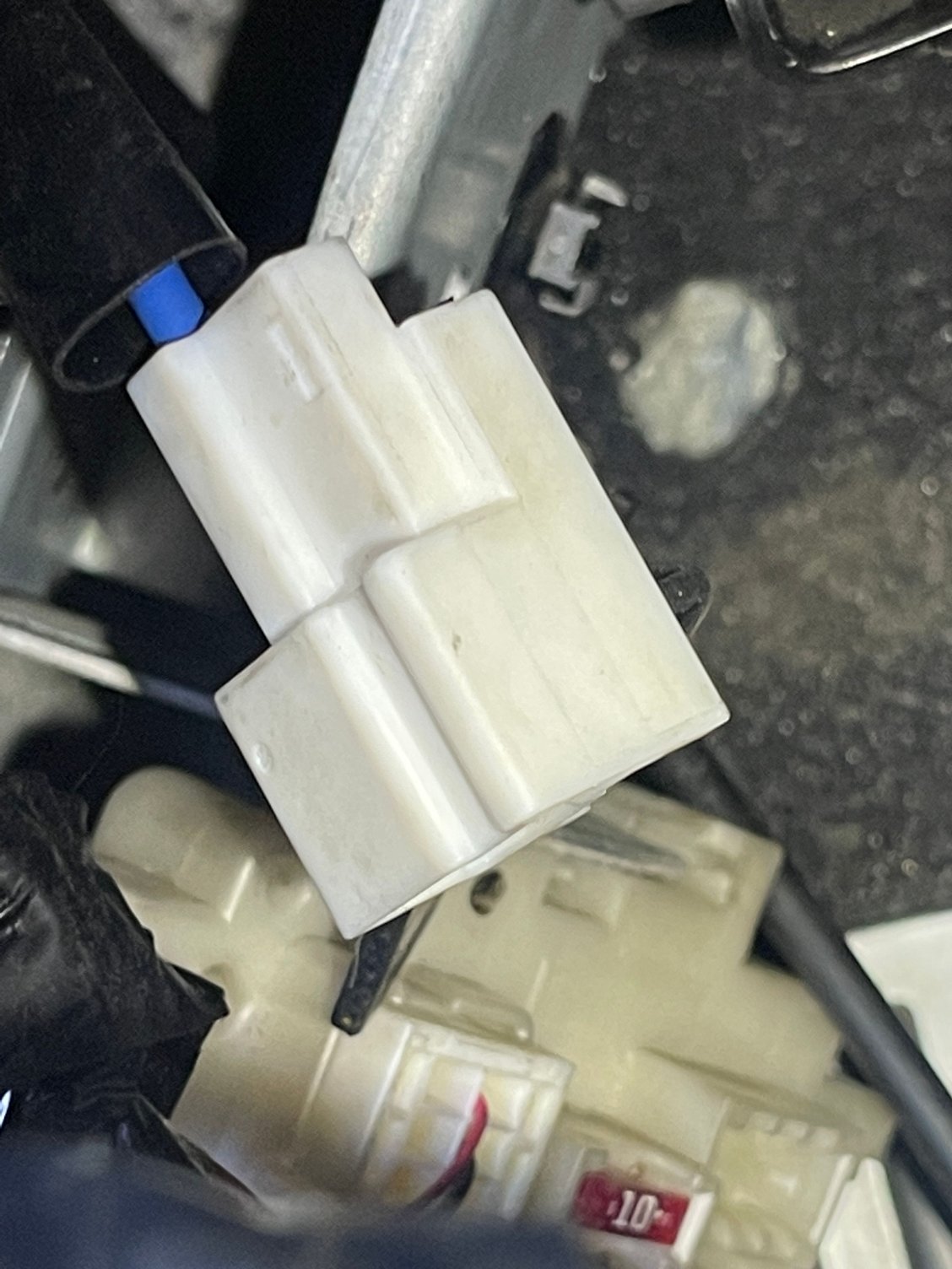

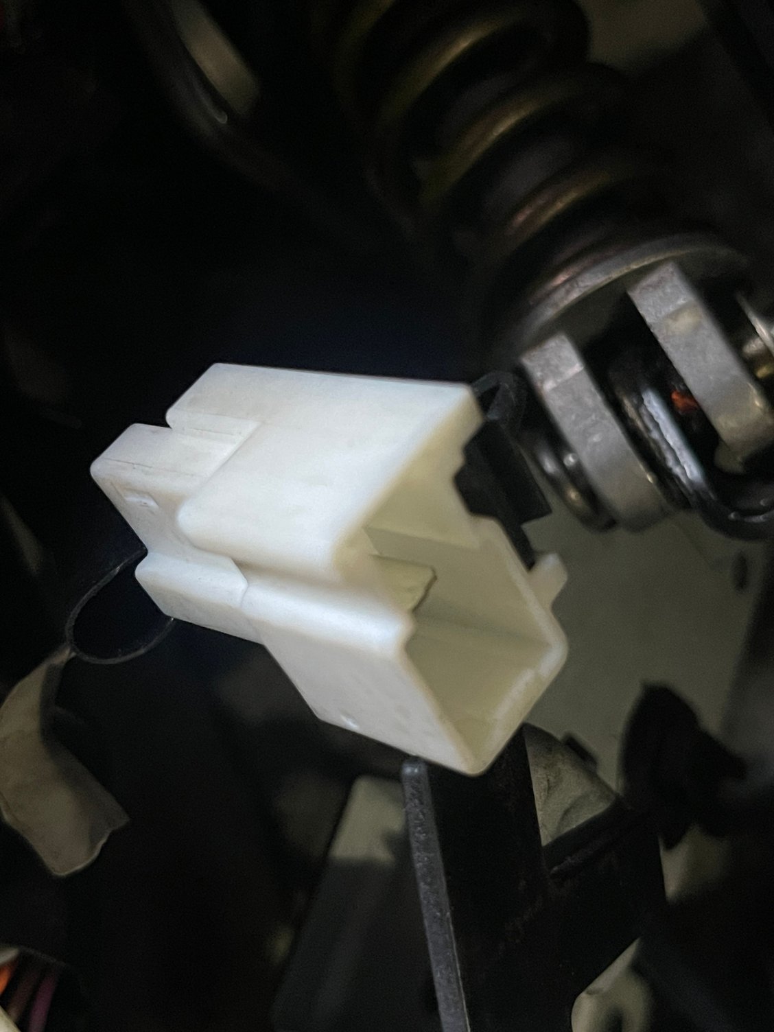

Hi, Here is that one black connector I was talking about.
I havent had time to go and check if the start button illuminates but im pretty sure it does last time I checked. Thanks again
Old Aug 7, 2023 | 08:40 PM
ILM-NC G37S's Avatar
ILM-NC G37S
Joined: Apr 2014
Posts: 4,856
Likes: 1,612
From: NC

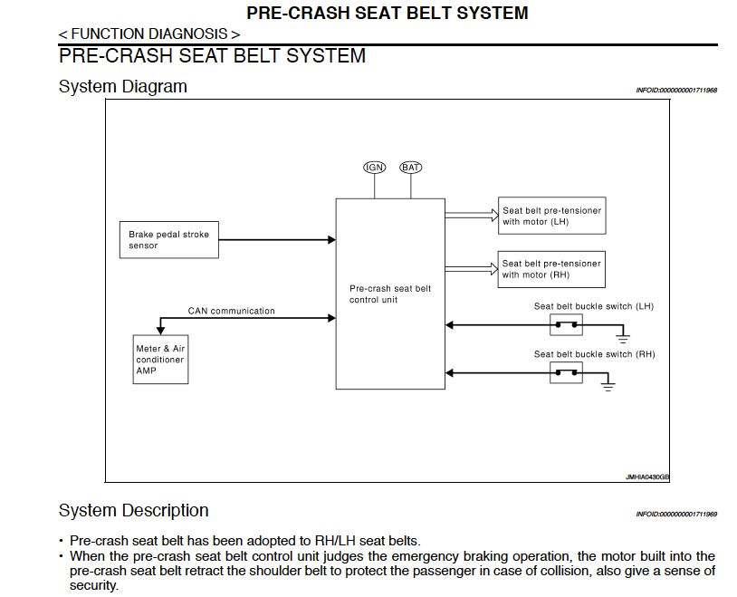

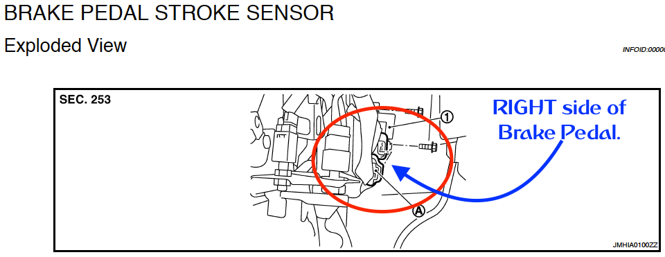

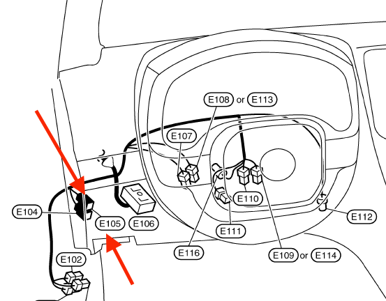

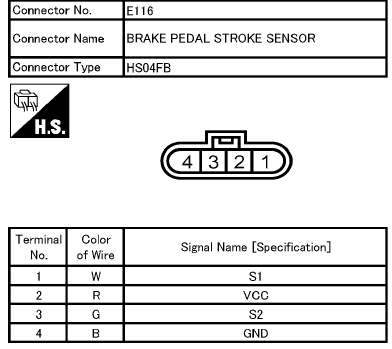

That connector is E116 which is for the BRAKE PEDAL STROKE Sensor. This is used for the Pre-Crash Seat Belt system.
This should not have have any effect on your current symptoms, still, plug it in and see.
