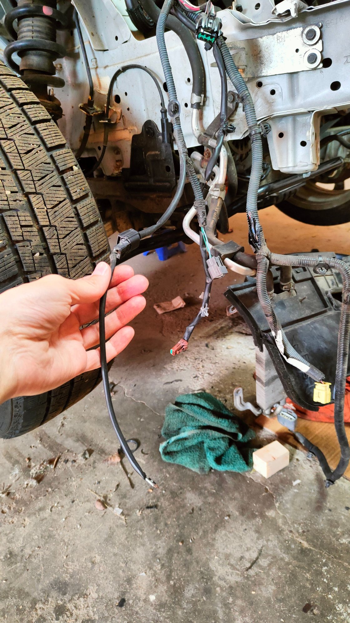

Hi everyone! I rebuilding 08 coupe and I have unknown wire do you have any idea what is can be?

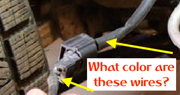

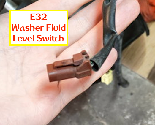

Here is what I found so far...
I need a closeup of the wires for this connector:
Thank you for your help. Broken wire black and white. And connector wiring black and green

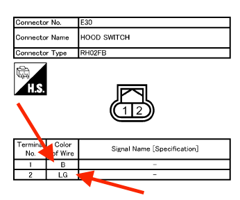

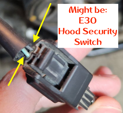

I am not 100% sure that the pictured connector is for the ABS wheel sensor.
The wire colors in the pic (BLK/ Lt. GRN) tell me that is E30/ HOOD SWITCH:

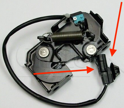

The (broken) BLK/WHT might go to the passenger-side hood latch which has a switch on it for the SECURITY SYSTEM. When armed, if the hood is opened, the alarm will sound:
@Sven93 , double check everything just to make sure. If you look at the passenger-side hood latch, is the wiring intact?

@ILM-NC G37S You are correct.
Looking at the pictures, the hood switch changes color from a sky blue to a black and white which look similar to the black white connector for the ABS.
After looking at that black white pig tail I noticed that the ABS after the female connector is a solid insulation with no wiggle room unlike the accessible one of the hood switch.
