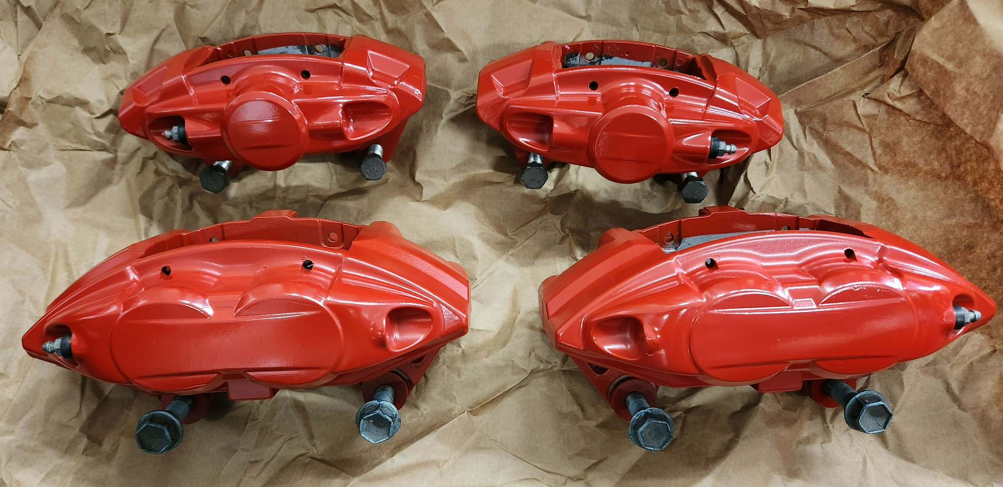

I scored a set of Akebone calipers and OEM rotors for my 13 37X sedan.
I am prepping the parts for install and it occurs to me that my 18" factory wheels may not have sufficient offset to clear the rotors.
Rudimentary measurement reveals it's gonna be close.
I'd rather space the wheels than replace them.
Can anybody tell from the specific model of wheel whether I'm going to have an interference issue?
Thanks either way.
refinished, waiting for black Akebono decals

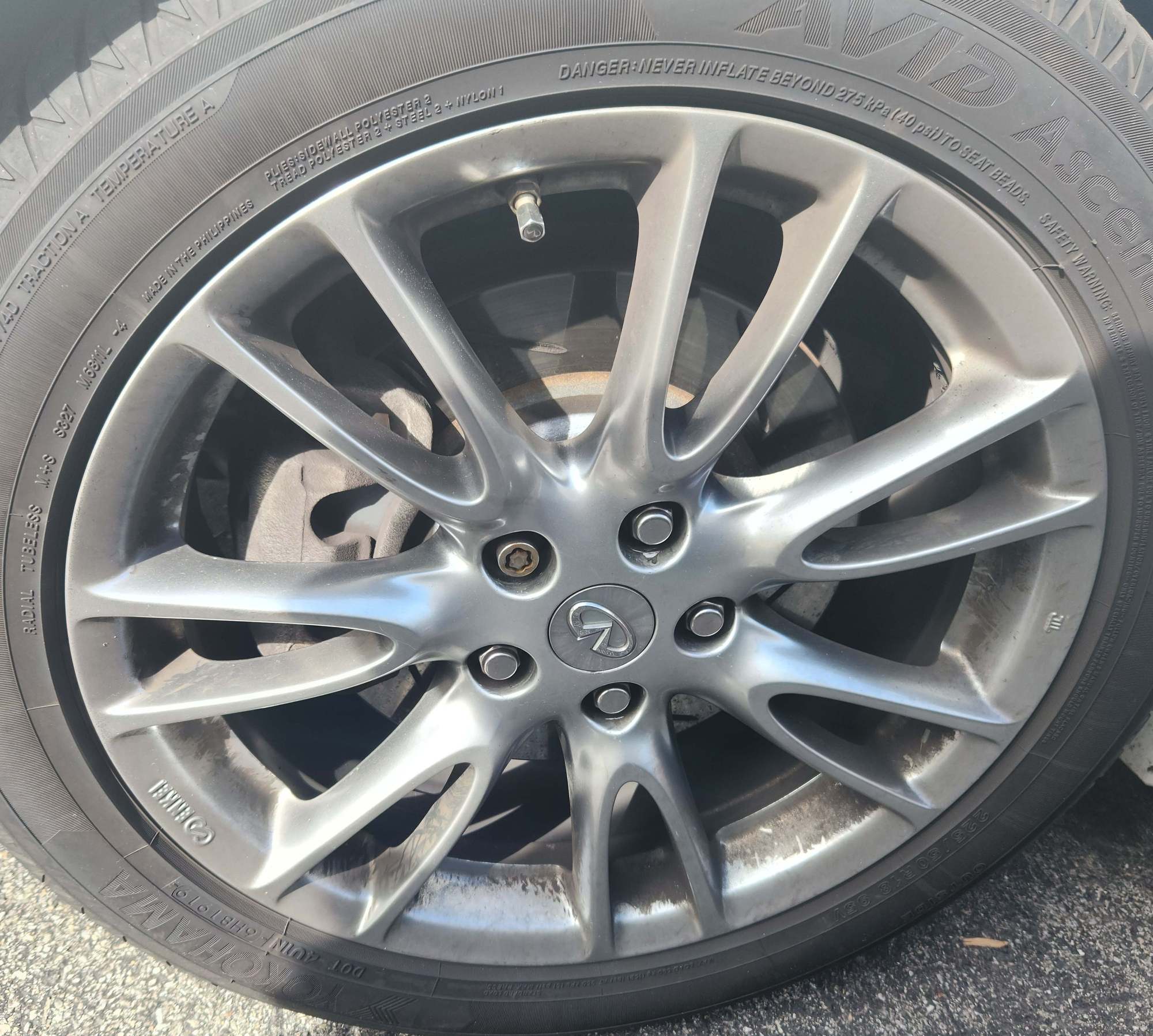

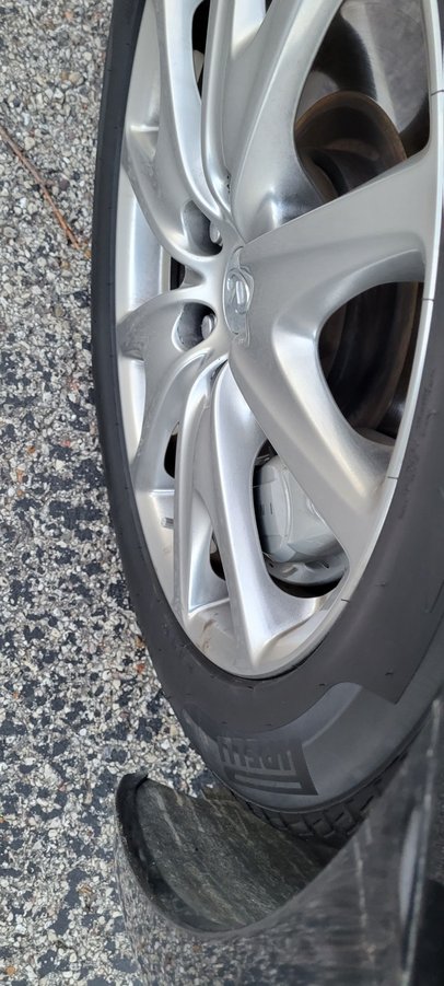

I had to get the square duck feet to clear my BBK. They clear without issue, no spacers. Using the 18x7.5 OEM Enkei Duckfeet. I made a post about this here: https://www.myg37.com/forums/g37-sed...enono-bbk.html

I wasn't sure about which Duck Feets would work. I found references to both 7.5 and 8.5 widths on the interwebs. I found used 7.5s available but they did not look great and I wasn't sure they'd fit so I bit the bullet and bought new 18x8.5 Enkeis and 245/45-R18 Conti Extreme Contacts from Tire Rack. All together now it looks pretty good and stops like it goes now. Stillen SC helped me run a 12.966 at Maple Grove last season. Rapid Grocery getter.
