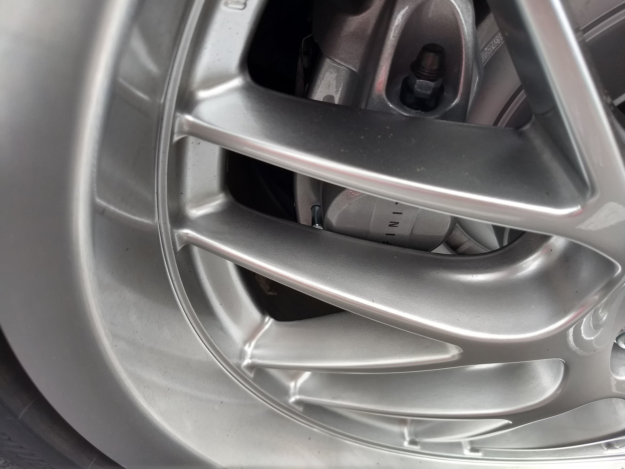

I had to have spacers for the front wheels. The back wheels fit without spacers. I run a staggered setup.
Yes, the offset wasn't enough for the fronts.
Check out how close the rear wheels are to the caliper:
Oddly, the much smaller OEM 18's have way more clearance for calipers than these bigger, wider rims.
