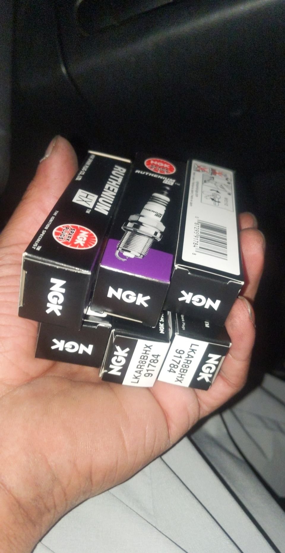

So I recently started having a handful of problems with my base 2011 g37 160k. It all started when I was going 140mph way up in the rpms when my motor started misfiring. Took a look at everything and the codes p0300 random misfire & evap small leak and I came to the conclusion that I had broke the sparkplug gasket (driver's) so I replaced that and the valve cover gasket on my driver's side, along with all 6 new NGK Plugs. Went to start her up and still getting a misfire except now it's giving me codes for random and cylinder 4. On the Driver side the first cylinder and the last cylinder were the only ones where I found oil in the sparkplugs so those were the ones I thought to first replace the coil packs at. I got 2 cheap but not cheap import directs coil packs from oriellys and I put it in firing cylinder 4 and boom she drives fine for a solid 24hrs then starts to misfire again this time codes claim from cylinder 3 and random. I put a used plug from one of the cylinders that had oil with the spark plugs in it, in place of the newly misfiring cylinder 3 for ****s and giggles and still no avail. If I get 4 more import direct coil packs do y'all think I'll resolve my issue? My mechanic said it could also be my fuel injectors?

NEW PLUGS, CORRECT ONES??

As for plugs you need Denso plugs (expensive ones) NGKs will work but finding a misfire issue with NGK plugs can have you replacing everything.
Start with cleaning the old coils first, switch some of the coils and plugs around as well and keep trying.
