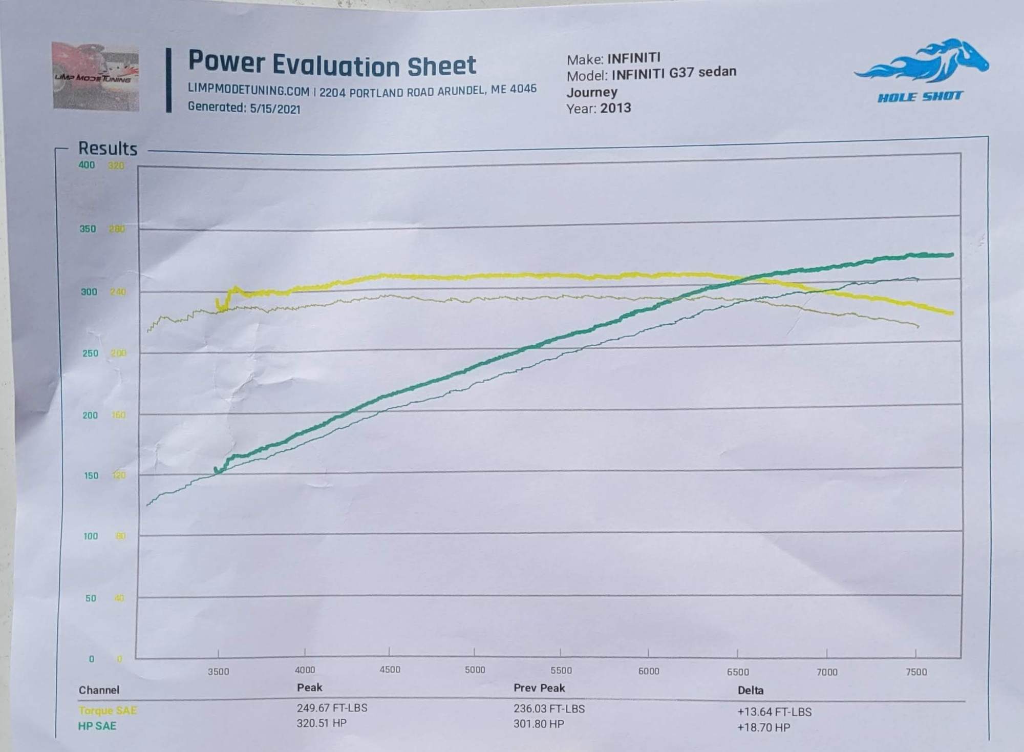

I tuned with Limp Mode Tuning in Portland, ME. They did a great job with my car. My mods engine wise were: ISR Resonate Test Pipes, Invidia Catback Exhaust, aFE Pro Dry-S Filters, and Z1 Intake Tubes.
I was sold on Ecutek because of the phone app. It meant that you could change maps while driving, view live engine data, data log (great for re-tunes or e-tuning), and read diagnostic codes on the fly. That was something that Uprev does not offer (at least that I know of).
Talking with them, they told me that it was down to preference as results will generally be the same unless with you were running FI.
Attached are my gains:
