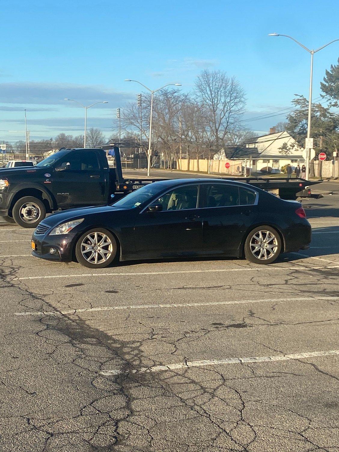

Anyone ever experience their car not responding during acceleration? Just swapped a low mileage 2017 qx50 motor with 21k into my 13 g37. Put about 850 miles on it and for the most part it’s been smooth!
This morning I was trying to accelerate and the car wouldn’t respond and when it tried to, it would rev slowly. This happened prior to the motor swap also. Thinking I need to update my ecu. Car was fine after I shut it off and got back in.
Along with that, I smell a burning smell coming from somewhere on the car. Can’t pinpoint where. I’m thinking tire because the car was recently lowered and is pretty low with no alignment.
