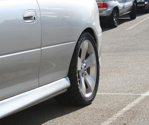

The 04-06 GTO community was stuck with a 235 wide tire on a 8" wheels in stock form. Many people ran 275s however they did bulge quite a bit. This will be fine for straight line performance but it will for sure degrade your handling capabilities.
