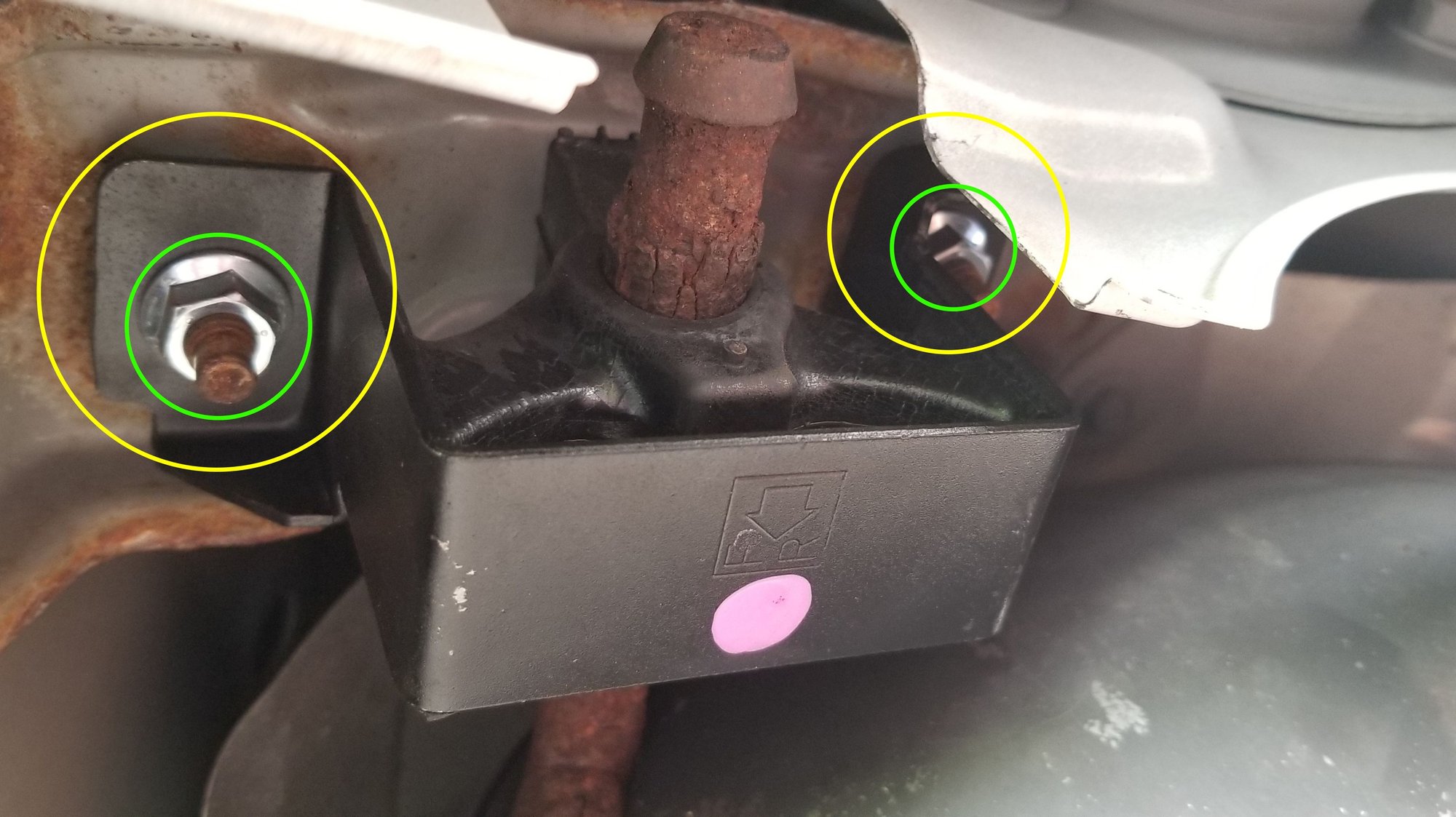

Final Update: Problem fixed. And the solution was so simple. The two nuts that attach the hanger onto the body above just needed to be backed out a little bit, maybe a 1/4" or so if that. By doing so, it provides just enough resistance to allow the muffler to move freely up & down without hitting anything. My mechanic was kind enough to give me a free pass on this one. He said it was about a 2 minute job which I totally believe! Needless to say, he's been very good to me and always gets me in that day or the next. I really can't thank him enough.
Here's a photo for reference:
1.) The plastic flange on the hanger that attaches to the body is circled in Yellow.
2.) The nuts that needed to be backed out/ loosened circled in Green.

Essentially lowering the muffler 1/4", right?
Now that you know you needed the extra clearance at the muffler(s), wouldn't it make sense to put 1/4" washers on the underside of that bracket, so that you can torque down those nuts? The only thing keeping them from backing off now is the rust.
Yes, exactly... You're right, it would make perfect sense. They may have done that already, I'll have to verify. At this point, I'm just very relieved that it's fixed. I'm not sure how much longer I'll be keeping the car to be completely transparent. I love it to death, it is one of the best cars I've ever owned (had a 2012 sedan prior to this one) however the lack of storage space & rear seats not folding flat is becoming a bit of a deal breaker. An SUV is what I need right now & for the foreseeable future.
