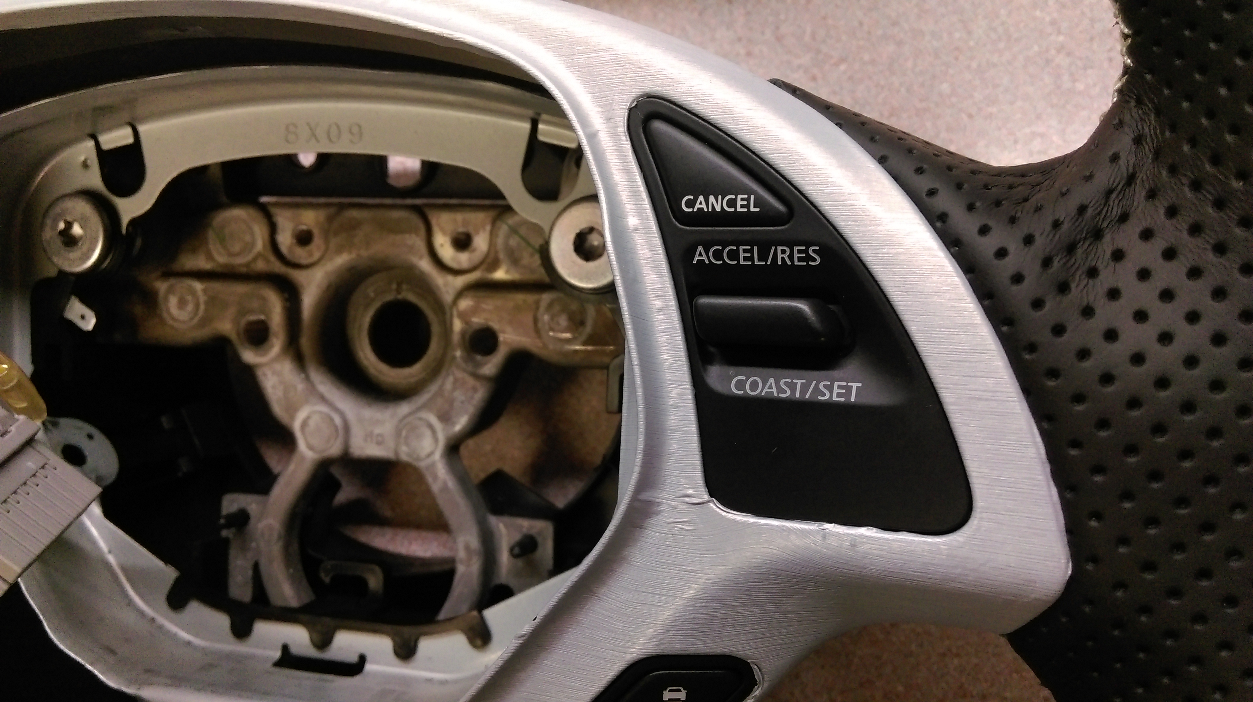

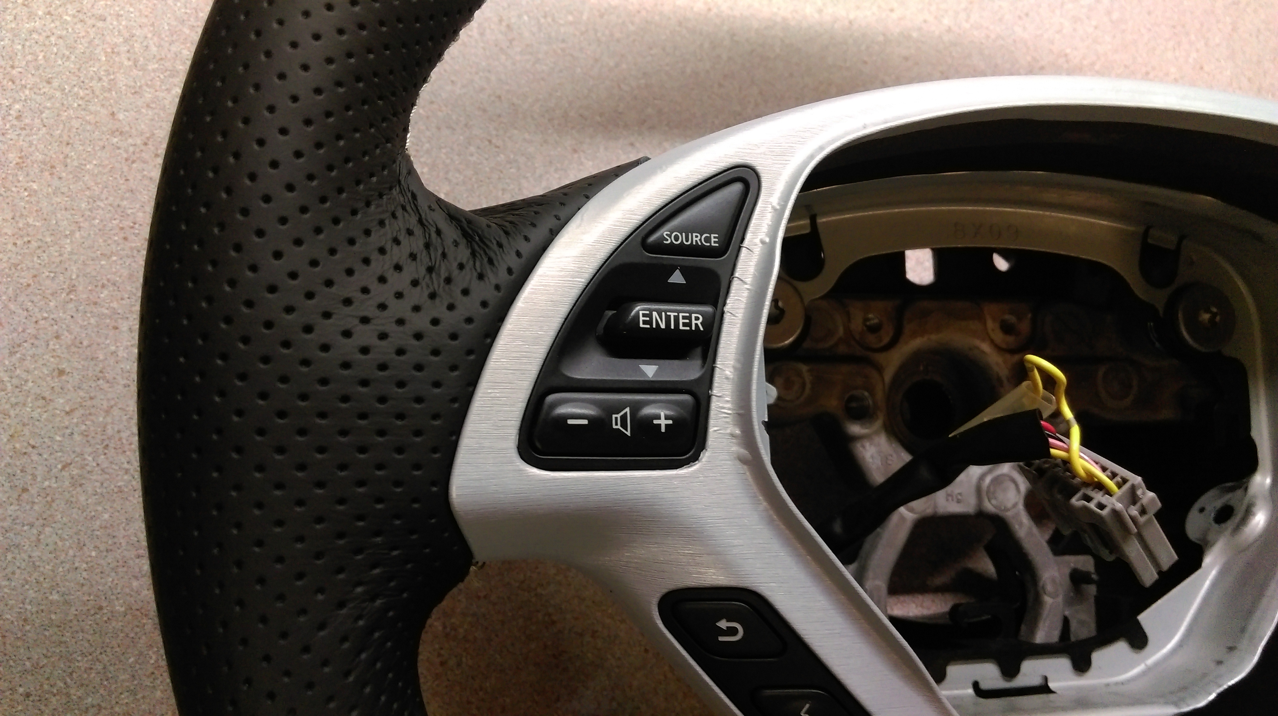

Leather wrapped my steering wheel. Super happy how it turned out!
Being my first time took me almost 3 hours but I feel it was worth it.
Made several attempts at vinyl wrapping the scratched trim piece but still looks terrible. Used 3m brushed aluminium wrap but couldn't get the bubbles out next to the buttons. Have to live with it for a week need the car. Anyone having any tips for that area?
Probably going to have to settle for paint.
Bubble pics

For small round bubbles you can use a small pin hole and push out the air, then run heat over it to reseal, but the wrinkled type bubbles would have to be pulled up & reapplied
That vinyl takes a bit of time to get a feel for what can & can't be done. I'd just give it another try, and don't do any hard tacking until you're happy w/ the placement and only use heat if you have to. Look like you got most of it to lay properly so you've got the skill.

Thanks for the tip sir! I'll give it another shot using a syringe next day off. Also, tried 3 different shads of brushed aluminium and this was the closest I have found. Everything I've ordered has been to dark or to light. The last one being still to light but the closest by far. Any leads on something that more closely matches the interior trim?

lay one big piece over the entire thing, cut the side and then take a heat gun to get it over the curves

Thank you, Mindows7, I wish it was that easy bro but that piece and my ocd its a bit more complicated. Thank you though.
