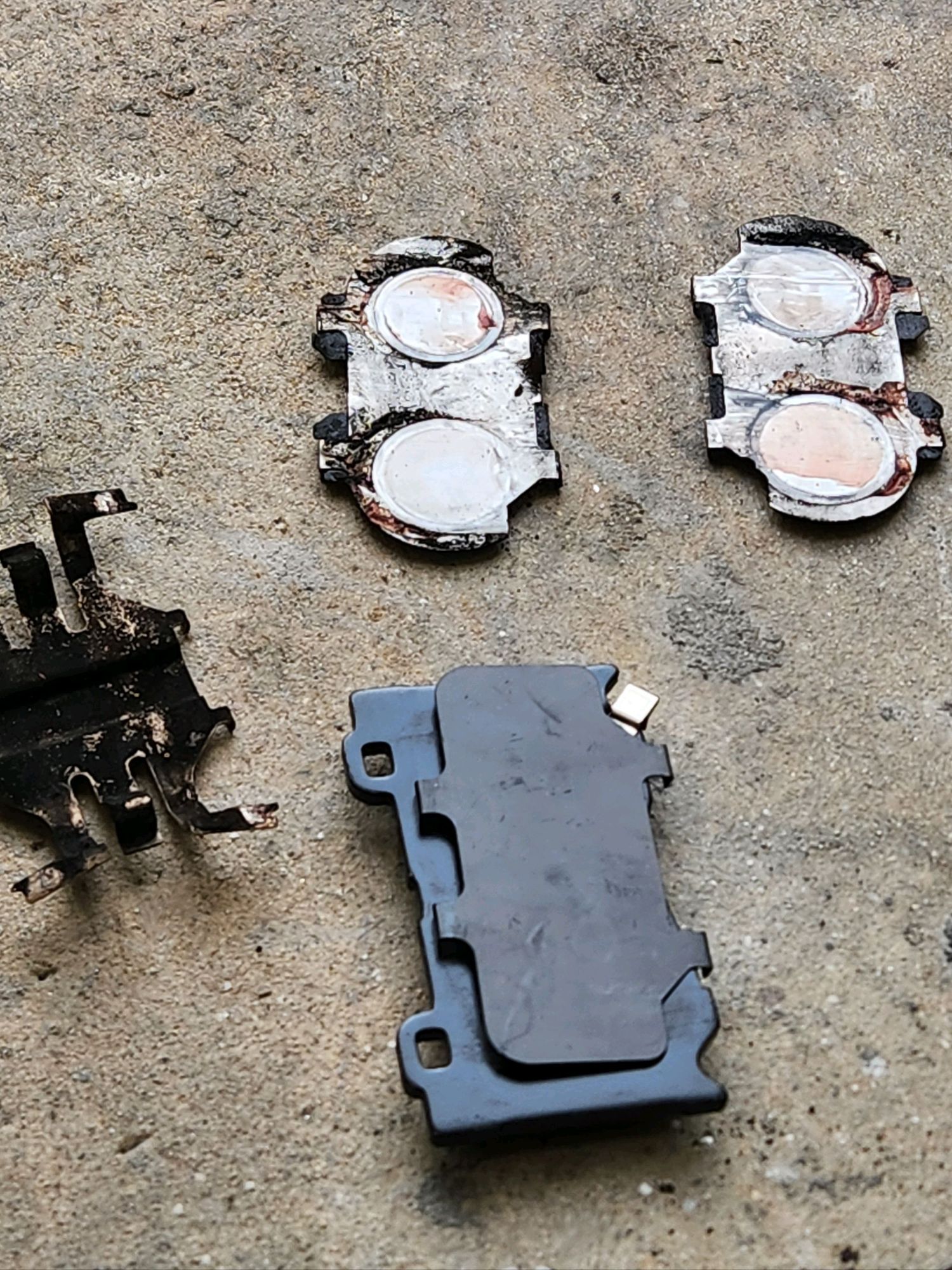

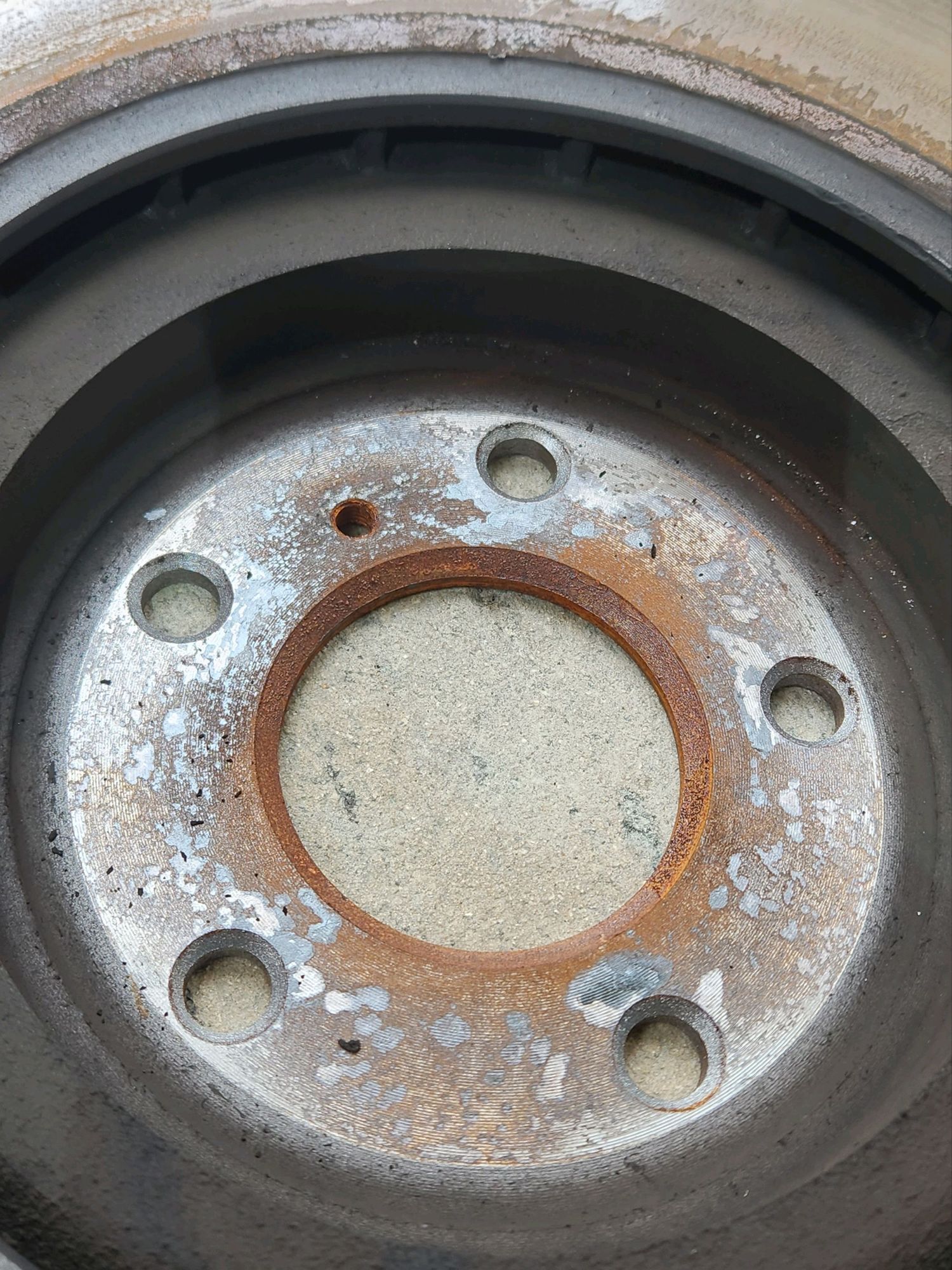

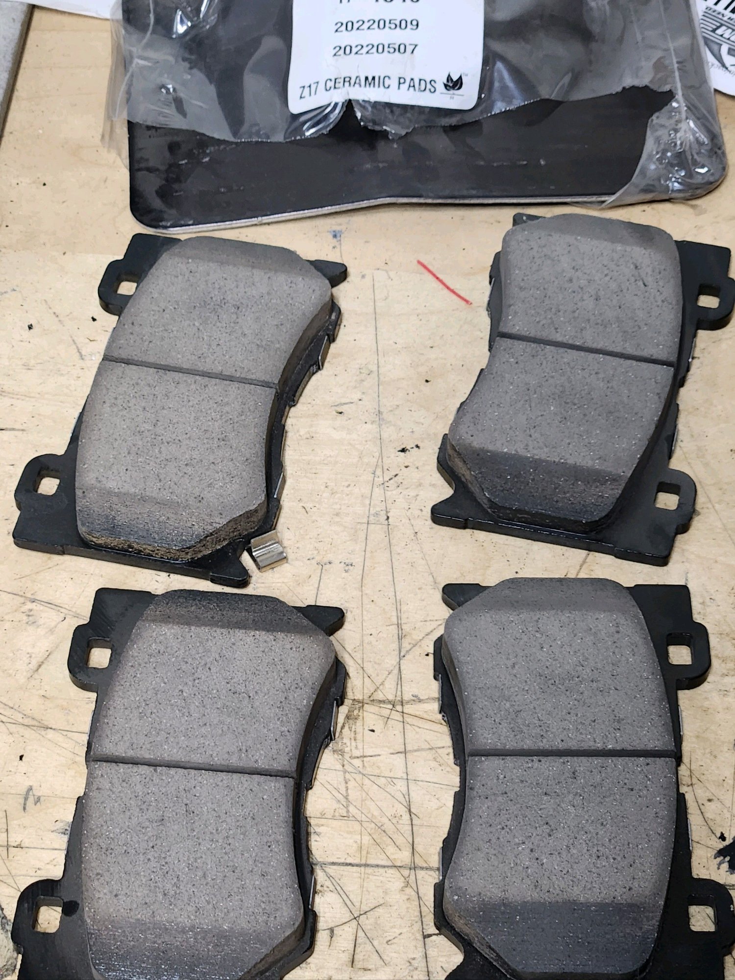

Stop tech shims vs OEM Nissan
Stop tech sanded flat
Stop tech brand new
heat spots from the rotor
Checking for flatness of the spacer
Done

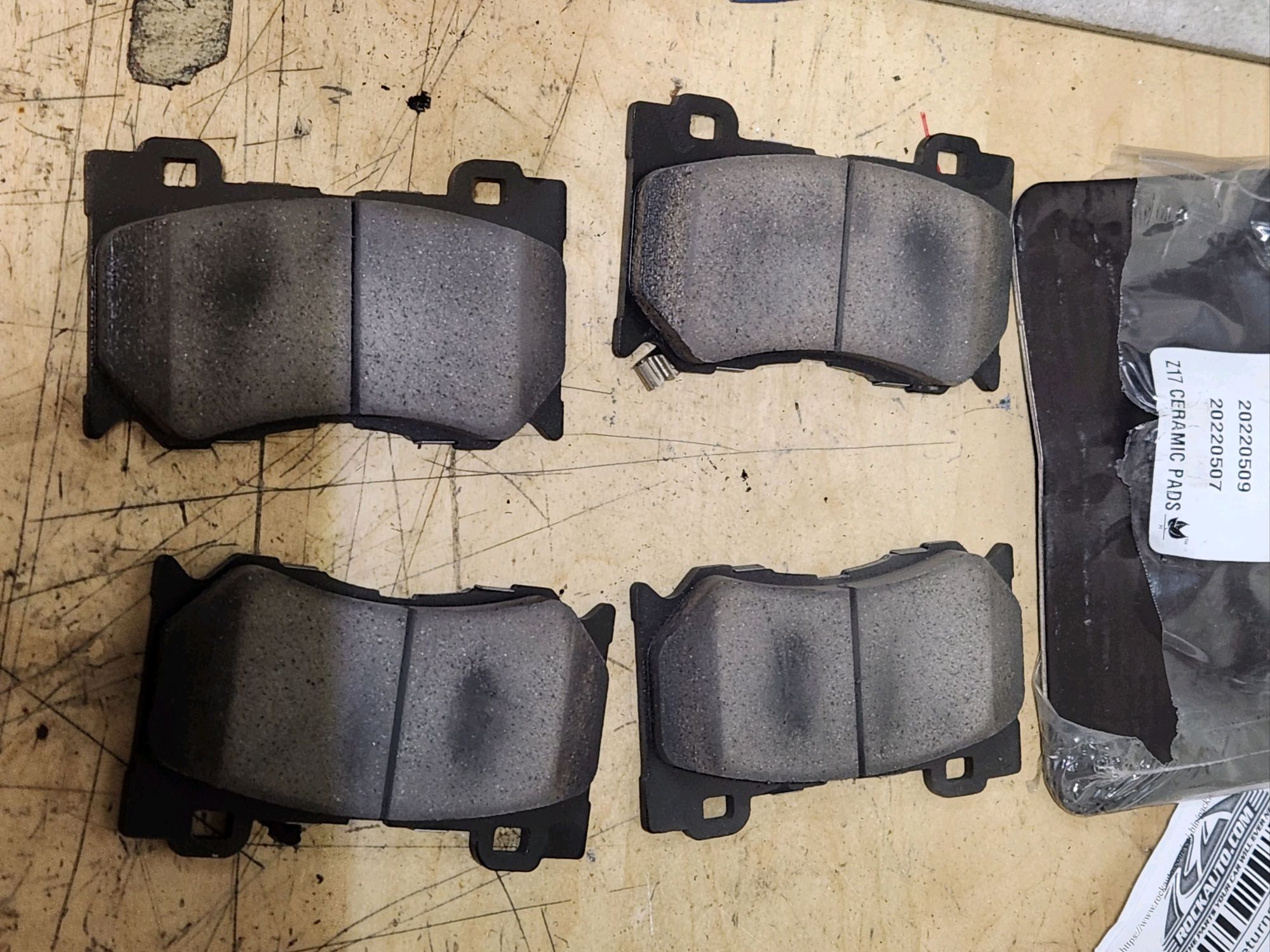

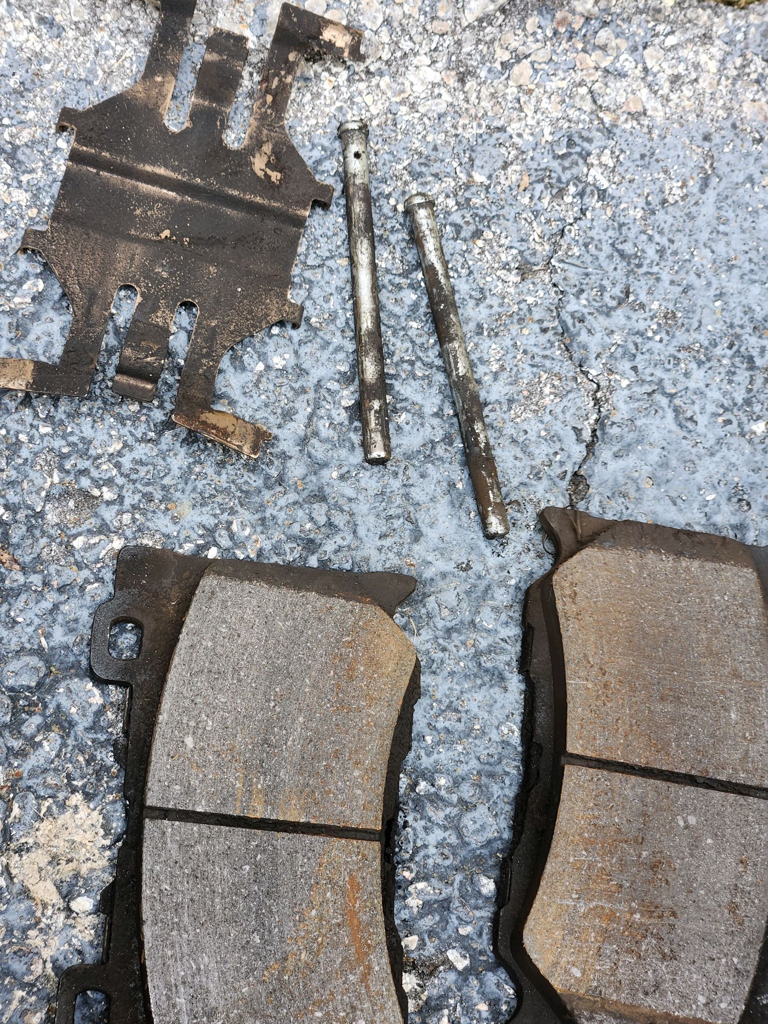

I wanted to show for those doing brakes. If you ever develop noise on your brakes, I seriously suggest the OEM Nissan/Infiniti dual shim setup (only grease the outside not the part that meets the pad).
I also wanted to share the condition of brand new pads, right off the bat I noticed low spots on the flat parts of the new pads ( will lead to premature failures). 2 minutes of flat sanding they were great again.
For those doing brakes on 1 piece calipers, make sure you are cleaning every bit of greasy brake dust in the sliding canals of the caliper, many times grime will collect and pad wont sit properly.
Safe to say I went above and beyond what I could to eliminate issues.

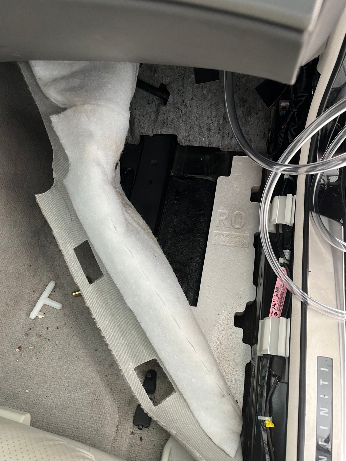

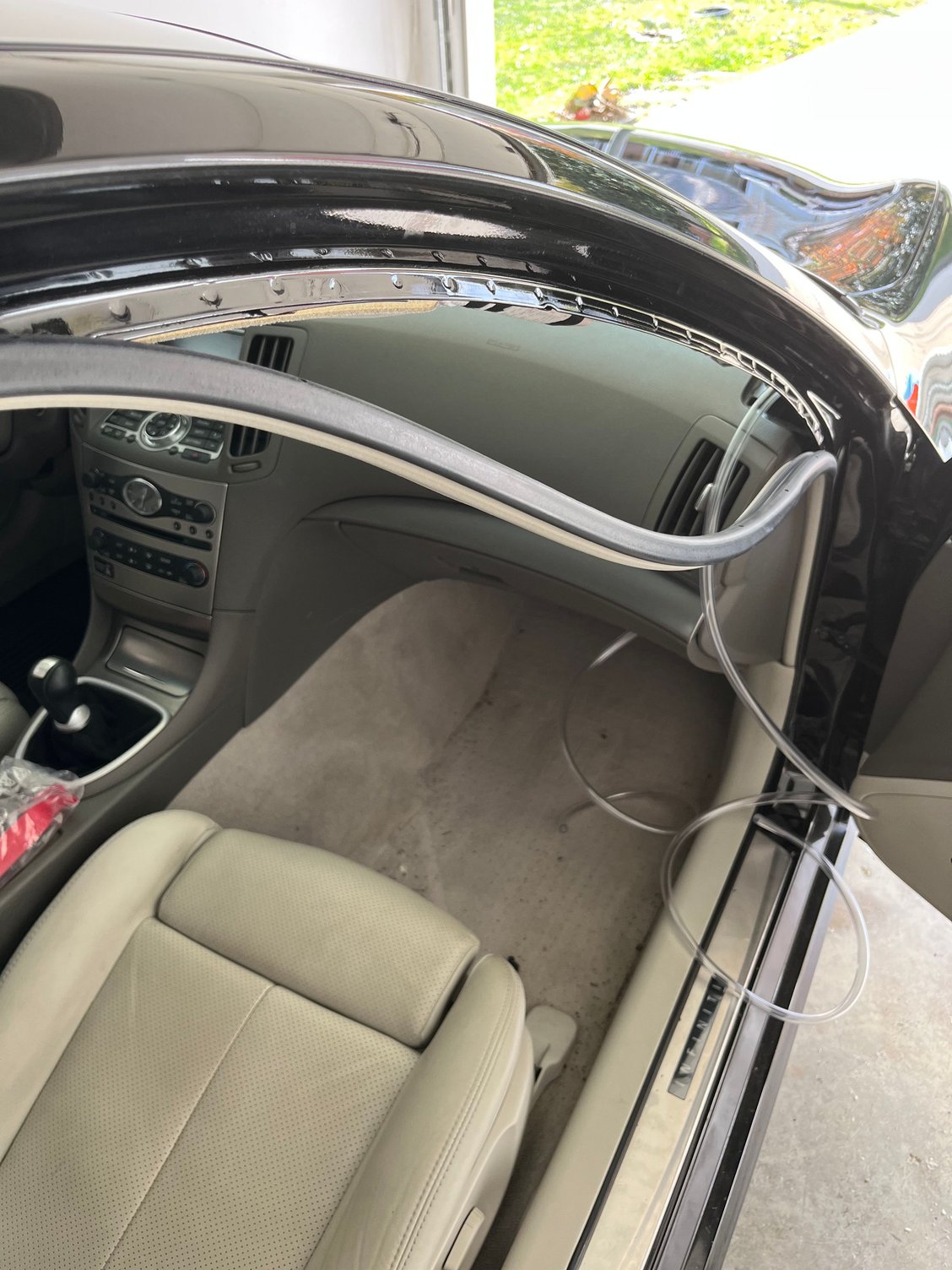

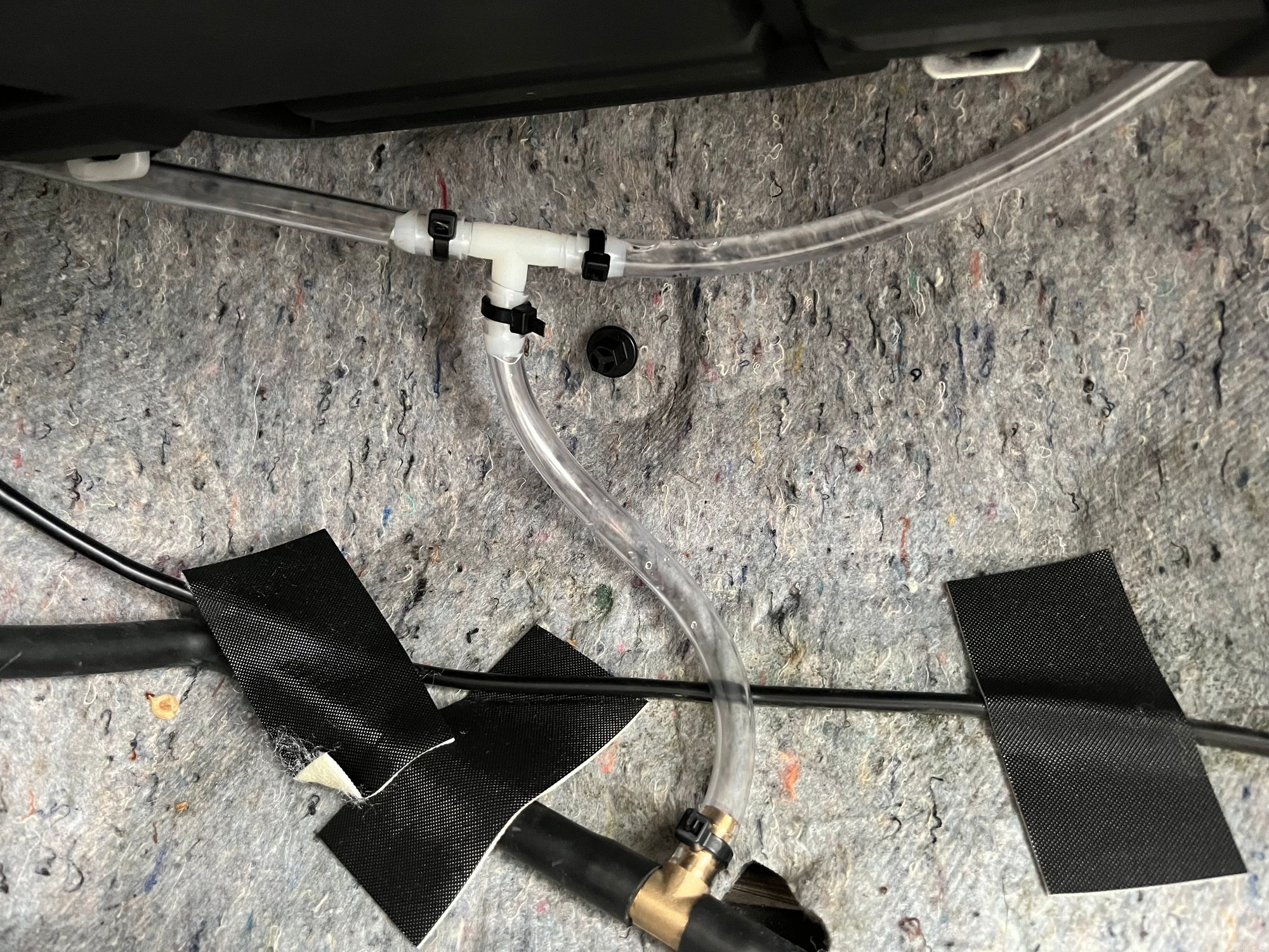

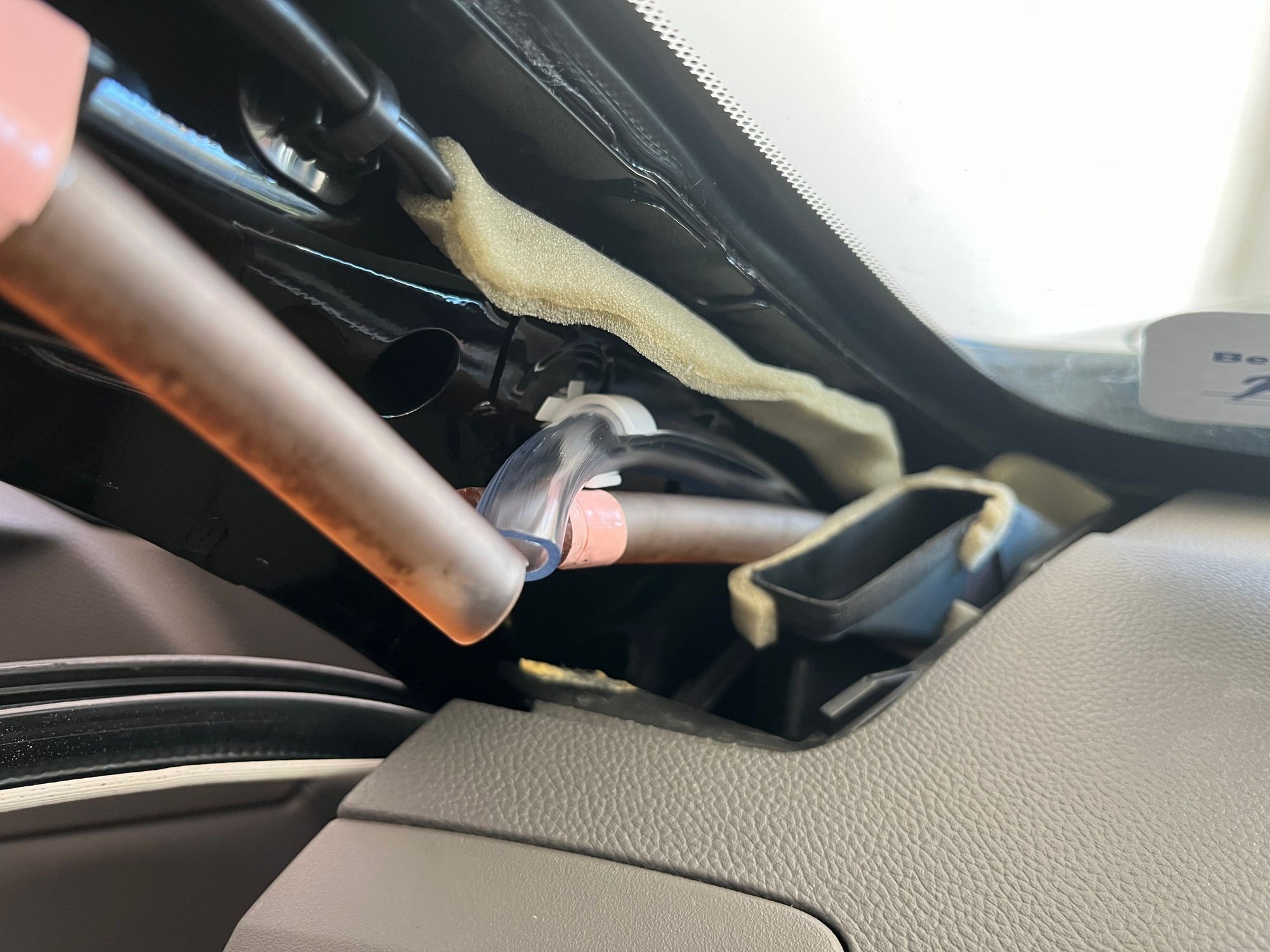

Knocked out the sunroof drain reroute project this weekend, more or less went on without a hitch. Huge thanks to the forum here, wouldn’t have been able to diagnose the leaky footwell issue or build the confidence to take on the project myself (and esp to ILM-NC-G37S and SkysG37 for helping me work up the courage).
I’ll admit, having the car water-tight again has renewed my interest in keeping the car longer (and likely adding some more mods by year’s end). Have test driven some B8.5 S4s and F30s over the last few months, almost certain to move on from the G. But then I realized the fact that with these Euro sport sedans of a certain age, I’m likely buying someone else’s problems too. And finding a low-miles, single-owner, stick-shift version of these cars is becoming very tough. Bought my G new as kind of a milestone achievement (first official promotion, back when I was a field engineer for an energy company). And since then, the car and I have been thru thick and thin together, and it’s been very good to me overall. So plenty of sentimental value and piece of mind baked into this car, was easy to forget when I was getting water all over my footwells. But now that should no longer be a distraction
A additional notes from my experience:
-you might surprise yourself that you’re still pretty nimble. Have been feeling my age these last few years, but had no problem throwing myself deep underneath the dash. Maybe the car was throwing me some good energy to help out
-need a 1/2” x 3/8” x 1/2” Tee to splice into the A/C condensation drain tube. Some instructions call for two 3/8” tees, but the A/C tube was 1/2” dia in my car
-Ive never once did any work on the interior of my car, and this took me about 2-hours overall, taking my time and rewatching several videos at each step of the project. I could do if all over again in 30 min now that I have the feel for removing interior trim components. It was also a beautiful day so had some beer breaks
-Rubber gloves when handling the A pillars, that tan cloth can easily stain / tough to get those out
-Green clip that attaches to A pillar, twisting this 90 degrees with needle nose pliers to detach the A pillar cover seemed way easier than prying the entire clip from the A pillar
-If you’ve had your Windshield replaced, you might need to cut at some excess adhesive that has glued the A pillar in place (only had this issue on one side, maybe the new windshield install got a little sloppy)
-No need to remove the Glove box , just need to remove the plastic under tray; to do so, three easy pops on the front, then slide out the hooks at the back. Once you have the tubing snaked down on the passenger side, I suggest putting the tray back on at that point so you know where that tube will land when everything is put back together
-Reassembly is pretty straight forward, everything pretty much snaps back into place
