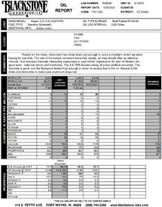

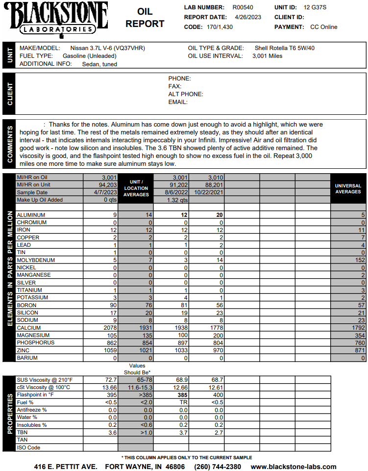

Another oil report:

Originally Posted by AnotherVQ
Another oil report:
Nice report! I think after another clean one you can easily do 5k OCI with T6.
What was the oil you used before?
Old Apr 26, 2023 | 07:18 PM
  #9375
AnotherVQ's Avatar
AnotherVQ
Joined: Nov 2019
Posts: 718
Likes: 94
From: Arkansas
Why 5k specifically?
All tests in screenshot are same oil.
