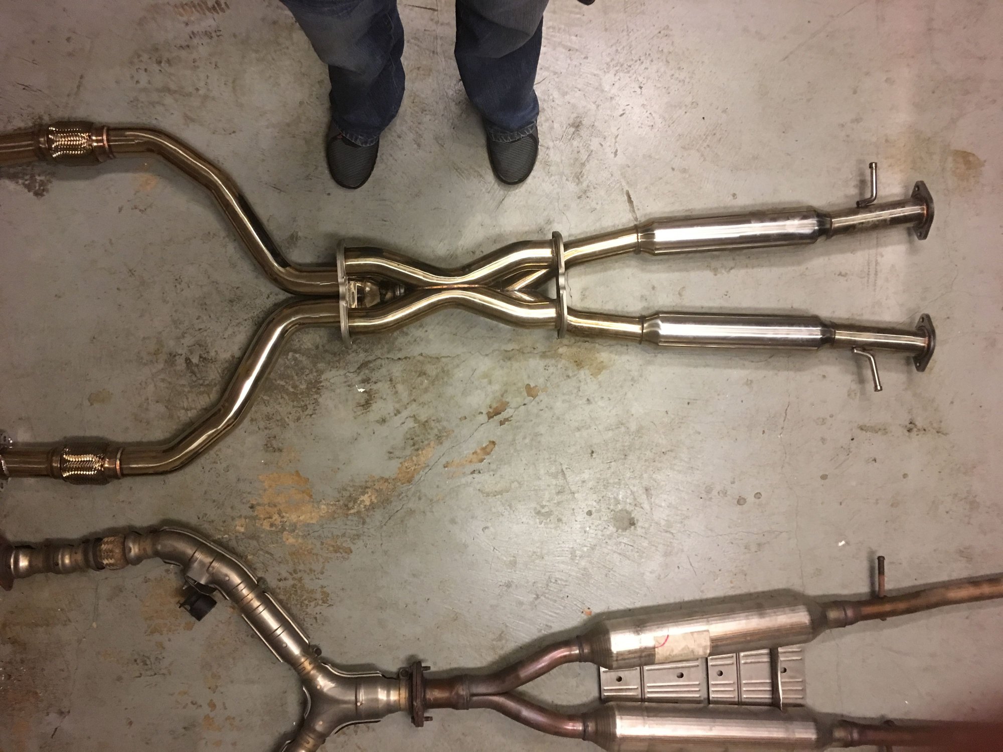

NOOOOO! I turned my Sweet G into a ricer!
Mainly to ZahyMatar, Rochester, and MaQG37...
I had good luck with my first G, a '10 base model. Put HFCs on her (Berk, I believe), then an Invidia Q300 catback. It sounds soooo good.
I had too much confidence and ignorance on my '13 G37xS. Bought Kinetix HFCs to save $. Saw the Megan headers, they were cheap, though I had an idea the stock headers are already engineered for performance. My shop put those two on for $800. Seemed as quiet as before install. Didn't notice a power increase. Then I reflashed the ECU with my Bully Dog. (There's no way that didn't boost the WHP. I'll eventually get dynos with and without the flashing and post the results. When I'm all done with changes I'm getting a tuner to tune her. That's when I'll settle the argument about whether a Bully Dog boosts HP.)
Then I installed the Manzo Y-back and the Megan Y-pipe (because it's bigger than the stock pipe.) It took me about 3 hours on a cold garage floor because my tools are everywhere and I haven't done an exhaust uninstall/install, though it is very simple. Fitment not bad. Put all the bolts in loose after hanging mid pipe, hung the mufflers, finished putting bolts in finger tight, then randomly snugged them all up. The tips are well centered without doing anything to center them.
Started her up. OMG! Heartbreakingly AWFUL sound! LOUD! Raspy and high-pitched. And I hear buzzing and feel vibration everywhere. And, when I walk around the car, the exhaust sound is loudest when I'm standing next to the car, equally on both sides.
Driving its embarrassing. I wanted to hear the engine so as to enjoy my paddle shifters... but having an ugly exhaust sound isn't fun. No Fahrvergnügen for me.
I've read up some... could be the changes in caliber from the various components. I've thought about testing this theory by swapping the Megan Y-pipe out with the stock. That's a lot of work and I don't want the smaller stock Y-pipe in my final system.
Then next notion I got was having a shop remove the Manzo resonators and having either Vibrant resonators or Solo Performance MR or QR resonators welded in their place.
I want the rasp gone, the volume down, and a MUCH deeper tone.
Men, what's the quickest route?

Old Dec 22, 2016 | 09:52 PM
  #290
ZahyMatar's Avatar
ZahyMatar
Posts: 1,705
Likes: 341
From: Franklin Park, NJ
Frank
PS:
I want to install a supercharger within the next few months. I assume it will take the place of the intake; in which case, I'm less interested in the Motordyne M370 modified intake, even though it's low cost after the core charge is taken out. I'm not doing anything until her voice is restored. It's no fun driving her with her current note...
Replace the Megan Y-pipe with a Magnaflow Resonated X-pipe... That should help

It would completely replace the Y pipe, it would have to be welded on by an exhaust shop. Is the Manzo 2.5 or 2.25in?
Old Dec 23, 2016 | 01:40 AM
  #293
FrankRoshi's Avatar
FrankRoshi
Joined: Sep 2016
Posts: 39
From: Longview, Texas
It's the 2.25"
Why do you ask?

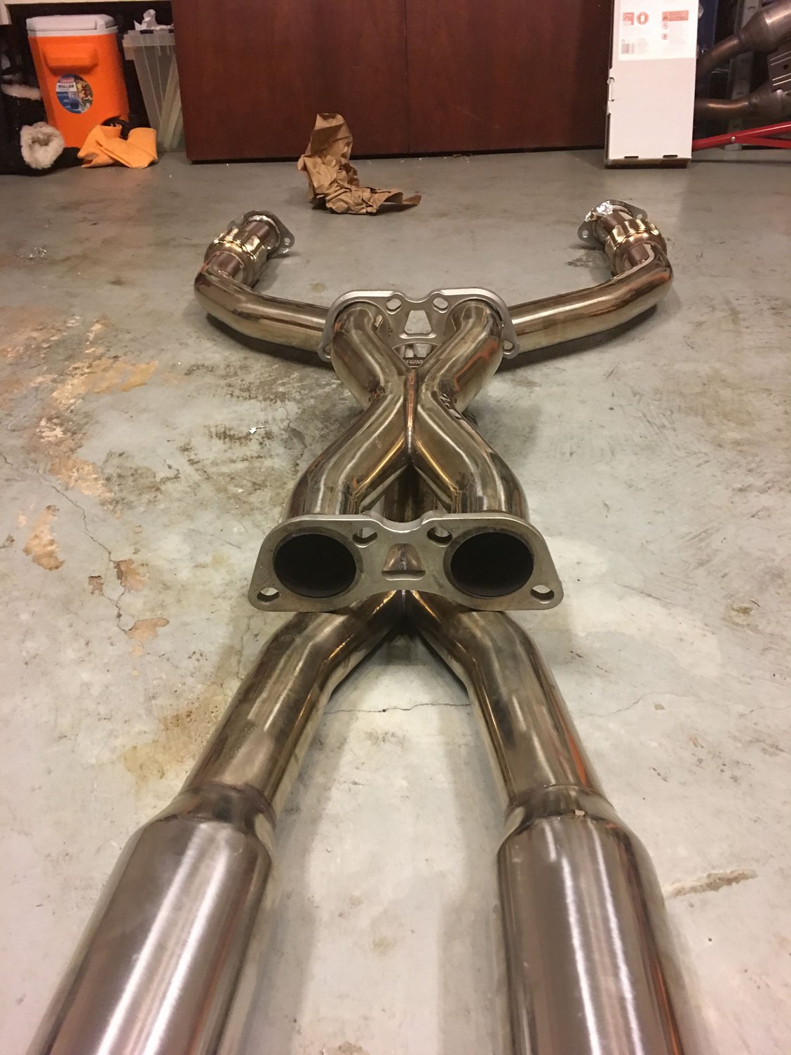

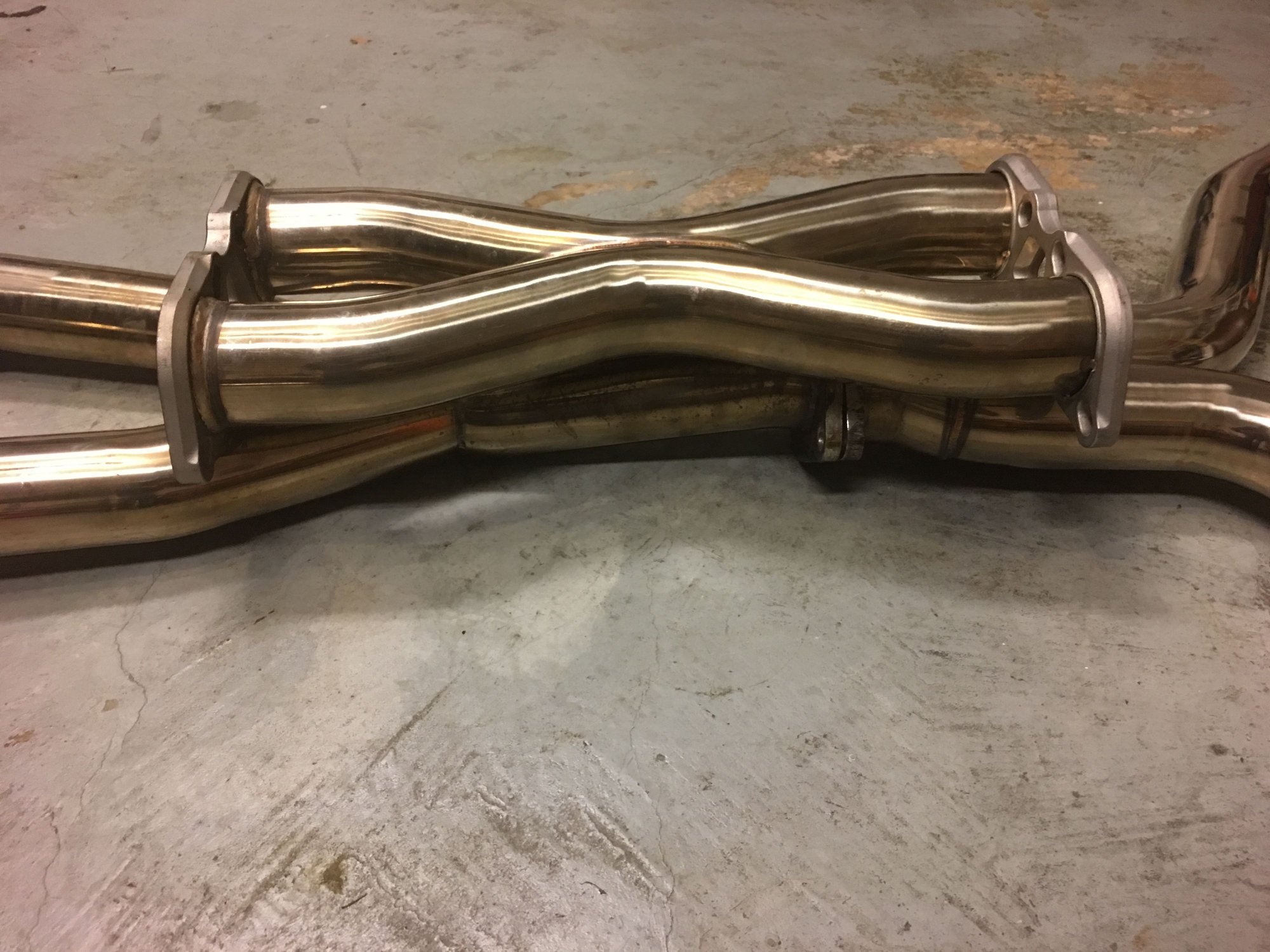

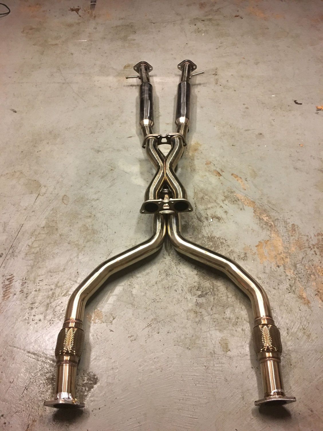

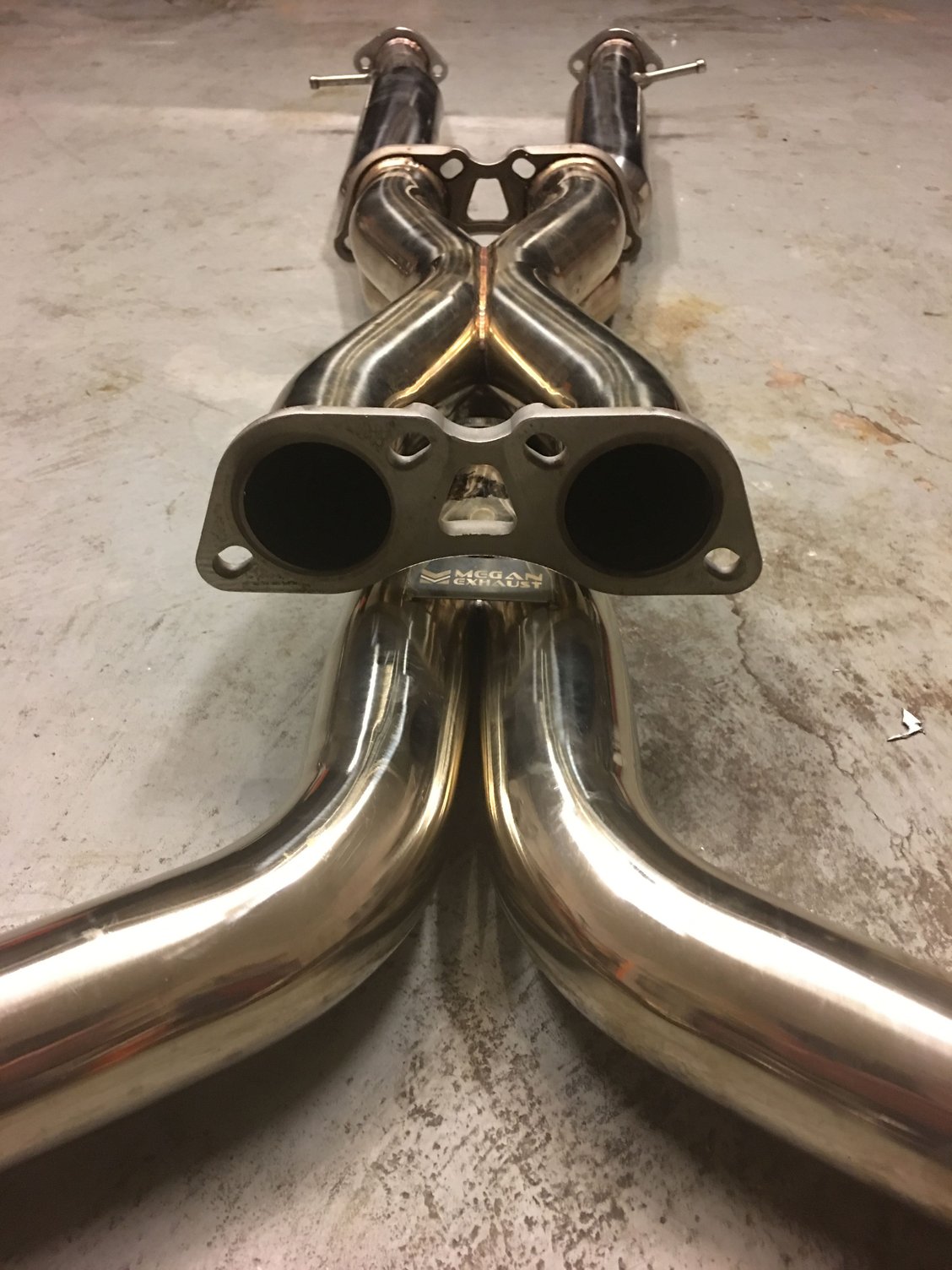

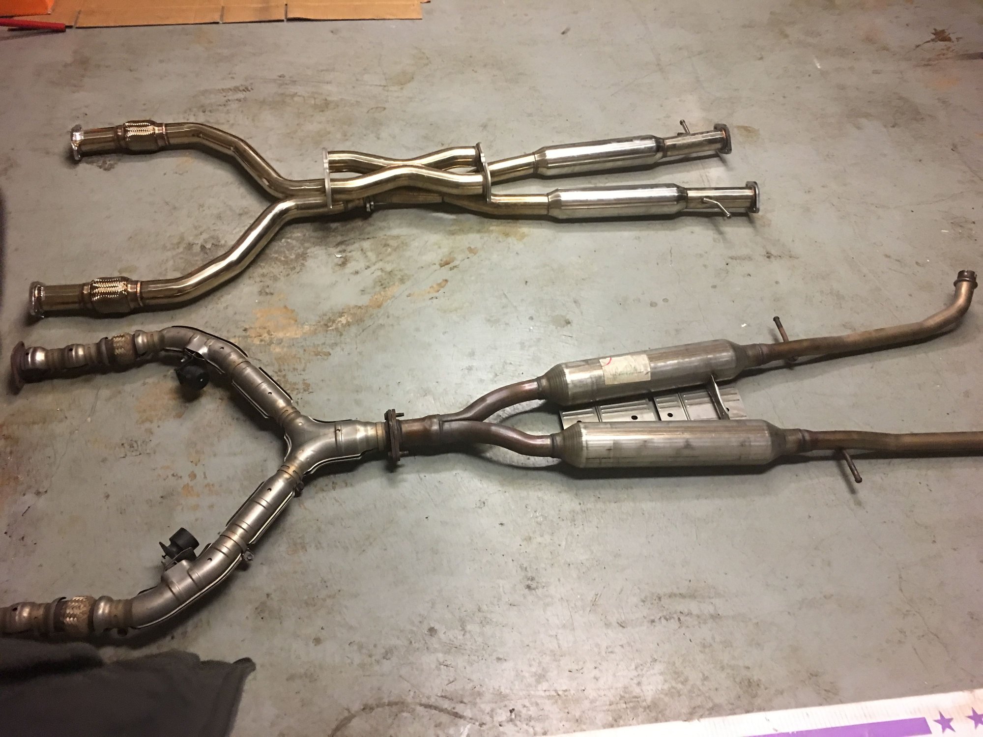

One more potentially bad custom idea...
Monstrosity caliber changes:
Megan header outlet: 2 3/8"
Kinetix HFC Inlet: 2 1/8"
Kinetix HFC outlet: 2 1/8"
Megan Y-pipe inlet: 2 1/2"
Megan Y-pipe outlet: 3"
Manzo inlet: 2 1/2"
Thank you, Men, for your answers. I put the stock Y-pipe back on, and it sounds better. It doesn't sound good. It isn't deep enough and it sounds like the car is powered by compressed air, not hissing, but buzzing..... I can't hear the individual cylinders firing... it's more of a buzzing propelling and when I back off the throttle there's no burble. Yuck. It's like a bad musical instrument.
So, I got under the car and held up the bad X-pipe from my Invidia Q300 over the Megan Y-pipe and Manzo Y-back connection... it looked like it wouldn't take much for a shop to cut off the end of the Megan Y-pipe and the beginning of the Manzo Y-back, weld the Q300 X-pipe in place splicing the 2 systems, eliminating a bunch of caliber changes, and connecting the two banks ala Q300. It'll be a MeganInvidiaManzo Frankiestein custom exhaust system. It may rock to shuddering eargasm or it may sound like crap. If it does, I scrap it and buy another complete Invidia system and install her myself.
Ill let let you guys know. I'll put up a clip of the current system (stock Y-pipe/Manzo back). I forgot to do a vid of the Megan/Manzo system. Then the Megan/Invidia/Manzo abomination.
Frankie Stein

The Q300 is much quieter than I thought....
bought an Invidia Q300 CBE and it installed easily on my '13 xS. Quietish. Deep. Non-ricer sound.
Im going to make the Frankenstein MeganVidiaManzo system. Look at the pics before you scoff...
it it just may be the deep, rich, exotic free flowing sound I haven't gotten yet...
