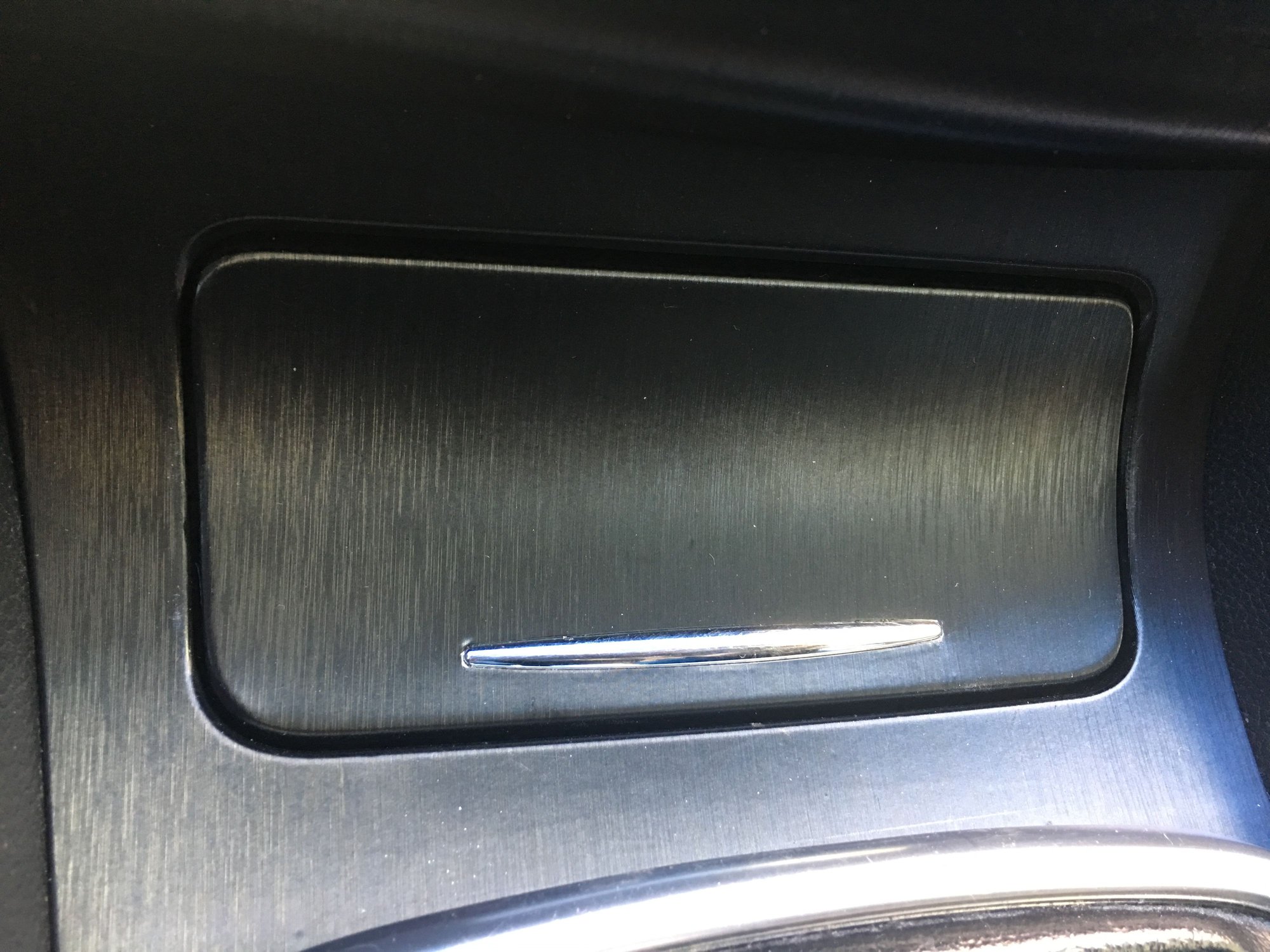

I wrapped my ashtray but I didn't even attempt to take that lid off, it's a pita but definitely doable without taking the cover off.
Heating and stretching the vinyl before installing it on curved edges will help it conform better. After applying the stretched vinyl, heating it will shrink it back and the stress from stretching it won't be on the edges.
Hope this helps a bit even though I didn't really answer your question

Thanks Bocian and Kimmspeed... I ended up wrapping the pieces, but did not remove the tray either. It looks fine when closed, but when I open the tray, the edges are rough etc... So will try again now that I see your pic Bocian , that looks good, so will try some heat on this go round since I won't be taking it off and have sufficient vinyl for a few more tries , maybe I'll get it right before I run out...
