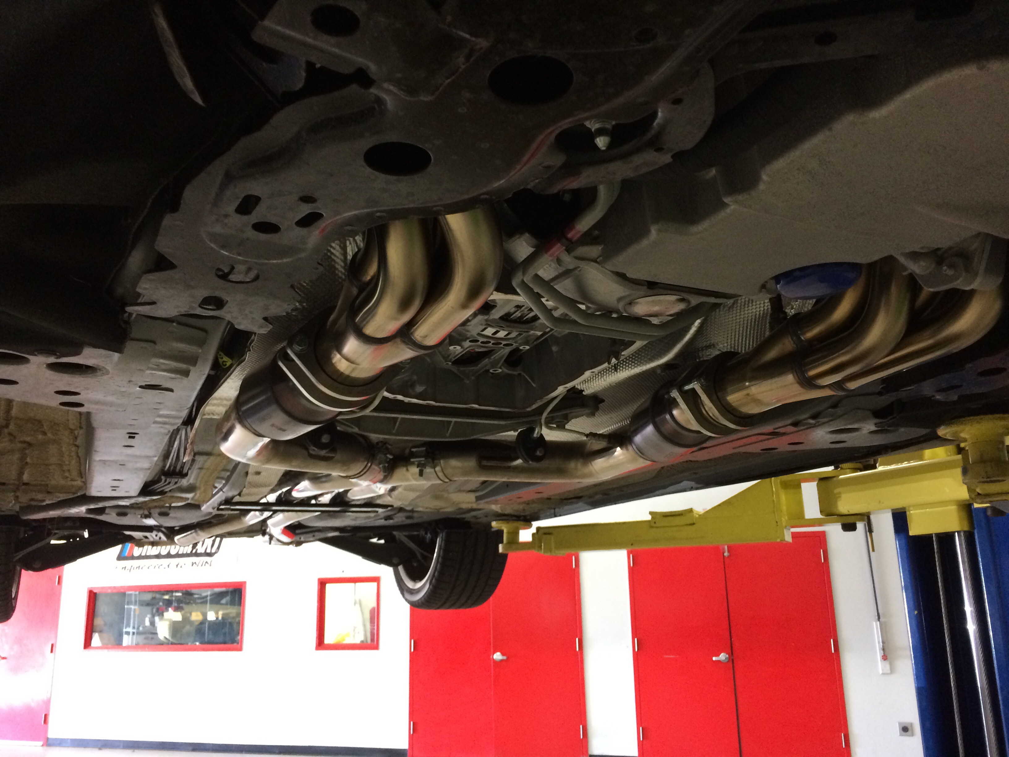

I have done a few more things to the car...
Kooks 1 3/4" Headers and x pipe with green cats:

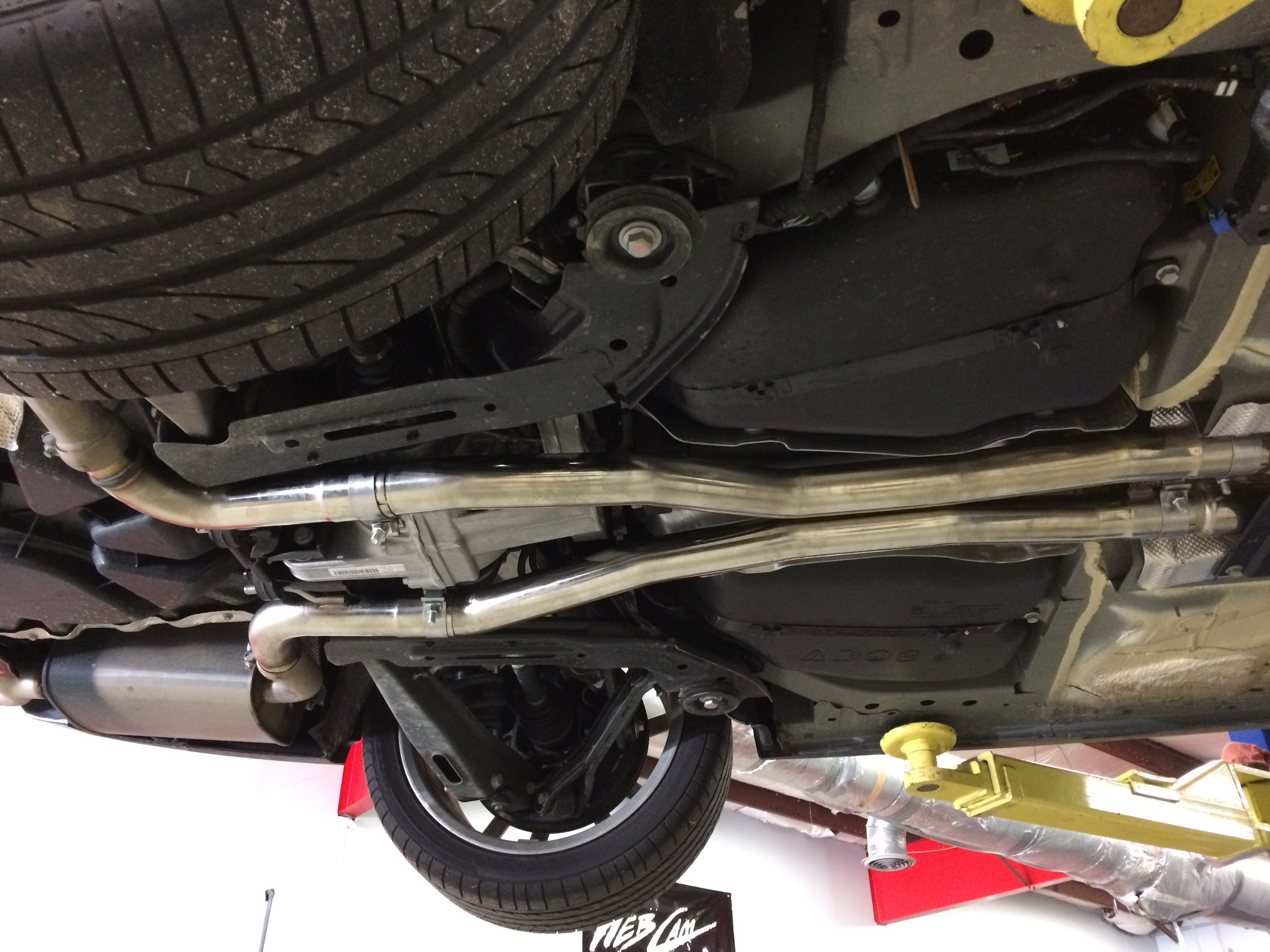

Rear portion:

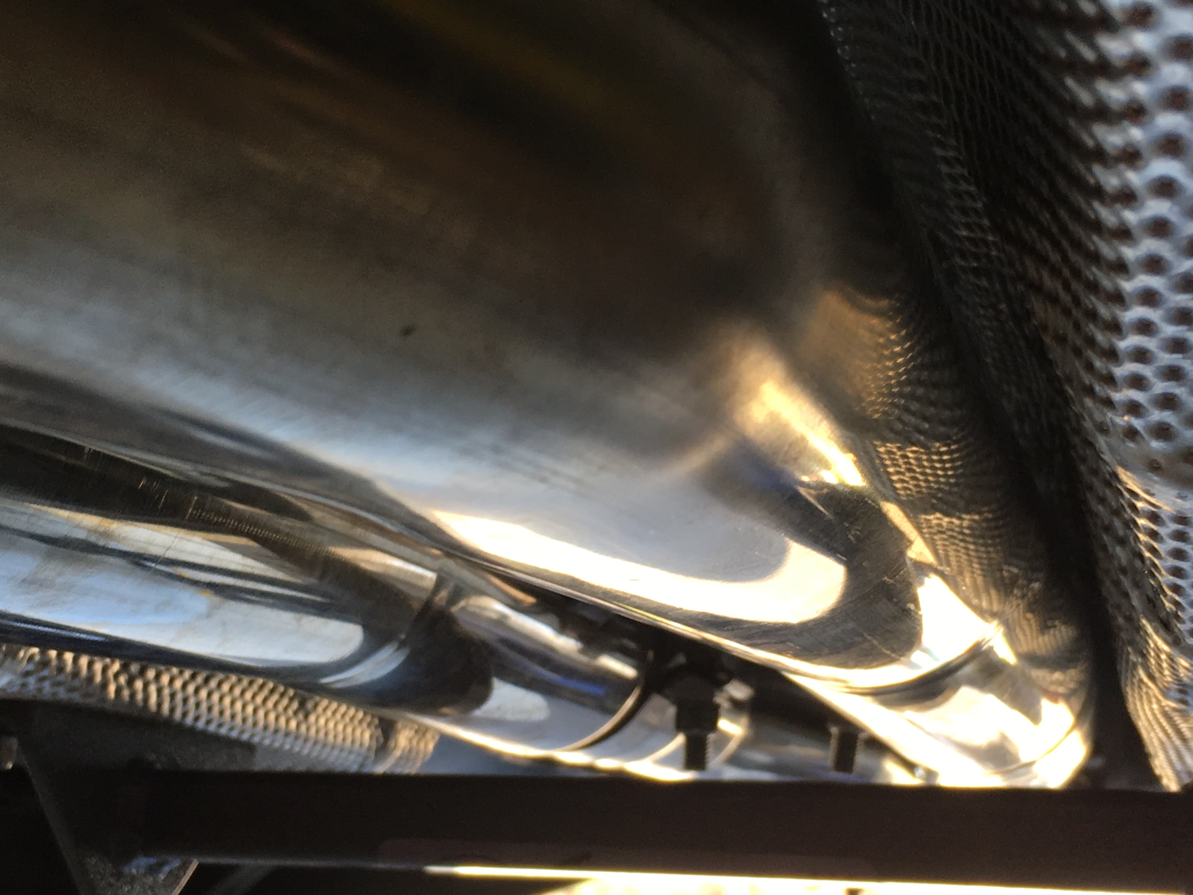

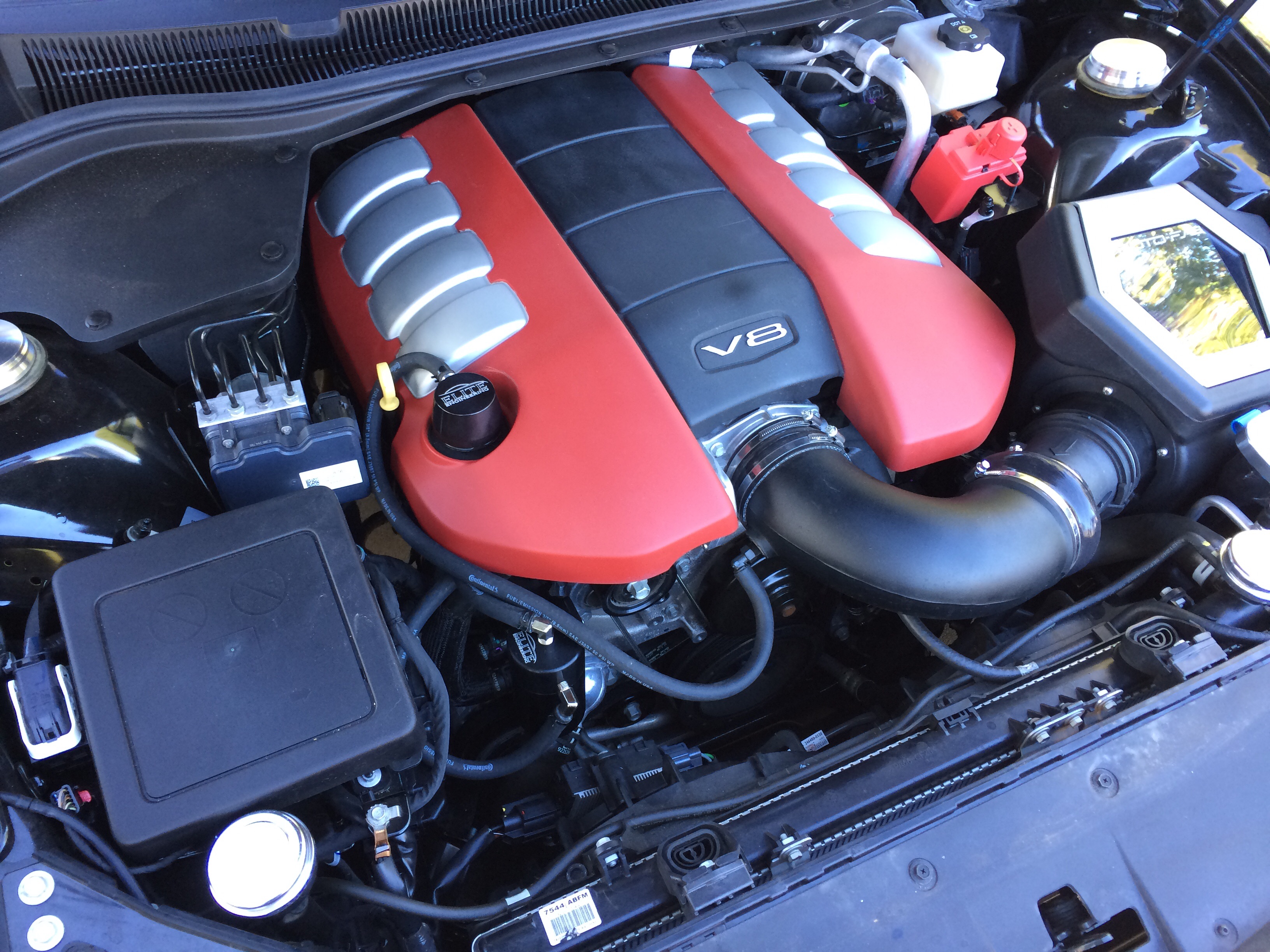

Because the LS3's are known to run a bit dirty, I added an Elite Engineering Catch can along with a EE air/oil separator.

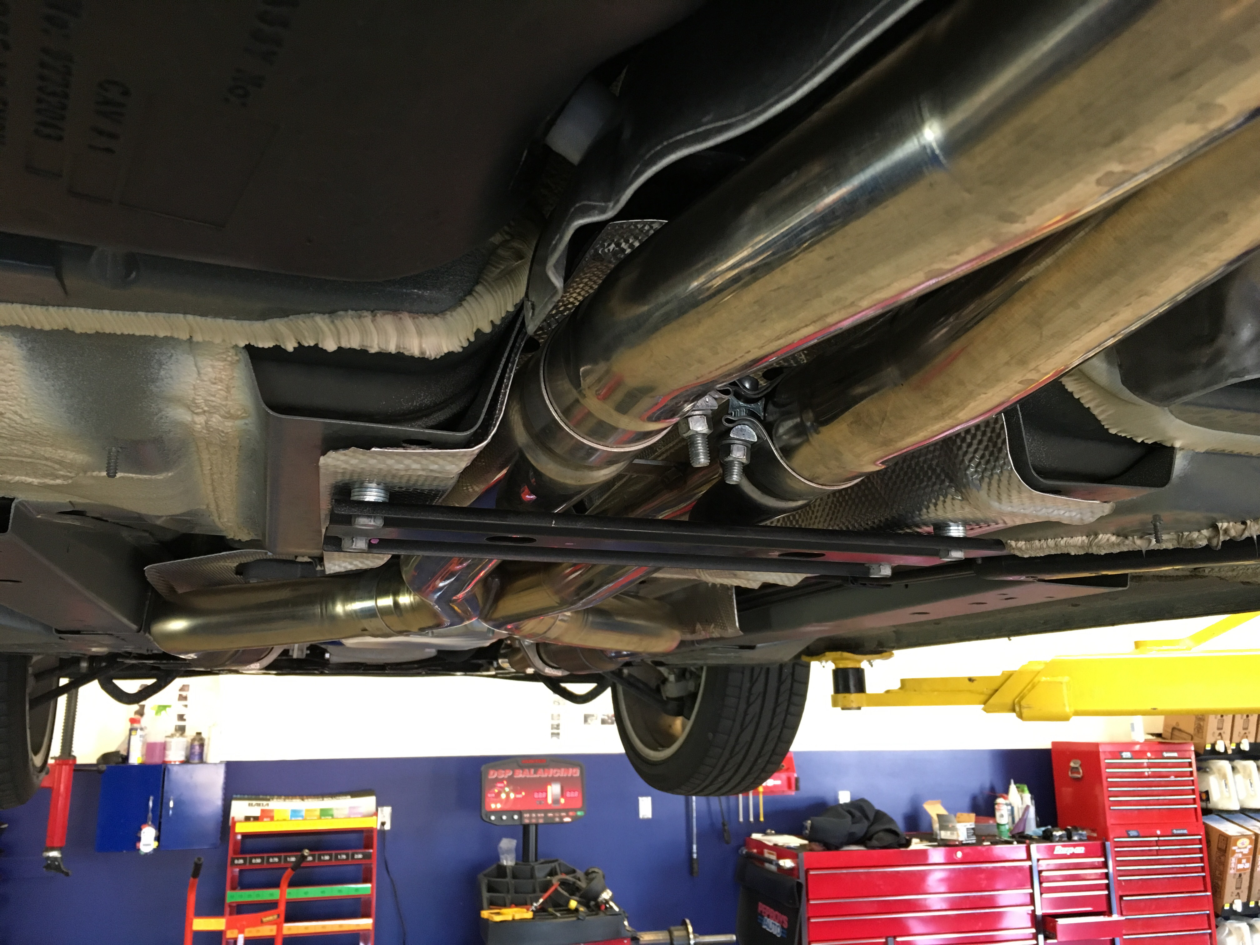

Lastly, because I hate vibrations, I had them extend the tunnel plate with four washers away from the x pipe. It worked for clearance but still rattled. This is what I started with:

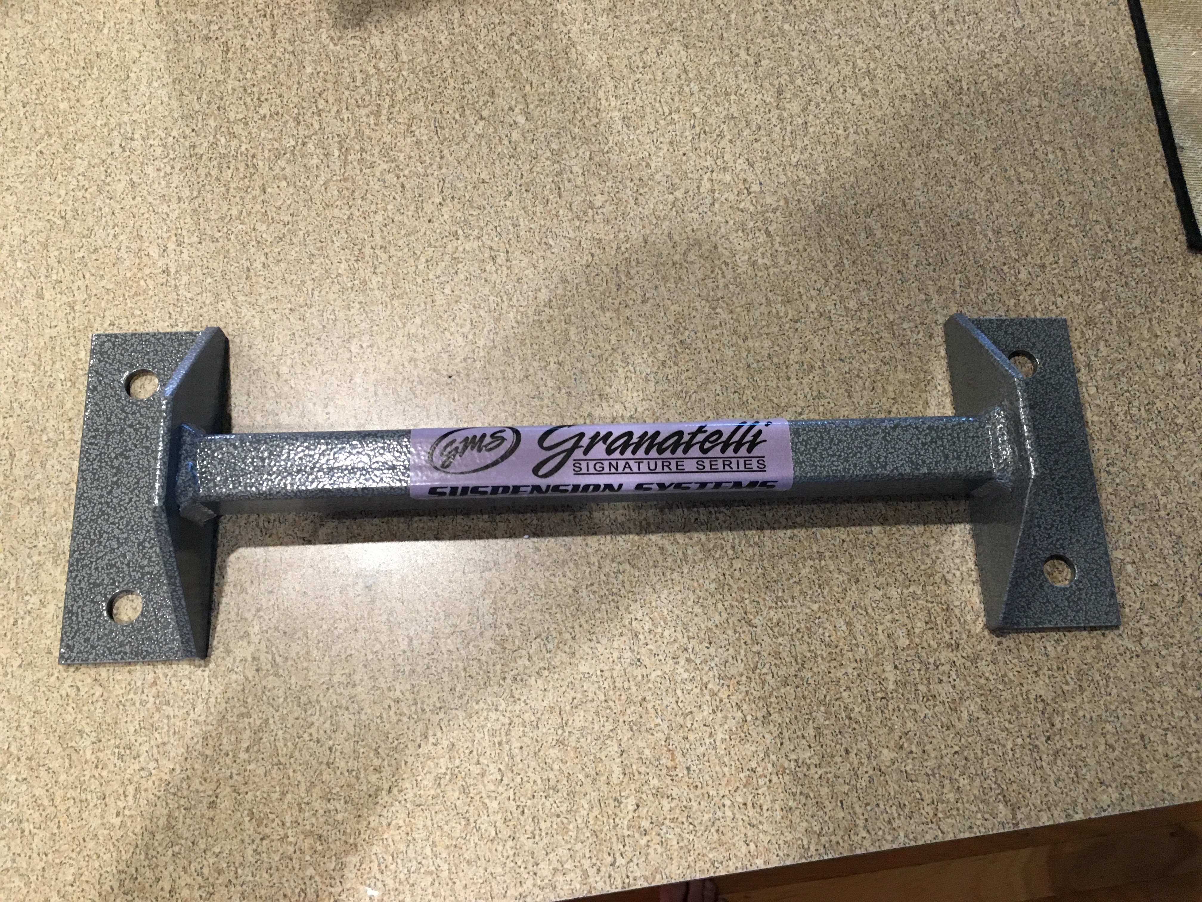

Decided to add a Granatelli G Load Tunnel Brace. Comes with clearance built in. This is the end result.

This is what is look like off the car. I was surprised how much it helped as compared the the stock aluminum plate. Car is more solid.
Cheers.

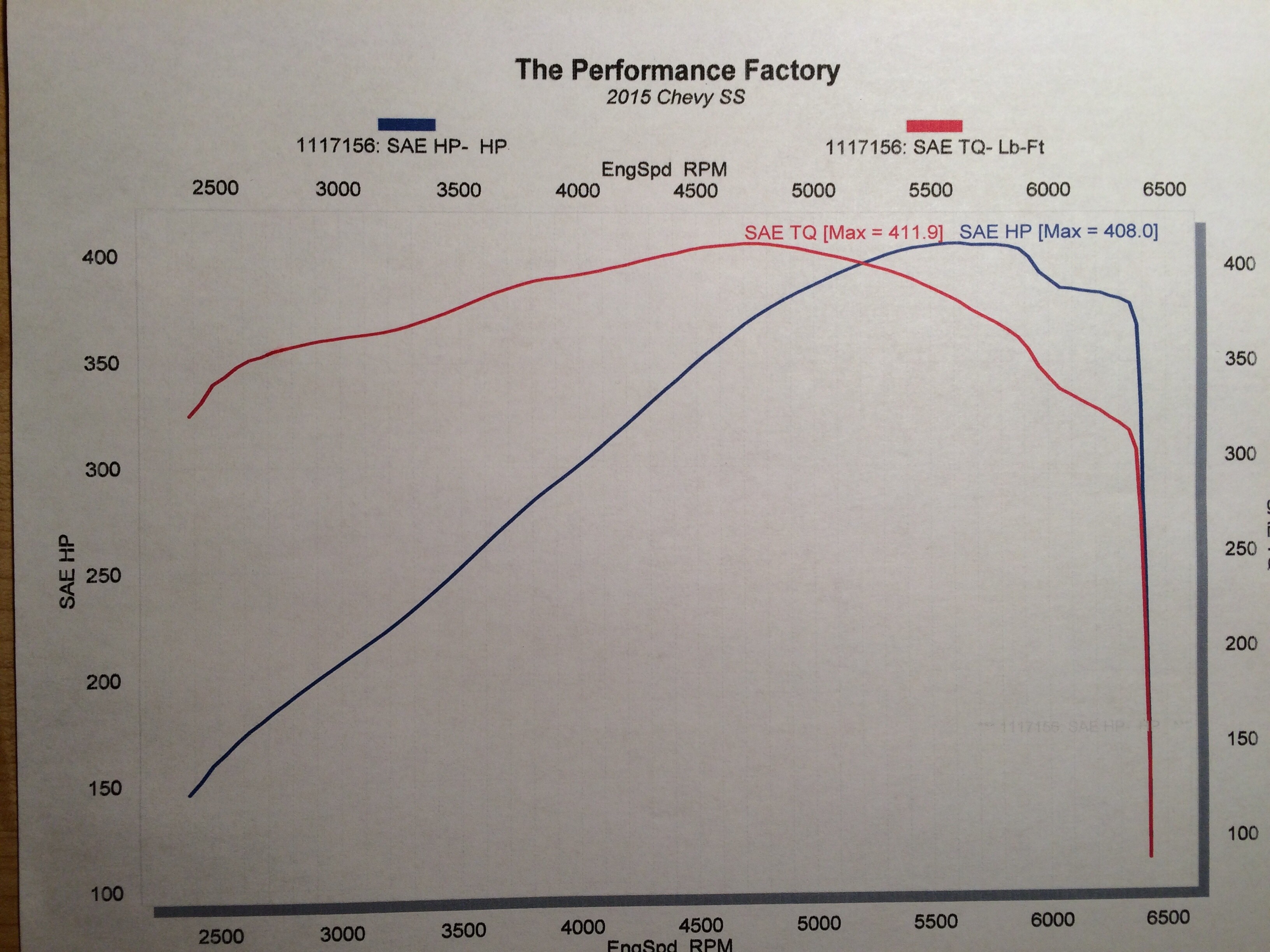

So the results of all the power mods
Stock: 415 HP / 415 TQ
After: 486 HP / 490 TQ
At the wheel numbers at Dyno and tune are below:
