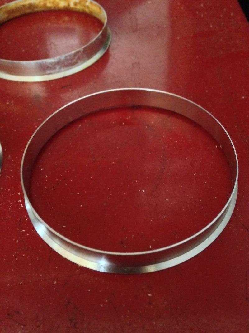

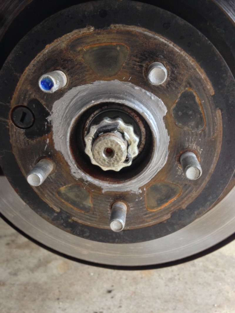

Been getting a slight vibration around 60-65mph since I have installed my new wheels. Alignment done, balance done, tires good, wheels are spot on. Couldn't figure it out until we took a look at the Hub Rings. The wheels have a bore of 67.1, ours are 66.1, so I am going to order better ones. Hopefully that will fix the vibration.

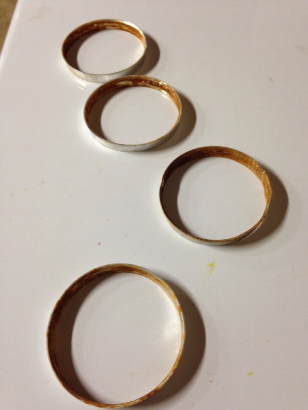

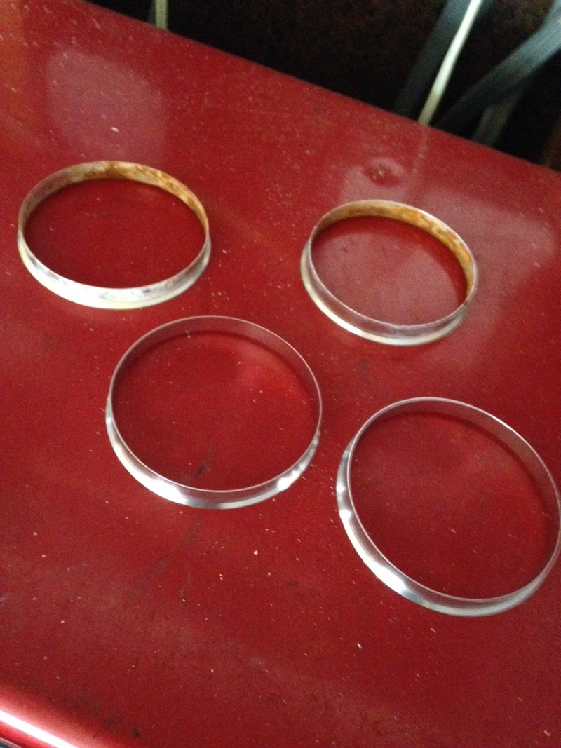

Just got the new hub rings, I was told to clean the rotor and make sure I put the rings on first then the wheels.

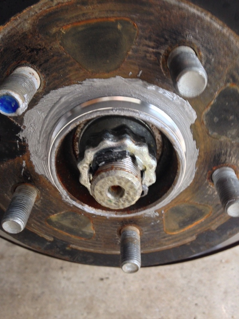

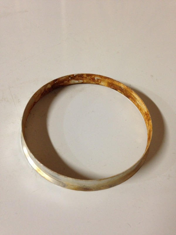

I put some anti seize since rings tends to get stuck

Going to go for a test drive and buy some gas....wish me luck

Given that you're having problems, if I were you, I'd have taken a wire brush to those hubs.

Alrighty, I am glad to say that the vibration has significantly improved. If riding with stock wheels is a 10, I would say its about a 9. Of course with 19 inch wheels and thinner tires, it will never ride as well with stock tires.

You see that blue dot on one of your studs? Its significant. When you mount your wheel, situate the valve stem at that stud, or as close to it as possible. You don't want the blue dot wheel stud at 12:00 and the valve stem at 3:00. Make sense?
