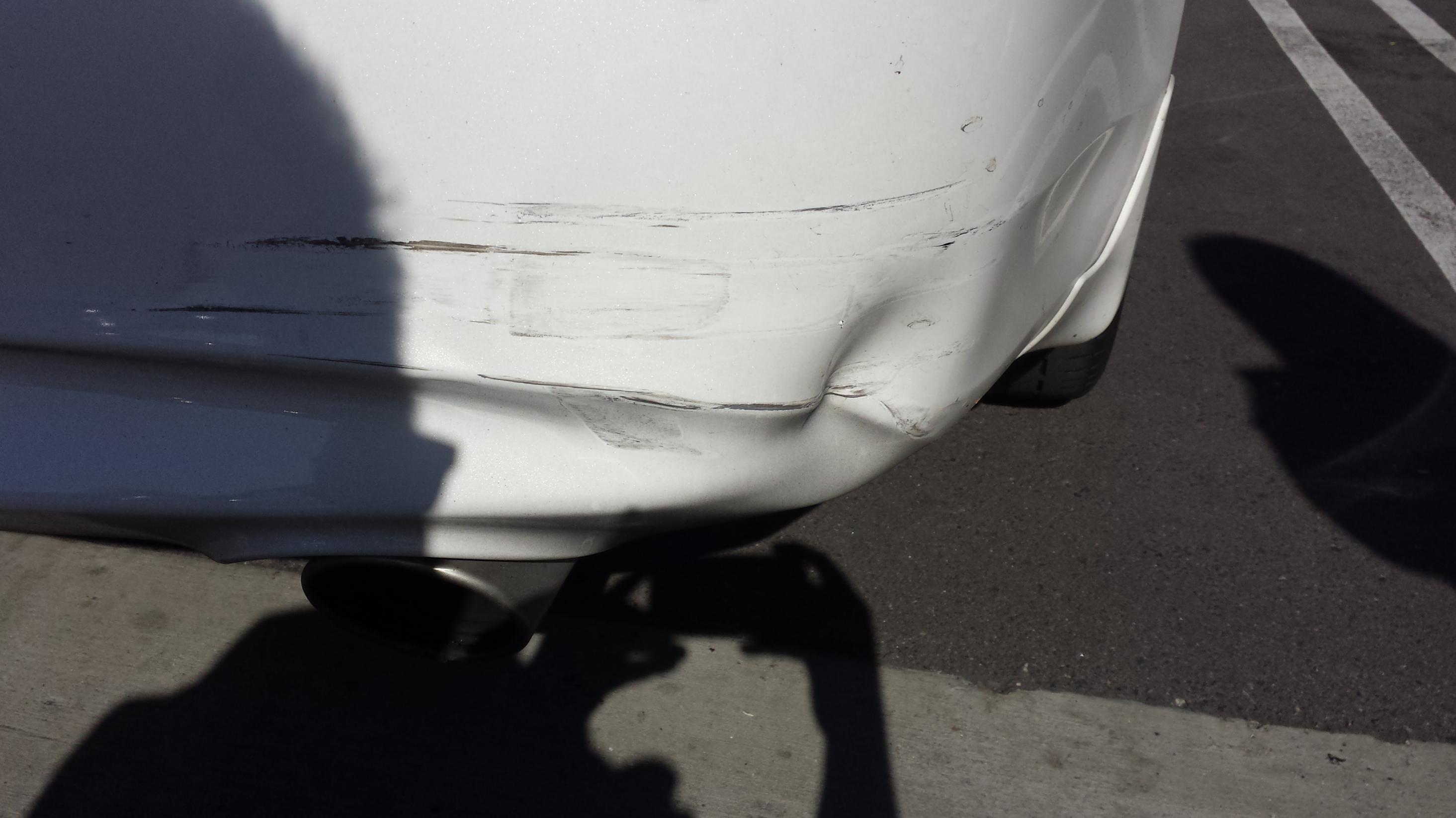

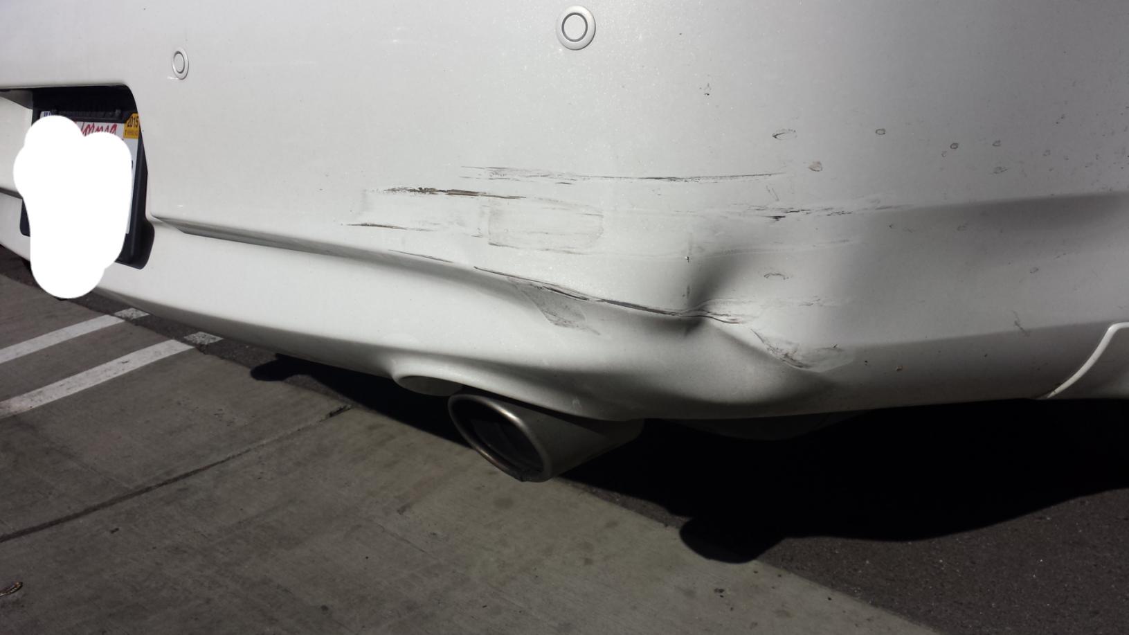

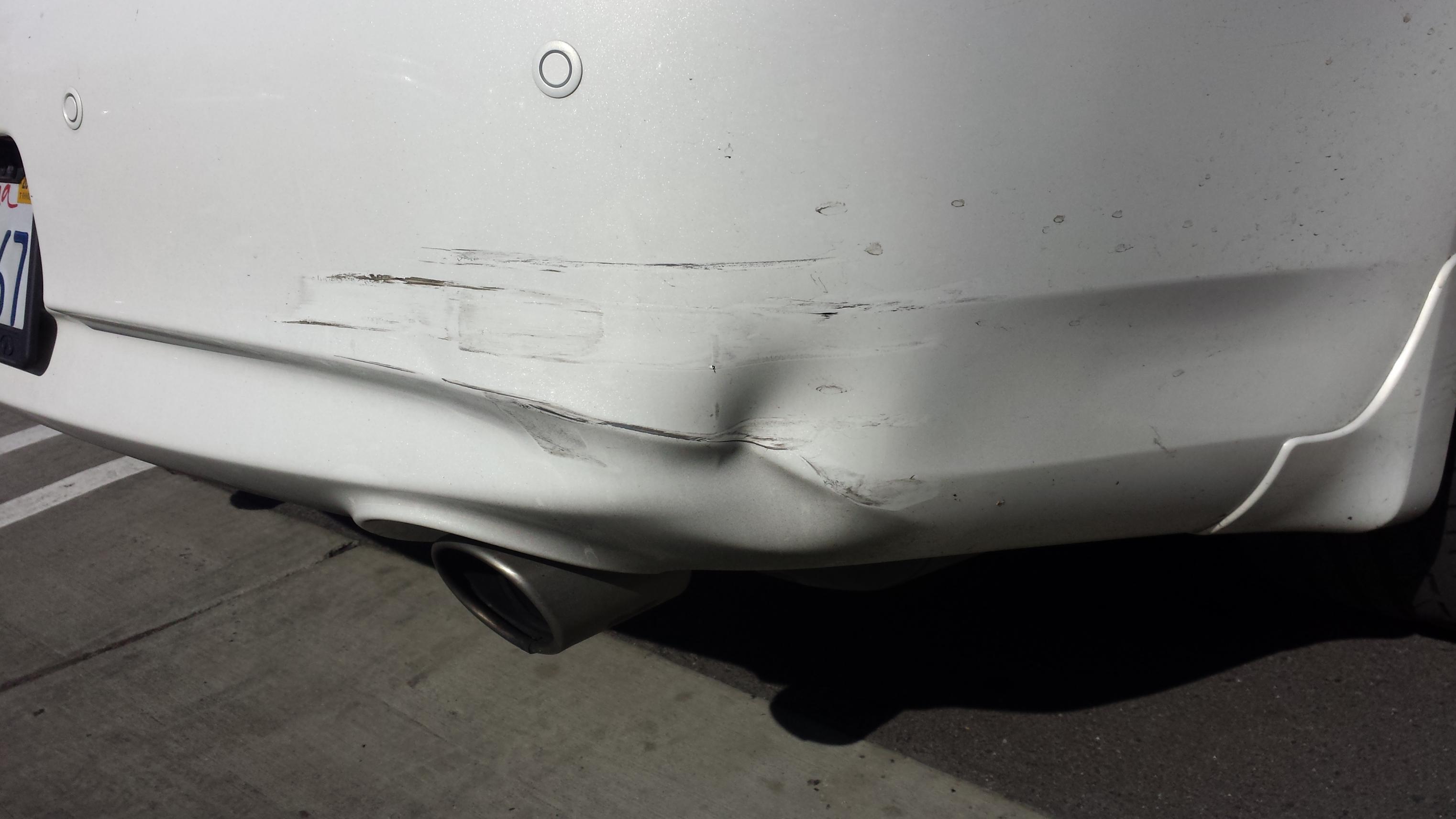

Yup. Hit and run.
I never thought it would happen to me but ya... it happened...
I was visiting my sister at her school to grab lunch today and when we returned to my car afterwards, I noticed something that I never seen before (pic).
Well long story short, now I'm in a dilemma since my car is on lease so whether I should fix the bumper now and buy out the car or I should fix it right before I return the car. (I'm currently 15 months away from my end lease term and I'm at 44,xxx miles (39 months/ 15,000 per year).)
Help.
My heart is never been so broken even when I broke up with my ex's but if I look on the bright side, nobody was hurt and my G runs fine any other way. But one thing for sure, I will not go near my sister's campus. Ever.

Always hurts to get your car messed up, especially a hit & run. Looks like the actual dent should pop out hopefully, then a bit of a smooth, repaint and blend. Shouldn't cost too much if the dent pops out.

Since it's just a lease, I would just heat it with a heat gun and pop that dent back out. Then buff the majority of those marks away (looks like a lot of it is their paint on top of your paint) and I bet you'll be surprised at how inconsequential it may look. Worst case scenario, you're no worse off if you have to go ahead and have it fixed professionally.

Find whomever conned you into leasing and have them pay for the repairs.
Leaving the damage any longer than next weekend wouldn't even be a consideration for me, so I'd follow vqsmile's advice. You might even find the heat gun unnecessary.

I don’t believe any DIY effort would get past the end-of-lease inspection. That bumper needs to be replaced. Having had mine replaced a few years ago it should cost around $800-$900 at a good body shop.

I've had a similar dent my G35 coupe years back. It was a hot day in socal, so I just reached from behind and pushed the dent out. Used some rubbing compound and a little bit of elbow grease, then a nice wax, and you wouldn't even knew it was there.

Ouch! I would cry if that were to happen to my car. But as above a DIY wouldn't past a lease inspection so I would cut my losses and have a reputable shop repair it. Sorry about your car!

That Stinks.
But like some have said you can easily clean a lot of that up yourself.
Also, a body shop maybe be able to do a bit better job with polish and a buffer for about $100 to $150.
I had something similar but my car is red.
However from what I see you may need some repainting. Luckily its low and touch ups might conceal it cause your white.

It's a lease, I assume where you live full coverage is mandatory.. .Just have insurance pay to fix it.
If you don't, you're going to have a nice bill at the end of your lease anyway.

Thank you everyone for the advice. So I decided to have a shop to pop out the dent and buff out the paint which will cost me 150 bucks. It won't be a perfect job but that is the best I can do as of now.

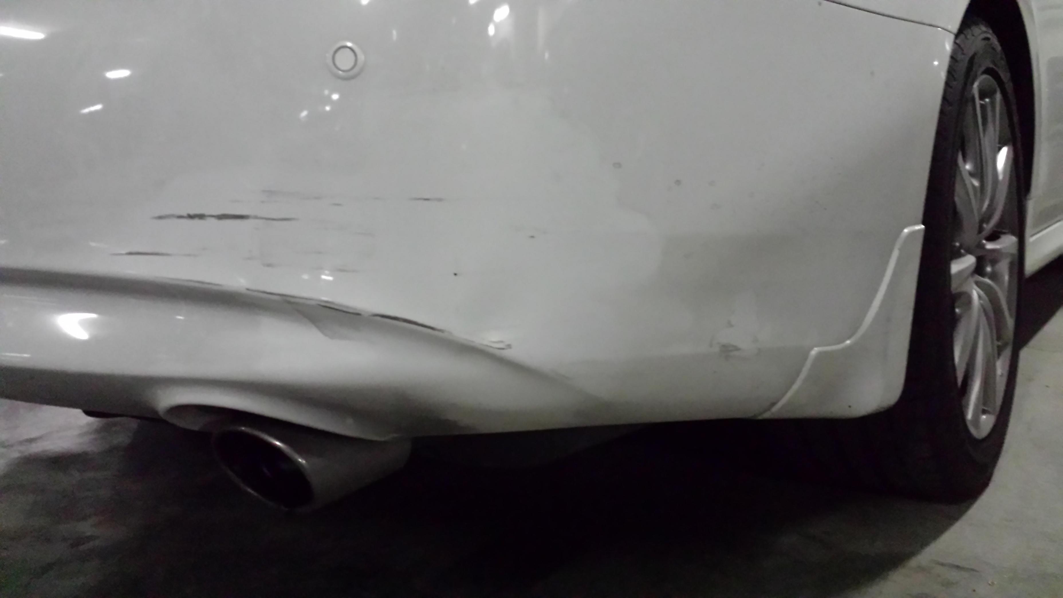

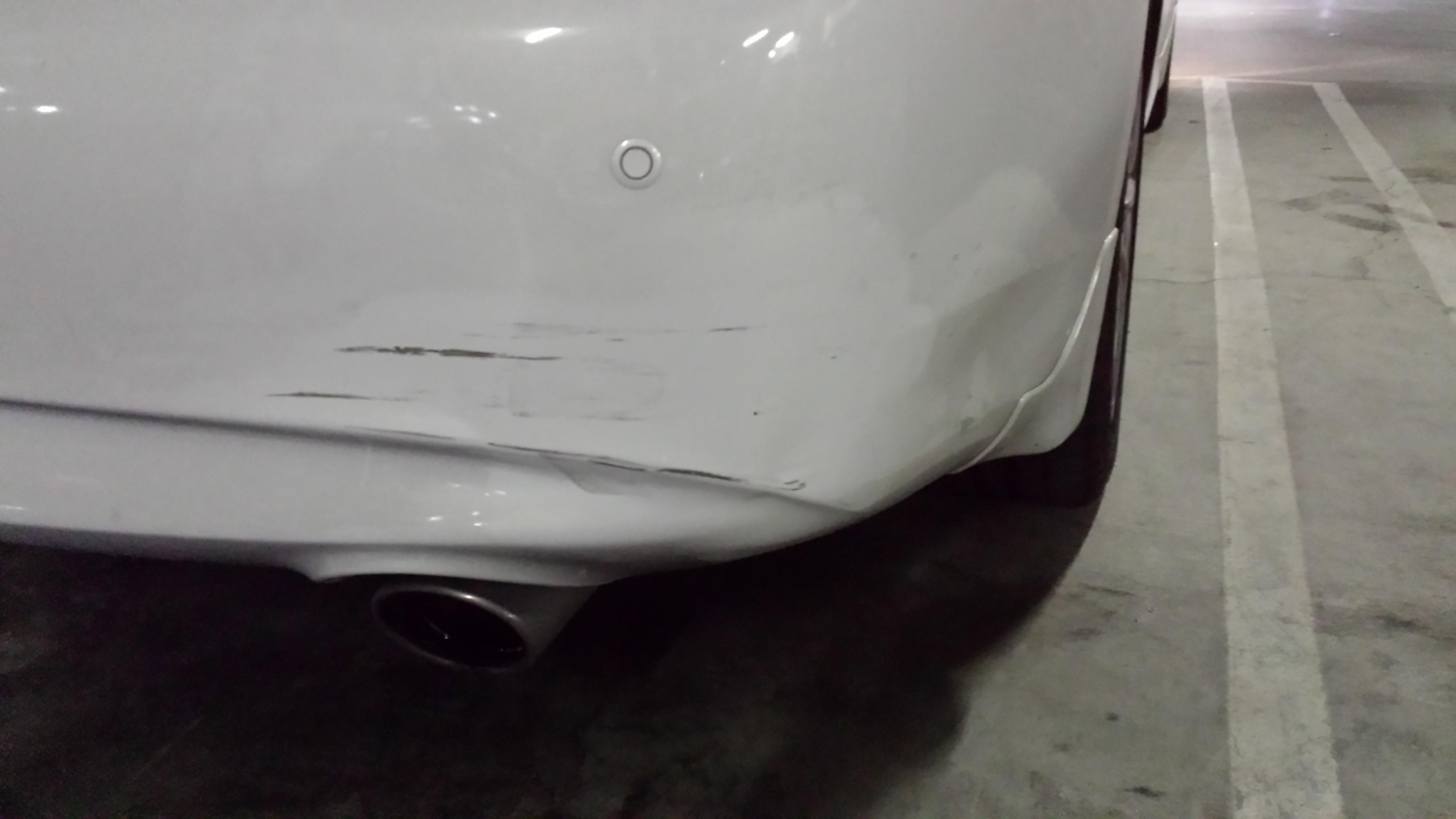

So this is what happened:
My bumper healed itself(!?).
I was planning on taking my car to the shop for 'pop out and buff off' job sometime this week but my buddy asked me last night if I got my bumper fixed. I said no and checked out the damage. It was healed up! I really didn't pay attention for couple of days to not make myself feel sad about it. Well its not perfect but looks fine so I'm just going to drive it as is for now.

interesting.. looks a bit better. some elves must have come at night. anyway, I would probably just have it fixed now since you're going to have to anyways due to the car being a lease. If you fix it now, atleast you can enjoy it looking nice and clean, rather than just the next person that owns the car after the lease.
