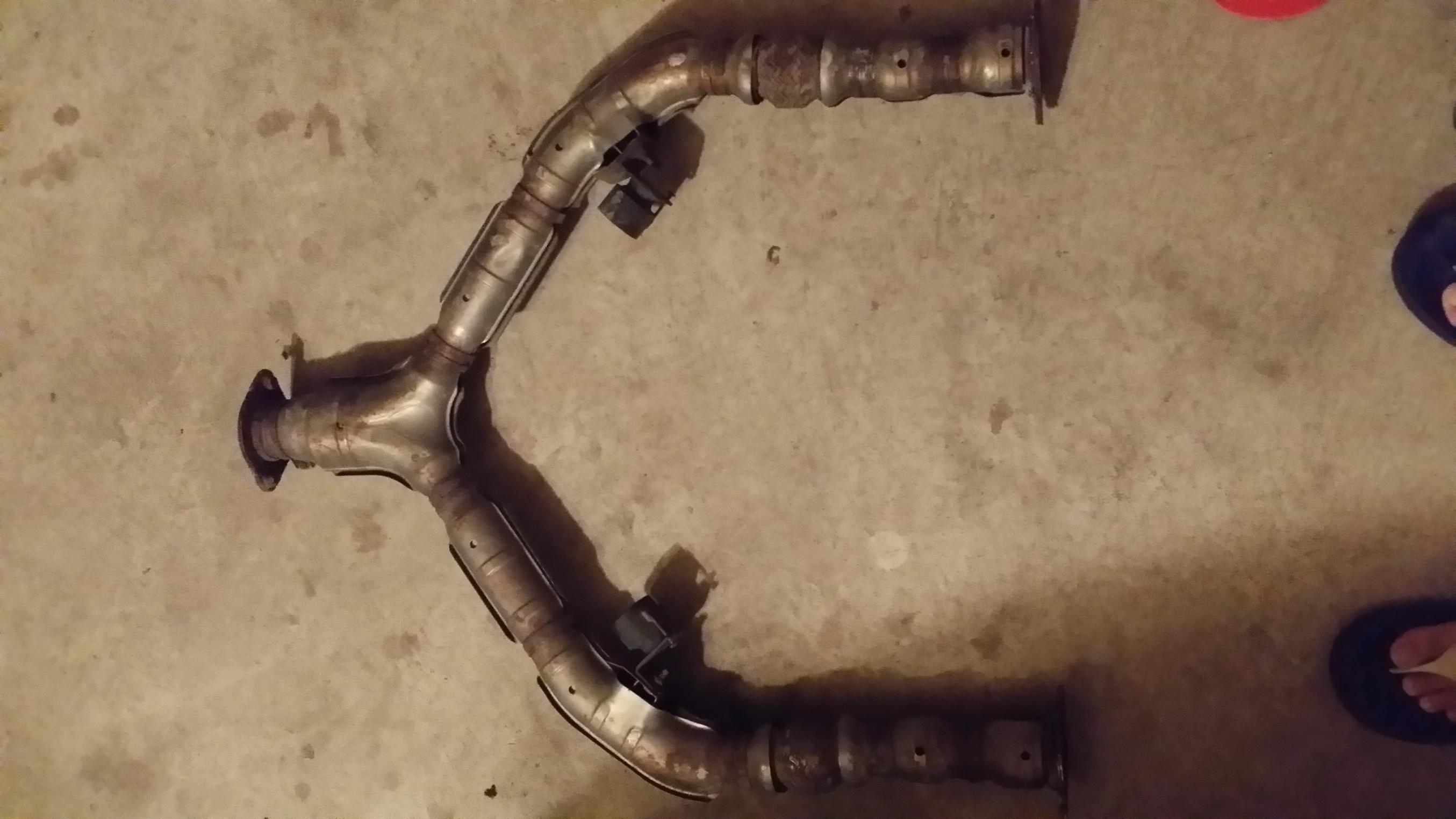

Are you sure the AWD and RWD Y-Pipes are different for sedans,
there's a guy selling a AWD 2010 Y pipe locally; I would buy it if it fits a 2012 RWD;
Judging by the picture he has, it looks identical?
https://www.myg37.com/forums/attachm...213_223810.jpg
