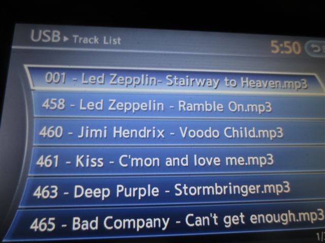

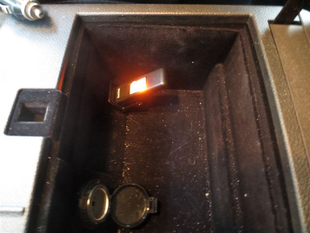

Try reinserting it.
Try a different USB drive
