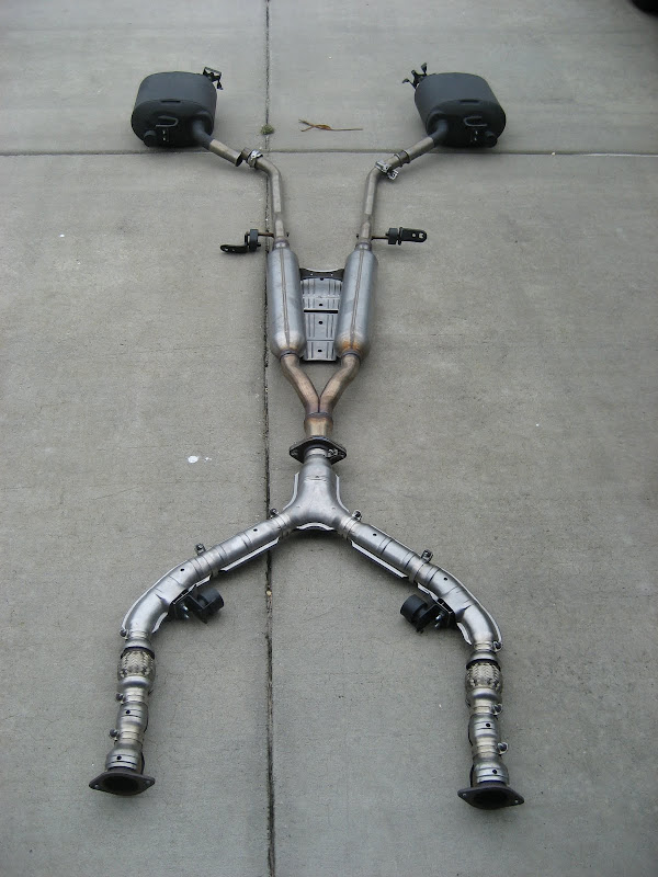

Since I'm in CA, changing or modifying the Cats is completely out of the question, so I need to consider the options from the Cats back. The y-pipe seems appropriately matched to the Cats, so I question if the midpipe is the right place to start as it seems Infiniti made the tradeoffs later in the exhaust with the smaller diameter tubing, which would limit the 'volume' of the exhaust. If you look under the car, the piping after the resonators seems unusually small.
Per the thread I linked to earlier from Tony, increasing the diameter of the exhaust tubing after the collection point within the Y-pipe seems to have little to no negative effects on performance, yet this will increase the volume of the exhaust, which is probably why Infiniti took this path.
If it's truly 2 3/8" at end of y-pipe, then a transition from that point back to a full 2.5" inch exhaust may yield some benefits.
The differences in diameter between stock and aftermarket are pretty easy to see in this thread as the user did an excellent job of taking the pics: https://www.myg37.com/forums/g37-sed...ion-guide.html
