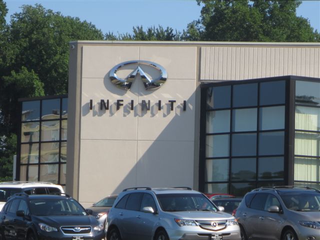

I had my 12th oil change at the dealer today at 43.2k miles and they not only did the oil change but washed and vacuumed my car. They also took all the bug splatters off from my recent round trip from NJ to Florida.
They know better than to try and up sell me any BS services
I have a great Infiniti dealer
