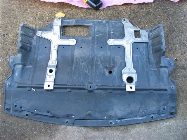

Here is a photo of the fiberboard shroud taken from my 06 G35.
It is possible that not all of the fourteen 10mm bolts were replaced during oil changed or it just got ripped up when you hit water.
Not a good idea to drive without it as it protects the lower engine as well as preventing water from splashing up into electrical connections.
My advise is to get it replaced.

So I finally got the part removed today, here is a pic here: https://i.imgur.com/CgsFMvk.jpg
Would this be the bell housing? Is it abnormal that it was held on by only 3 screws, considering there were so many drilled holes in the plastic? Wondering if the place that did my oil change didn't put it back on right...

It is a necessary part IMO. Not having it in place may cause airflow issues and possible overheating condition. The car was designed with specific airflow characteristics under the car. Without this piece, airflow under the car is disrupted. If it was not required, nissan would save a few bucks by not including it
