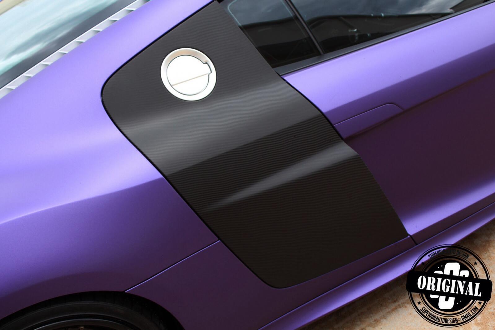

Thanx but the wrap color is a blue/purple

i think that will look good accented with CF and wheels to match. or atleast compliment the color!
