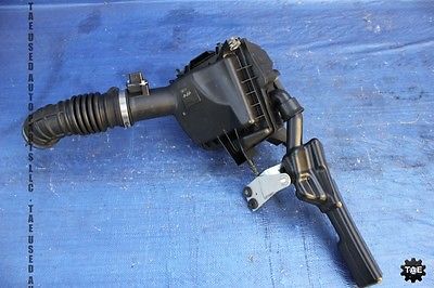

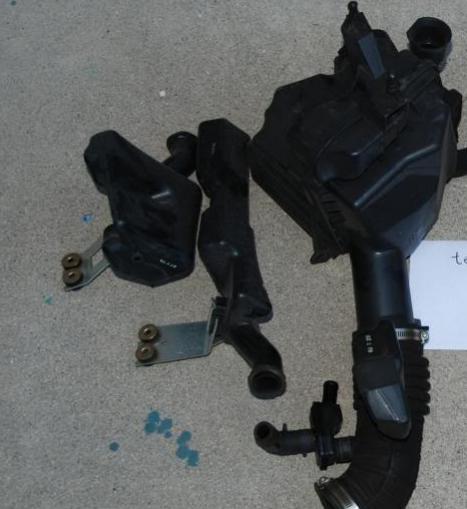

Here is a couple of pictures, one showing the resonator from the passenger side attached to the filter box. The other pic showing both resonators loose next to the driver side filter box. This is what my '09xS had. On my 6MT, the elbow is gone and replaced by a twist-in plastic plug on both sides. Otherwise the intakes and exhausts look identical.

I took that off when I replaced with silicone intake tubes^
the sound got louder with it off... although who knows if they make more power than stock.

AH, ok... I read a bit about this on the 370 board. Some guys replace the crinked tubes with aftermarket replacements and drop in filters which is also a bit louder. I believe there is a side branch tube as well, just not sure where it connects.. ha ha..
