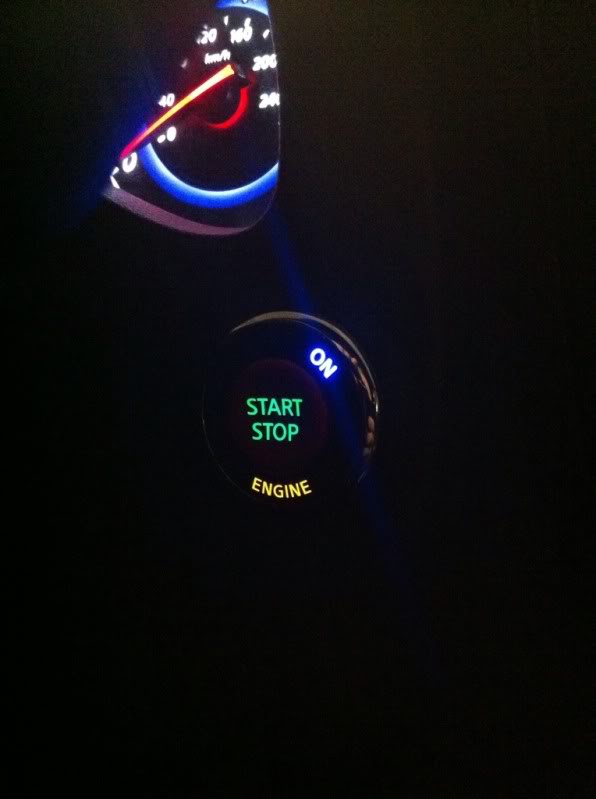

GTR button, "engine" lights up.
Video:

Smooth modding means doing a LOT of research. Through my button searches, since I recently upgraded to the GT-r button, I found out a lot of people have the LED's modded on their button to be different colors. Part of this is also adding a LED for the ENGINE light if I am not mistaken. The pics above are obviously of a modded button because the start is green.
Hmmmm...Hopefully that's how it works...just adding an additional LED for the ENGINE to light-up...Most of the research I noticed was people modding the GT-R button, which, I'm guessing, already has the LED for the ENGINE spot. Not many people have modded their own OE G start button.

macintos...You are correct! I just popped open the '08 button I got from ebay. The ENGINE lettering is translucent, but on the blue LED board there's a location for an LED but no LED soldered to it! Looks like can solder a LED to the location and, voila!, illuminated ENGINE! Thanks!
