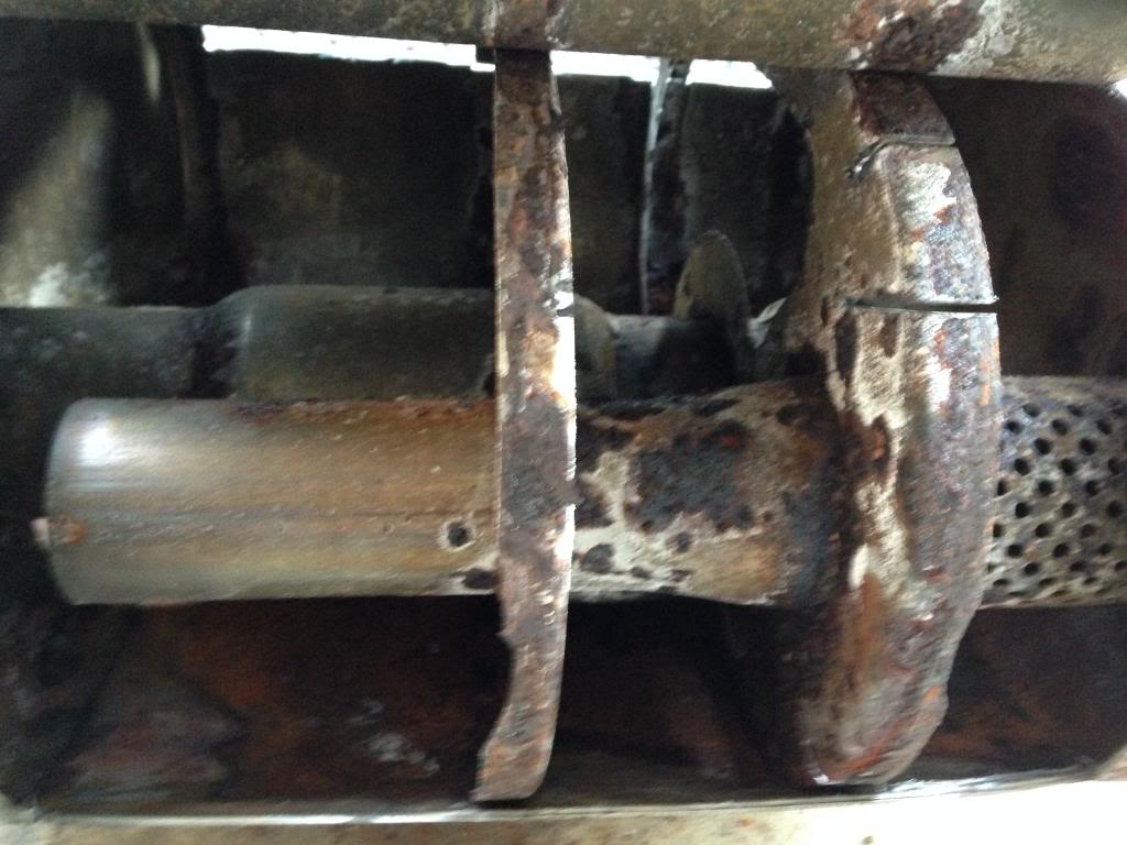

I've done it.
Inside of the mufflers look like this: (Although hopefully less rusted. mufflers purchased from a flooded G)

Did you leave the pipes alone and just remove the fiberglass packing? From the looks of that picture it looks like options for modifying the muffler may be limited.

Originally Posted by Limited
I've done it.
Damn, is that after you peeled off the starfish & barnacles
There isn't any fiberglass packing. I just removed the two walls you can see and left the pipes alone.
Originally Posted by rm2342
What does it sound like? Rasp bag? or just slightly louder?
It was maybe a tiny bit louder than stock. But really difficult to notice the difference. I ended up doing the muffler delete but now i feel it can be too loud. I'm just difficult to please i guess
That's the muffler as soon as i got the shell off. Unmodified
