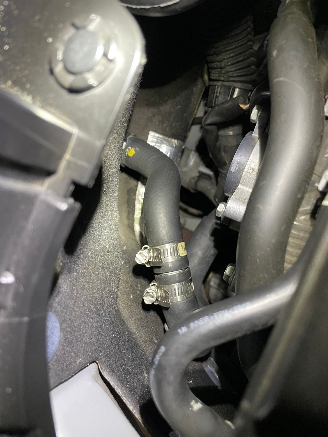

Not sure what happen. I changed mine in Feb 2023, and the pic above was taken this morning. No leaks or seepage. #knockonwood
I've seen pics online where the worm clamps have tore into hoses as they have expanded so it gave me a reason to change back to the oem clamps, so I wasn't too mad. With that tool having a locking feature the switch out was a breeze.
Don't get me wrong, I would never use them on the radiator hoses as we used to do that in the 80's and it was impossible to distribute the tension equally around the diameter of the hose and they always ended up leaking or requiring tightening.
They seem to work nicely on thicker hoses of much smaller diameter. Guess time will tell.
