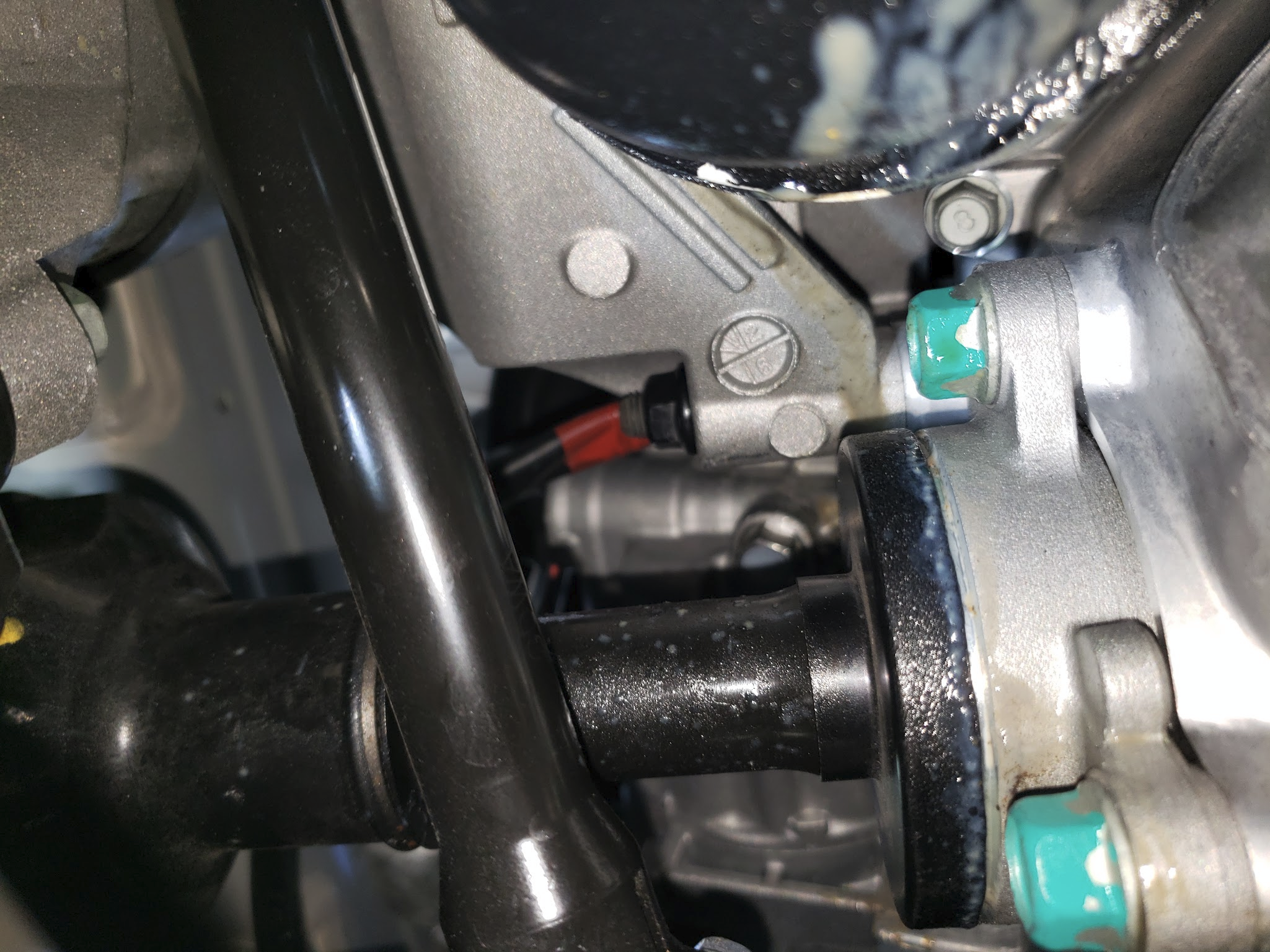

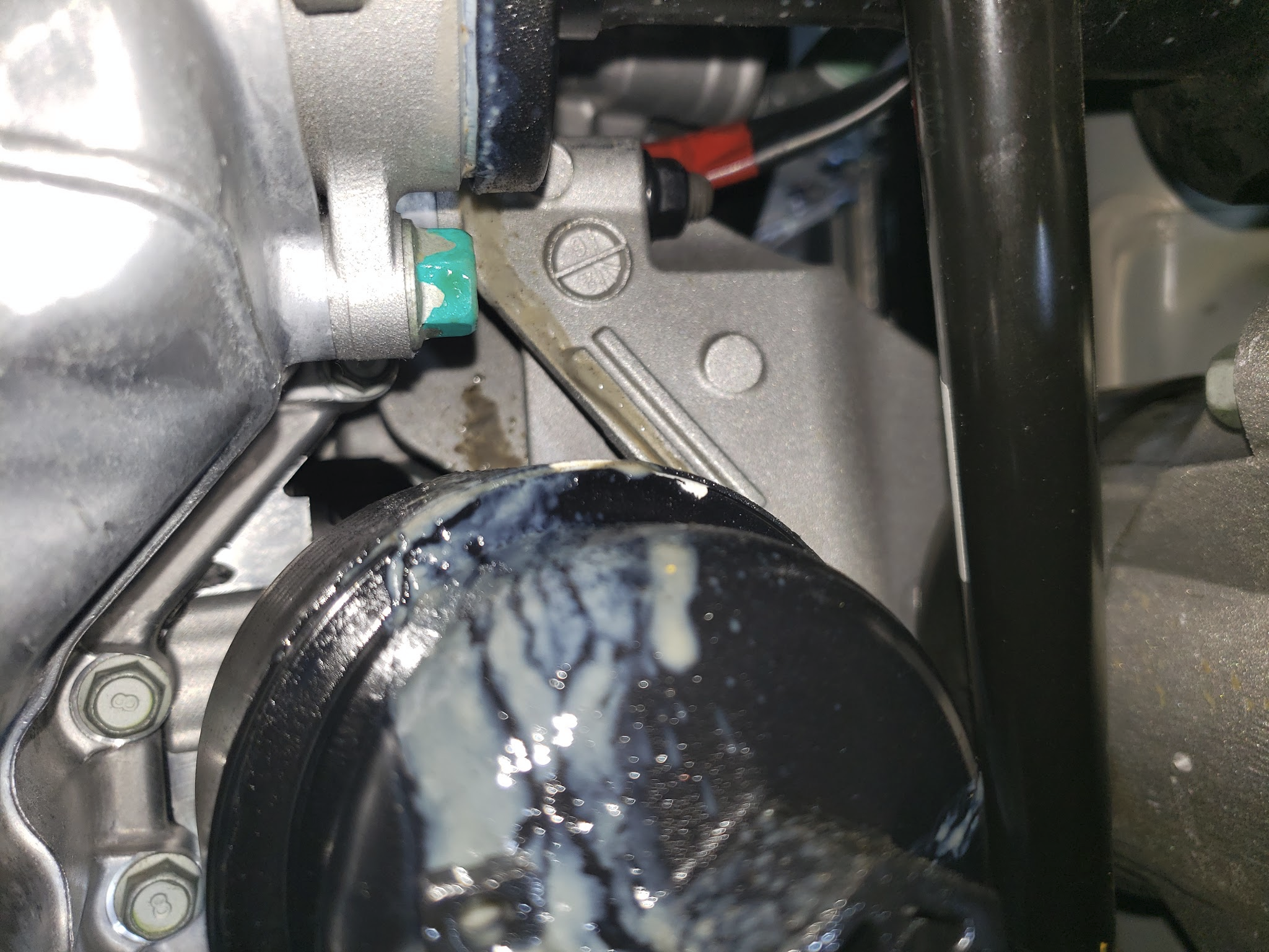

I'm so glad I play no video games. No headaches of figuring out which gpu to go with. My only video concern is hardware decoding for multimedia (htpc). Current box has some flavor of a 1660 in it. Also have a 1650 collecting dust. Went with a 5700G last fall to have all decoding in hardware for the htpc. For now av1 needs are minimal.
Re car, it's going in tomorrow for a front diff leak. My guess is a seal. Car has 6300 on it now. Did my first OC at 1500, no leaks found. Did another OC at 5500, saw slight leak. Wiped it down then drove another 800 miles before inspecting again. It's not a gusher but needs to be fixed sooner than later.
Never had any leaks with the G...

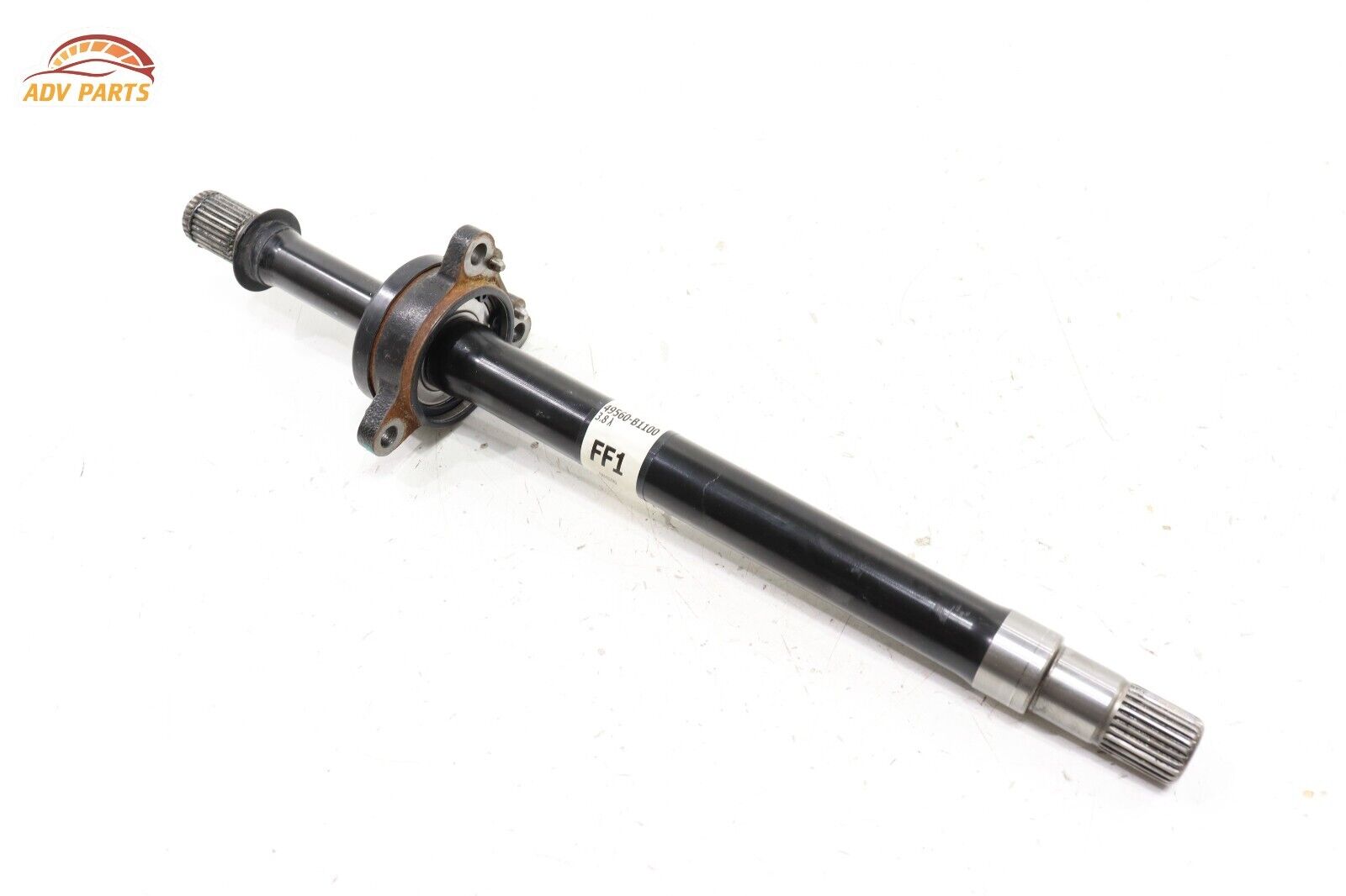

Update: The diff is fine. Tech did have to lower the steering rack to check level.
The problem is this part - 49560-J5000 - Bearing Bracket Sh(aft?)
As pictured above, the left side connects to the inner CV shaft. The bearing bracket itself is bolted to the oil pan. The rest of the shaft goes through the oil pan into the front diff. Given the white color of the grease, he suspects a seal failed within this bearing. Repair requires replacement of the whole shaft as it's one assembly.
Of course to get at it requires teardown of some suspension/brake parts to get at it. Parts on order, eta a week or less.
They were surprised to see this go on such a low mileage vehicle. My guess poor construction/assembly. Maybe the seal wasn't fulled seated.

In reference to my post above, 13972, got it repaired yesterday. Even twisted their arm to do an alignment (axle nut and 2 ball joints had to be separated). However, is it too much to ask for the little things... 1) area where bearing jizzed was poorly cleaned, 2) 6 bolts hold the lower engine cover, 5 gorilla torqued, #6 not even finger tight. I shouldn't have to crawl under the car to check these things. On the plus side, the axle nut got redimpled and both lower ball joints had cotter pins present.
Does the awd G use a similar set up in front with an axle through the oil pan?
