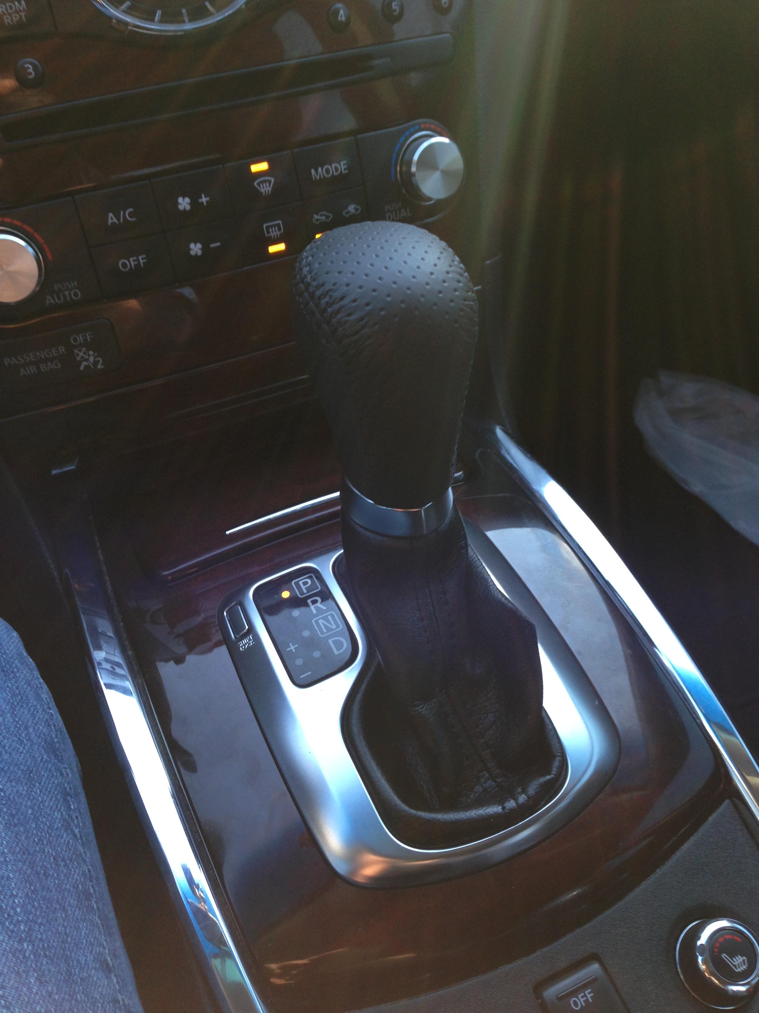

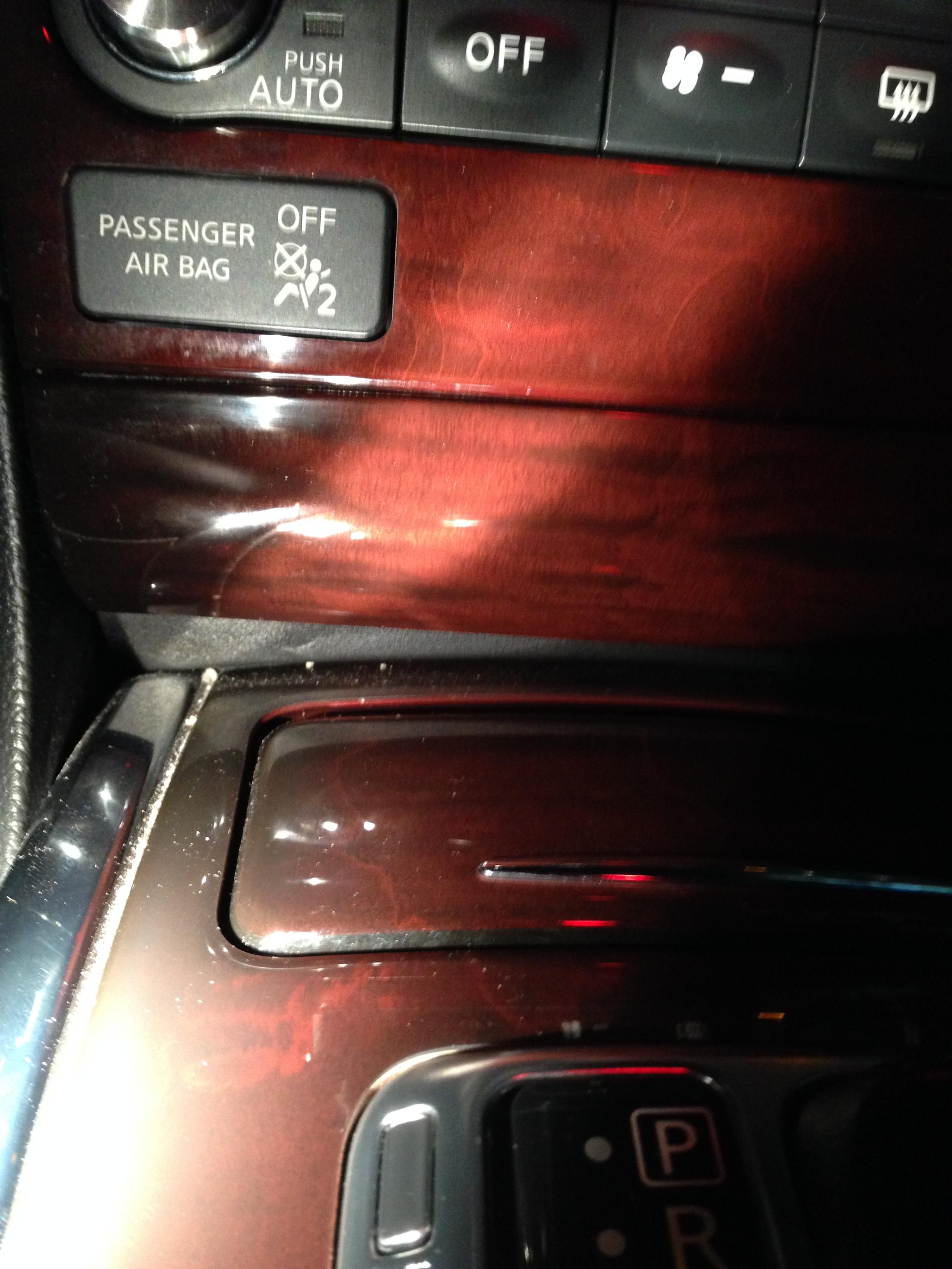

I was able to get the section under the shifter to pop "right out" by digging my fingers in and pulling up. In the front though under the climate control there is a small piece which appears to be a finisher piece that has me a little concerned. It looks and feels like it needs to come out in order to get the complete shifter section up and out to where I can start unclipping things but, as you mentioned, it looks and feels so brittle I'm concerned about snapping it. I read the FSM and it seemed to say, just take it off. I'll try again when I'm not sitting in the dark, maybe I'm just missing something.
I looked at that piece that was giving you a hassle. That might be the piece that keeps my wood trim in place!
I've had my entire console out at least 5 times - that finisher piece really does just pop right off. As you pull off the shift trim, it will come right off with it. There's not an easy way to get it off first - just pop it off with the shift trim. After that, the console literally takes 5 minutes to fully disassemble.

This piece right here? Mine seems to be welded in... Or I just haven't gotten the correct angle on it yet.

I did get this far though I still need to dremel in the slots for the clip

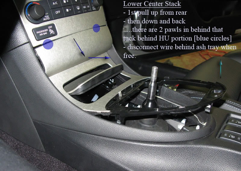

This is from that DIY that I linked, I pretty much just followed his tips and it worked but like you've noticed it takes a bit of motivation to get it free.
Thank you Brad, I'll try it again. I glanced through that but was actually somewhat busy at work today. Usually a slow week but no such luck today, or I'm just catching up. Looks like it will be nice tomorrow so I'm going to plan on trying to catch up on some odds and ends I've been wanting to get done.
