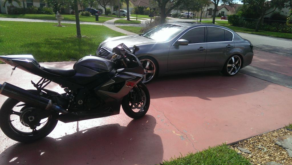

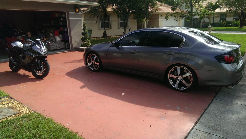

The G now has another sibling to compete for my attention with. LOL
GSXR 1000. Full akropovic titanium exhaust, power commander 3, TRE, Dyno tuned 183 bwhp, top speed..... To be determined?

Justin is about to achieve hyperspeed! Nice addition for sure.
