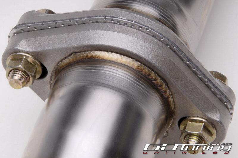

I just installed my Top Speed Exhaust I got yesterday, it sounds great, but now I'm having a problem with it scrubbing on the speed bumps on my road. I live in a subdivision with 7 speed bumps on the way to the front gate. It did scrub before on a couple of them before the install but was never to bad. Now it's scrubbing on even the lowest one near my house, I can go out the back gate without hitting any speed bumps but it goes to the opposite side of town I go to. Its scrubbing the flange were the Top Speed exhaust mounts to the factory tubing in the middle of the car. It probably only needs to go up about half an inch to clear them all. I stuck a 1" piece of wood (just to see) in between the exhaust and a brace to raise it and made it over all the speed bumps, but I could feel the vibrations of the exhaust through the floor and need some more ideas. Any ideas on a permanent fix.

If it's just a flange what's preventing you from adjusting it and move it half an inch like you said?

Its where the old and new exhaust meet and there's not any room for adjustment. It just sags down farther than before. Here's an example.

you can modify the exhaust hanger. e.g cut it short so that the hang point would be closer to the under of the vehicle at the same time giving you the half inch clearance you need.The rubber mount will remain unmodified so it should still smooth out any vibrations

I just took it back down and tried that but it wouldn't even bolt back up if I turned it over. Thanks though.
I was thinking the same thing, guess I will try to get it to a shop on Monday. I need a welder. LOL

Took it off and bent the hangers down a little and no more scrubbing! Glad I got that fixed. Thanks for the reply's guy's
