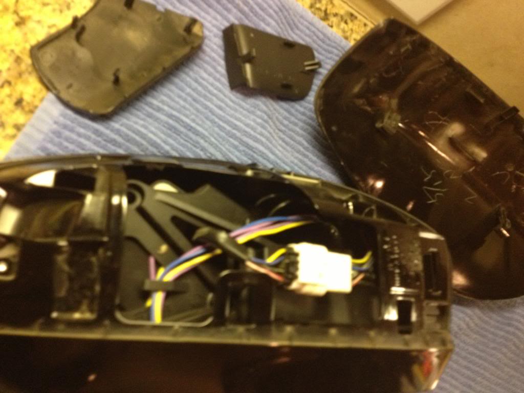

I took off the cover and it appears the connector is behind the mirror, BUT, don't know how to take it off so I can unplug the black taped up wire that's threaded through Part #5. It is NOT the BIG Connector you see on TOP of the open mirror, it is BEHIND that, or if you looked at the FRONT of the Mirror, where you look at when driving, it appears to be connected Behind there.

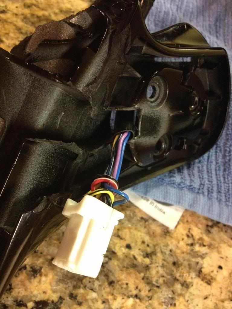

Here is the Wire and Connector that won't slide through the hole on the Mirror Base.
It's the wire with the Blue, Pink, Pink Yellow that looks to be connected behind the Mirror that I need to unplug so I can get off the #5 Piece.

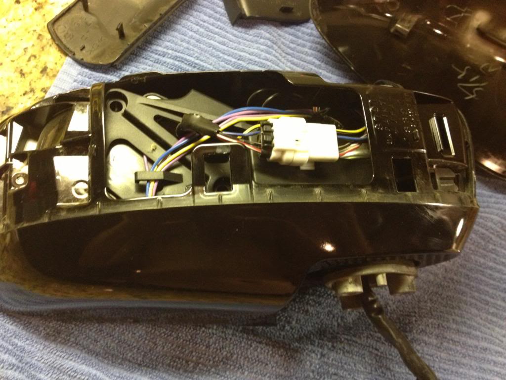

Another Shot of it.

Could always cut it and solder it back.
OR
Take each individual clip out of the white plastic thing (assuming that's not what's fitting through the hole) out with a jewelers pick set, then put them all back in after. Make sure you take a picture of what wire goes where first of course.
Only 2 options I see.
Personally, I would do the first one. Little easier and less room for breaking stuff.
Maybe disconnecting the other end of the harness?.....idk
