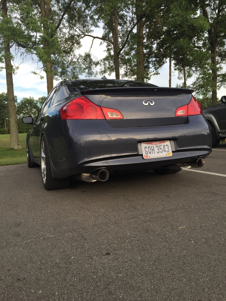

Nice pic there, looks like they fit perfect! And yeah, they are a nice sounding setup.

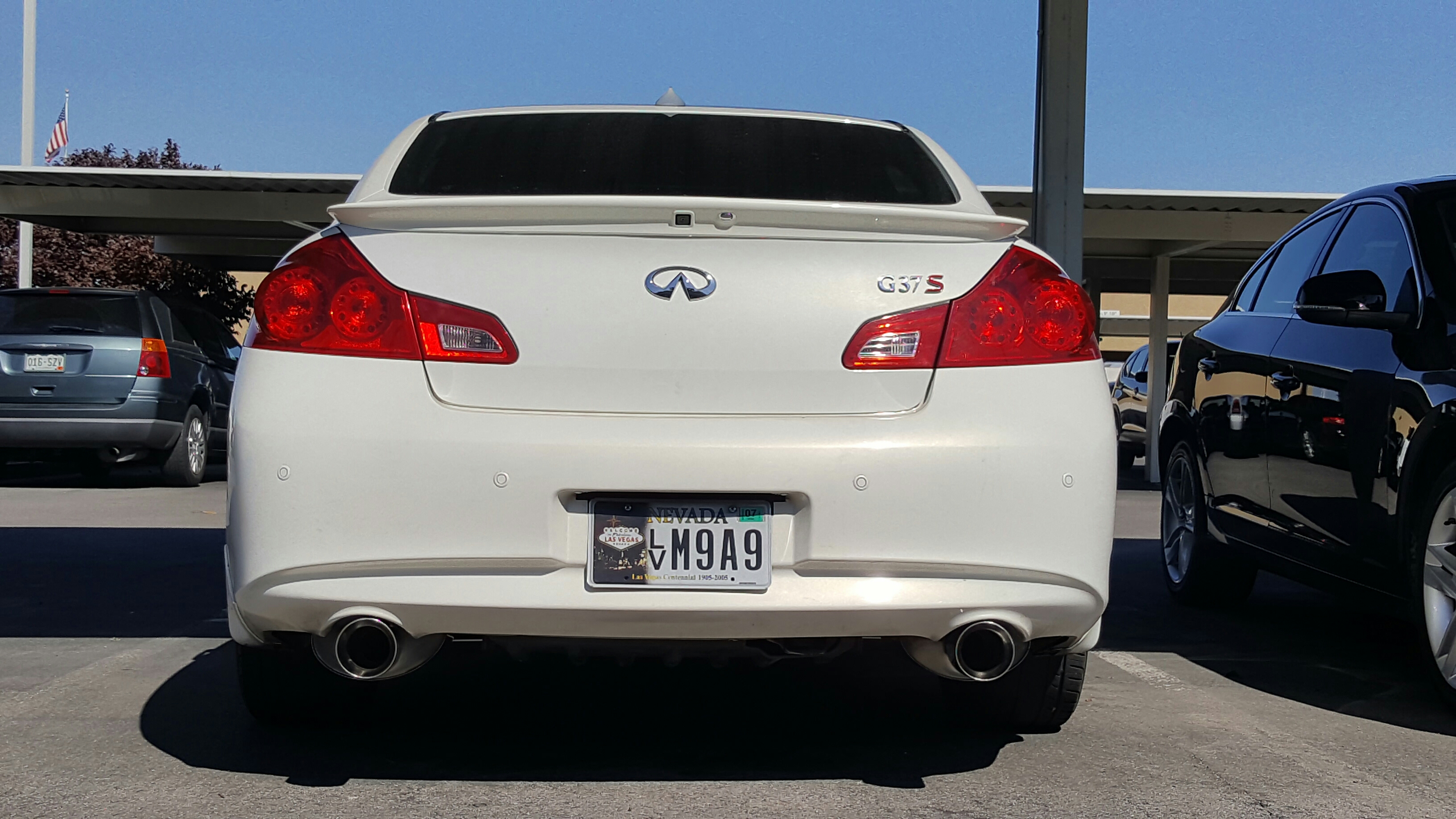

I actually went ahead and replaced my clamps with these that I picked up at Oreillys.
Here's a picture of the clamp that I installed and a link to them on their website if you're interested.
ROL Gaskets E25ST - Muffler Clamp | O'Reilly Auto Parts
Everything is nice and tight back there now, the way it should've been and on the plus side the clamp is not noticeable unless you look from below.

Ymmv, josh sent me a pic of how the clamp should be installed and i was less than impressed and could be seen at an angle. Didnt offer to replace the clamp though i didnt really care since i resolved the issue myself. Hmm Maybe i came off as an asshat ? Lol
Yes it was deff was tightened incorrectly, i actually loosened my mufflers and retightened according to the instructions this morning and they sit correctly now if you look at my pic. Im assuming my shop didnt listen to my instructions first time around.
As far as the tilt, i wasnt sure because from all the pics and videos i saw i swore they were straight. Josh confirmed its normal and said it coukd just be the picture/video angles making it look that way and i can rest the issue.
Thanks for double confirming the tilt was normal and input Fisher its much appreciated.
