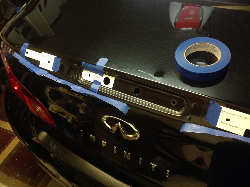

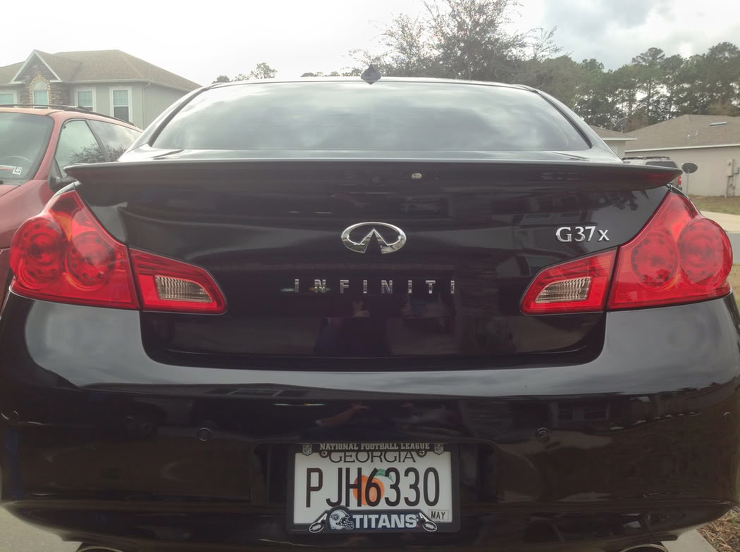

So here is where I started. I put the template on and used a sharp wood screw and hammer to mark the drill points.

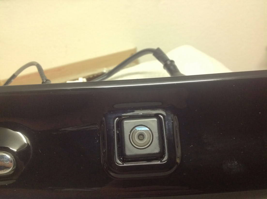

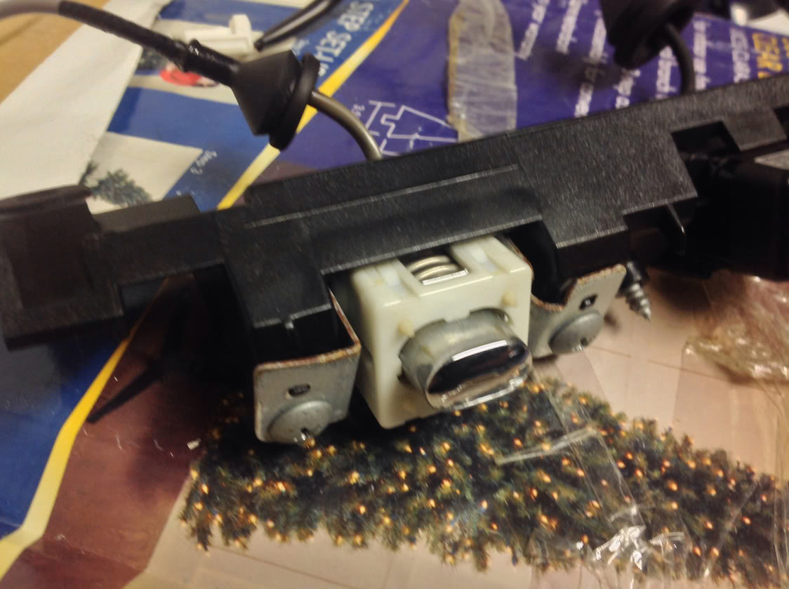

Next I drilled the holes and disassembled the bracket with the camera and button, reinstalling them in the included new bracket. Mine was wrapped up within the spoiler.
Here is the reinstalled camera and button. I added a washer to the button to make the button poke out a tad more like the chrome piece. I also had to bend the corners of the metal bracket for the button to keep it from impinging on the spoiler once screwed down.

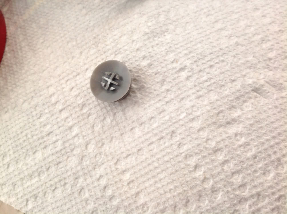

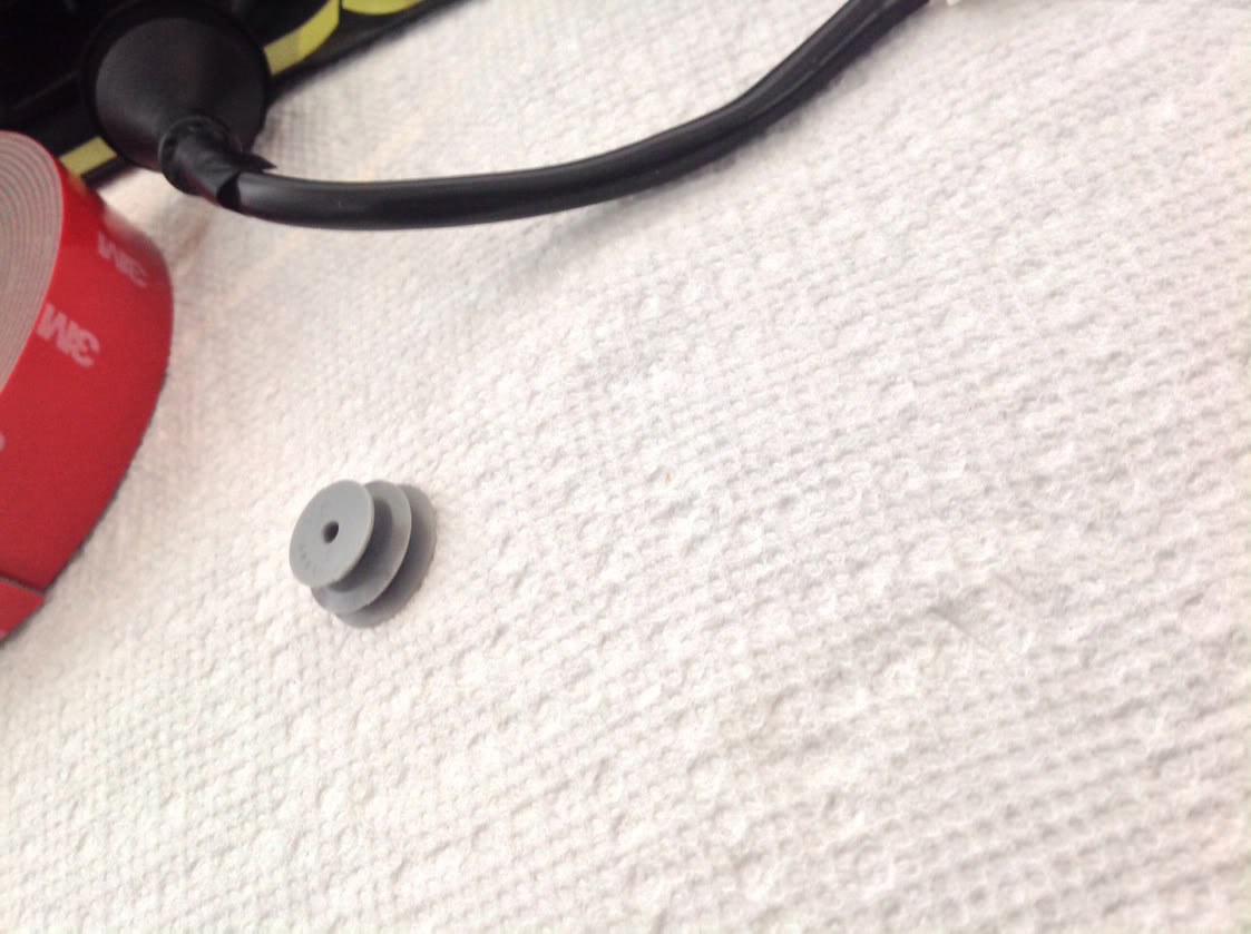

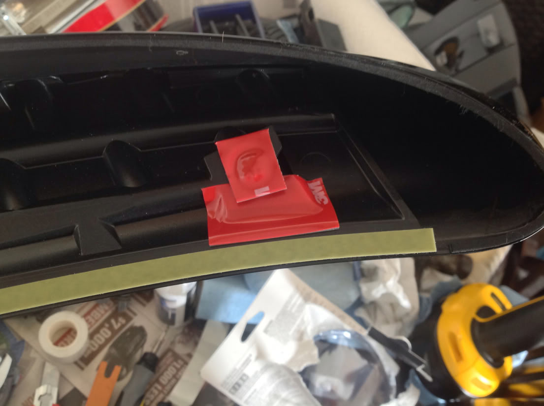

I've seen the drilling part of this and while I could have done it, 3M trim tape super sticky works as good. There were a few 1 inch places where the spoiler didn't have 2-sided tape, so I cut and placed tape there to seal the edges. Then instead of drilling I cut the clips and used 3M tape to stick it to the trunk.

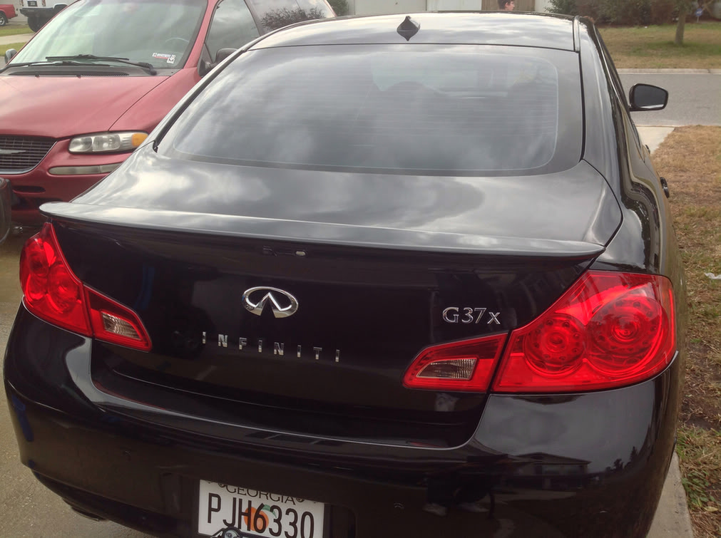

And the finished product!

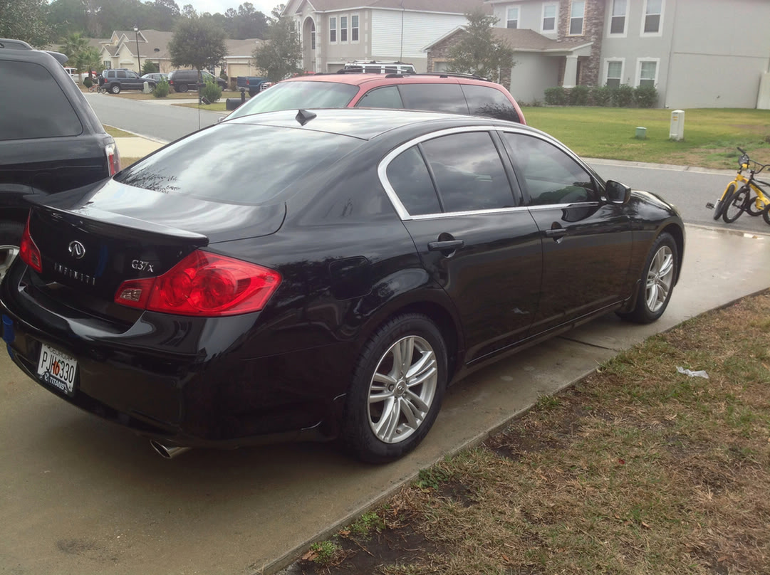

Old Jan 11, 2014 | 08:25 PM
  #81
Likes: 4,952
Nice job, no need for those outer clips and drilling outside the chrome cover wasn't something I wanted to do to my G. Bet you're happy w/ the new look!

Did you check to make sure the outer edges had good 2 sided tape as well? Thats why I used it on my clips as well. Something to remember if you wax or polish your car the instructions say to use 91% or better alcohol to prep the area for sticking.... just my 2 cents...
