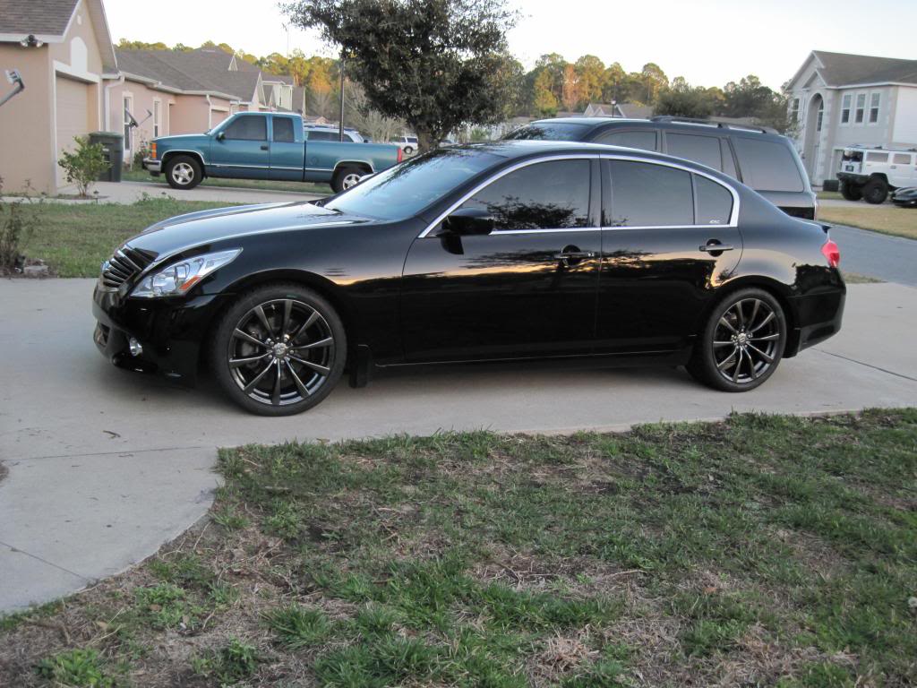

My Coupe wheels:

I definitely thought about gold myself, but wanted something a little different. I like it a lot.
