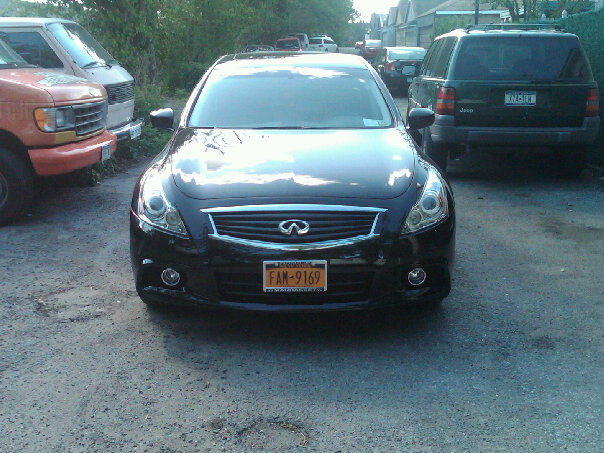

Got some really up close shots?

I think it looks really good. Good idea. I will be doing the same thing soon along with tinted taillights.

I really like this! do you have close up pictures of the edges? was it hard to cut?

I just wrapped my grill as well

do you have a close up? like near the edges
