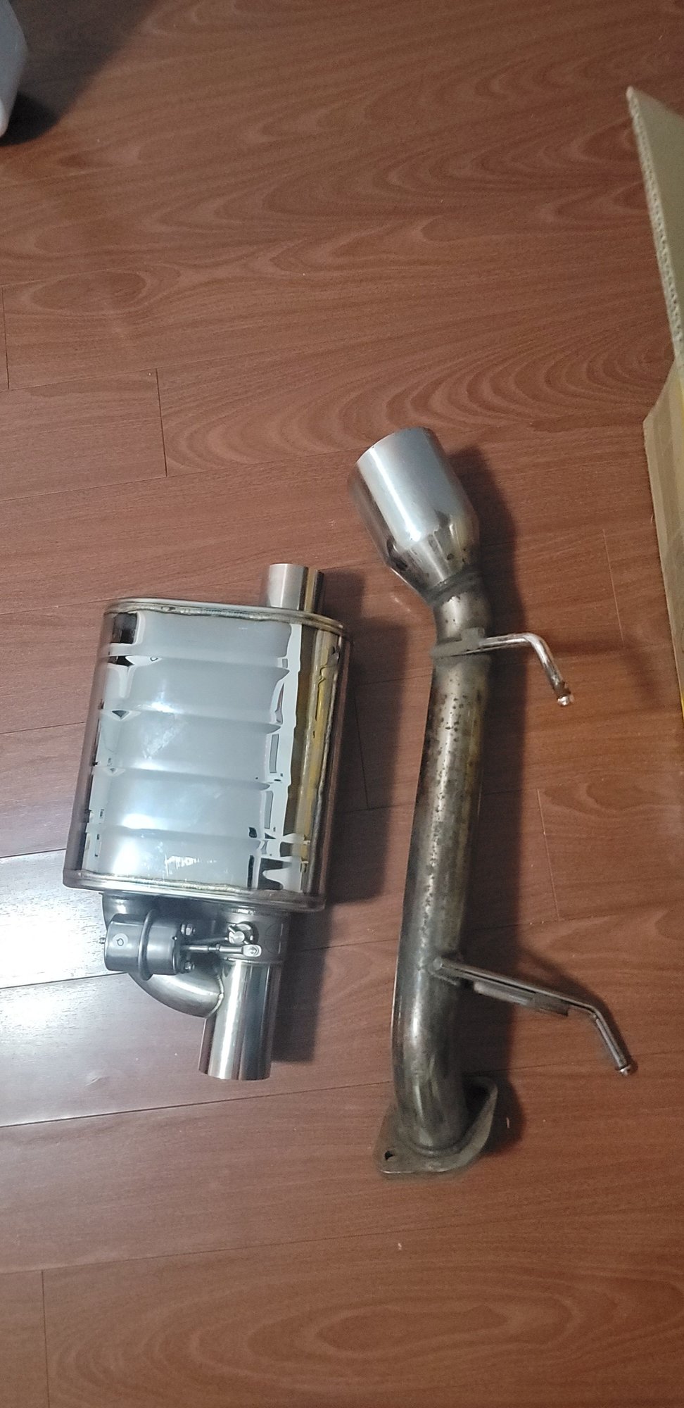

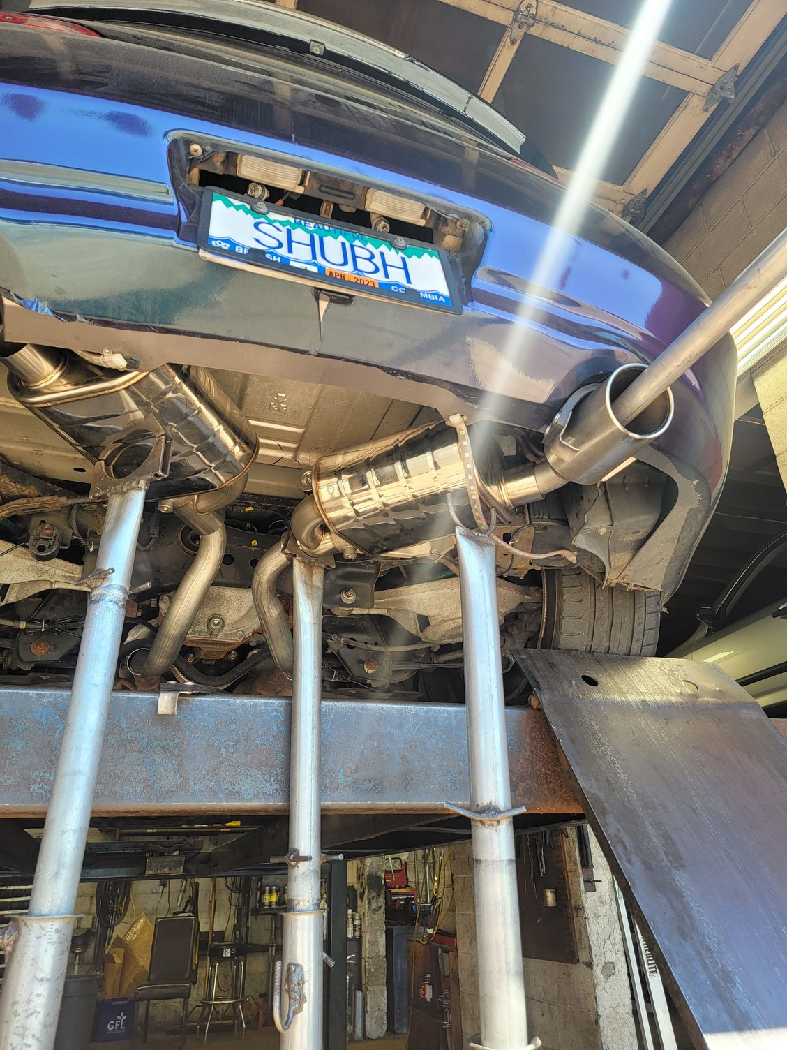

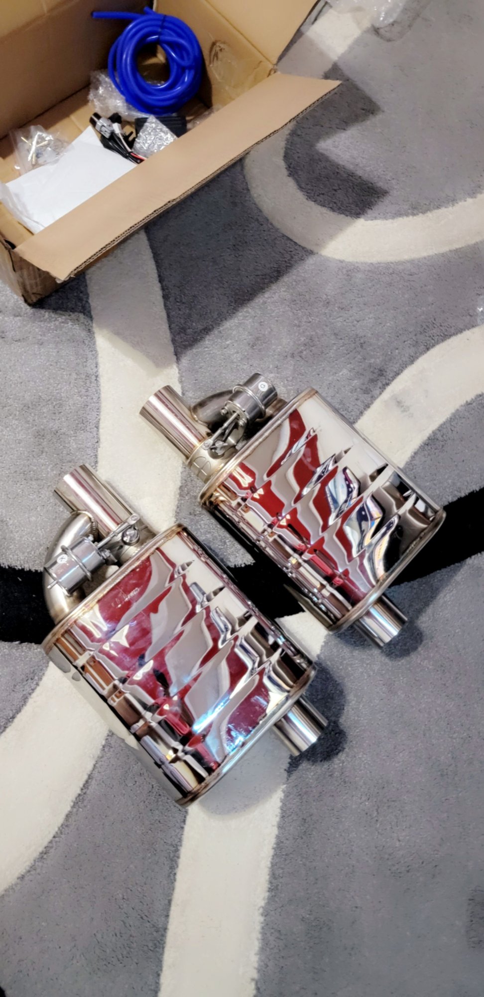

Here's what I did
I was able to pick these mufflers from Ali express for $150 cad. Shipped straight from China. Then I got the stock muffler cut and got the others welded on. Welding labour was $600 Cad and I paired up with the Berk resonated test pipes.
​​​​​​Told the guy to use factory exhaust tips for a low key look.
after I did the vacuum lines myself and fired it up.
When valves closed, car sounded stock. When with the test pipes meaning these mufflers are quiter than stock
When open, they're a straight pipe which sounds insane.
(Will post sound clips in a bit)
The muffler next to my top speed exhaust they're almost the same length so I knew it would be a tight fit
Quality of these valved mufflers is outstanding
Stock exhaust
Here is how the mufflers were able to fit
look.
Stock exhaust
look.
