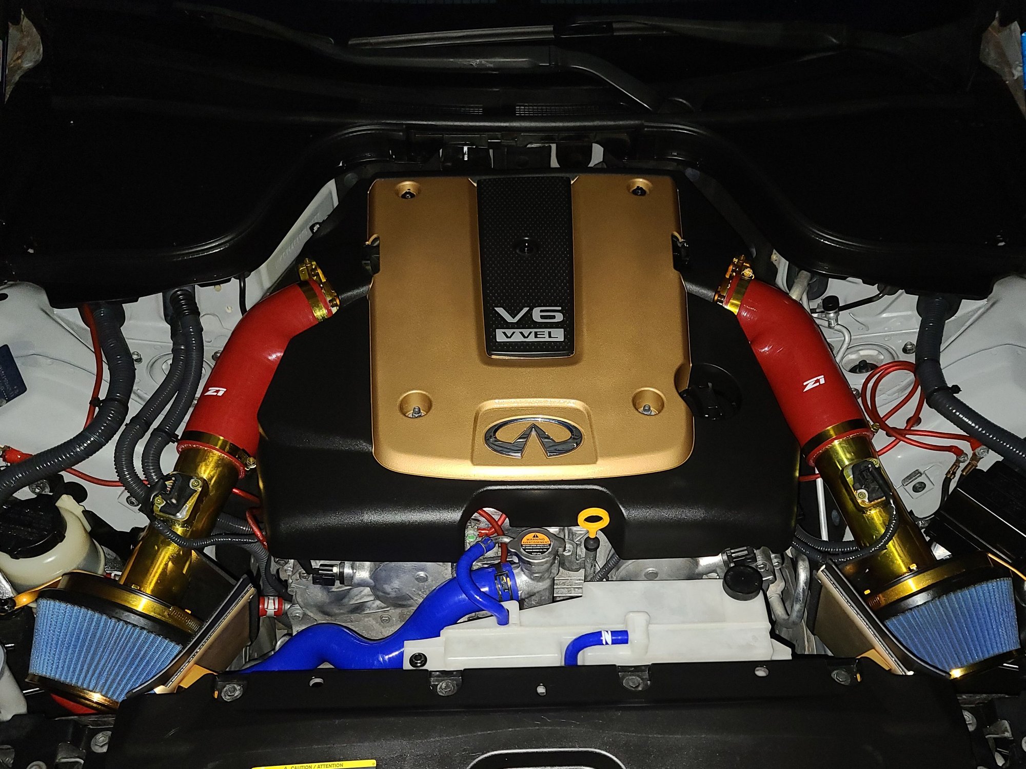

Decided to do my engine bay. I also put in a new aluminum under shroud. All in all, I replaced most of the hoses with silicon, replaced my air intakes (painted the new ones), redid my engine cover (painted) and painted my throttle bodies as a last second decision to bring out the gold.
I have no regrets on the look, but if I were picky on power, I would agree with the many on power loss with the JWT intakes. My foot goes further to the floor for less response. Sound is near existent to what many say. A tiny bit of a trumpet effect if and only if you floor it. For me and the commuting I do, it's acceptable. I have it worst than most so some may read it as exaggerated, but a cold engine for me is in 90°+ heat so under the hood is always hot. Still like the look even though Z1 sent me a returned setup with no directions and all my hardware was both lacking and loose throughout the box. I made it work.
I painted the chrome without sanding (there were more than enough scratches already when I opened it)... I painted after cleaning with isopropyl alcohol. I did a coat of VHT-MC202 Mtl Cast Yellow Anodized, and then a coat of Dupli-Color MC205 Orange Metal Cast Anodized soon after, followed by two light coats of Dupli-Color DE1636 Ceramic Clear Engine Paint. The engine cover I used VHT SP736 Gold Brake Caliper Paint (had some left over from doing my calipers, worked fantastic), also coated with 3 coats of Dupli-Color DE1636 Ceramic Clear Engine Paint.
To clean my engine bay, I started a couple of weeks ago by simply filling a couple of spray bottle with Dawn and water. I would open my hood and spray about 5 ounces all over the place and close the hood until the next time I thought about it. No elbow grease. I'd say I did this four of five times and then did the actual cleaning. I can't weigh it to if I didn't do that, but it was super easy and the grime just fell away. I used MEGUIAR'S G15812 Plastic Restorer for everything in the bay, other than the engine cover which was just painted that day and wouldn't give me a good result anyway on it.
Last thing yet to be done is a strut tower bar. Still contemplating between the Soul Function and the Cusco. Haven't really search much though so please feel free to chime in.

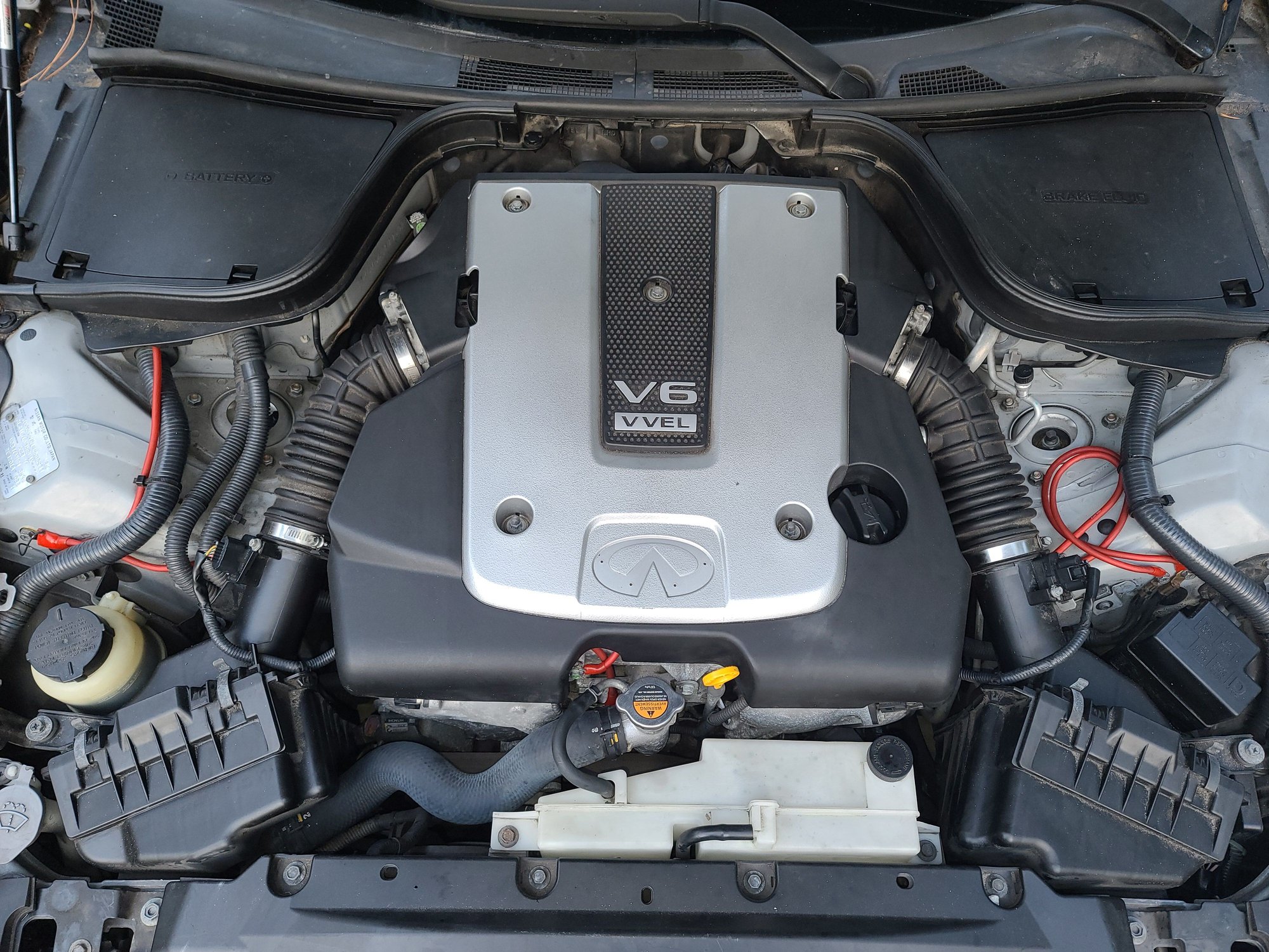

Before.
After

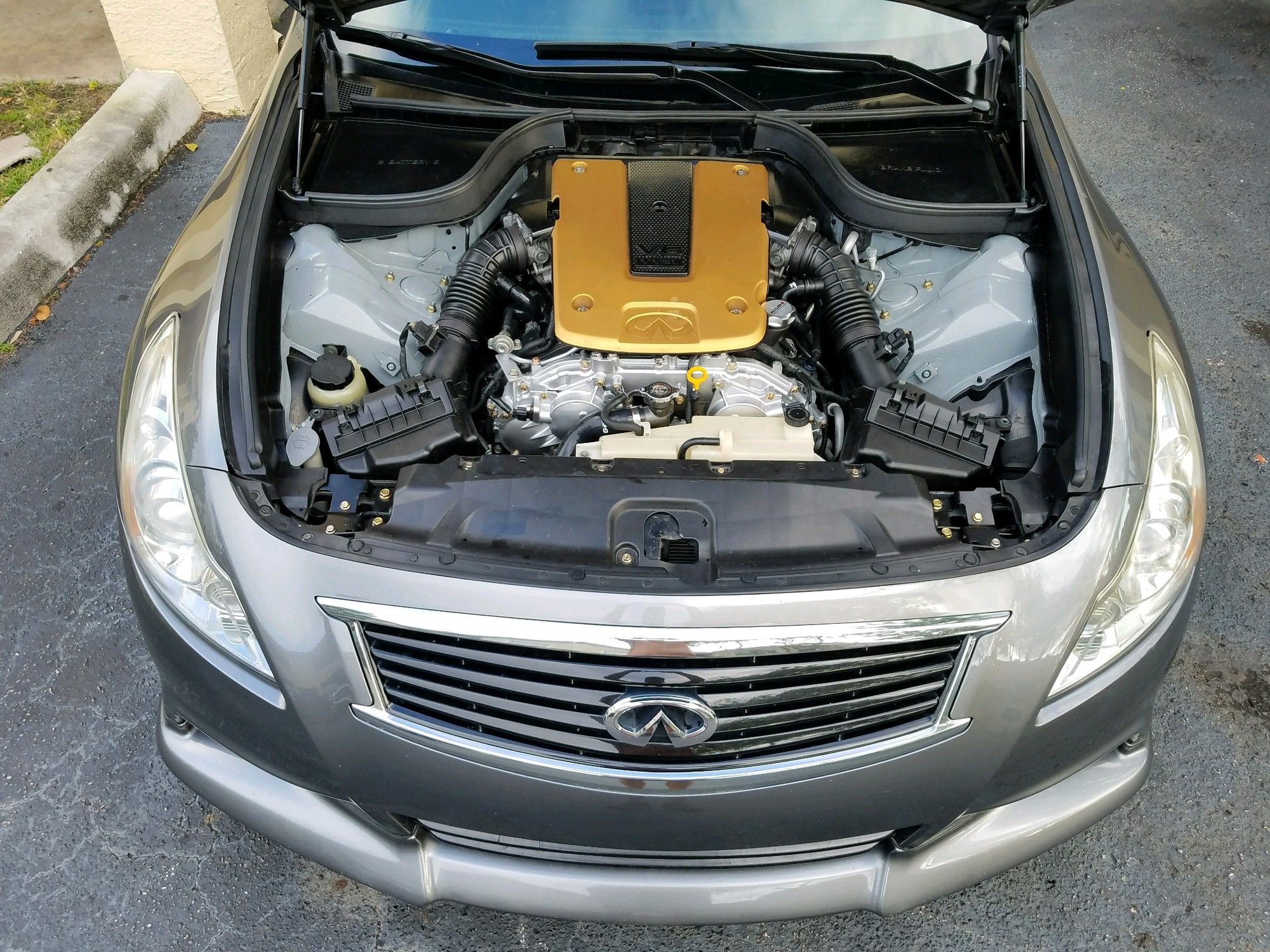

Here is my setup:

As for those intakes losing your power, I could see right away that heat is the issue. Your stock box had a full enclosure (from the rest of the engine bay) for the air whereas the current intakes you have are open to the engine bay from behind. These engine bays get HOT. Hence the reasoning for the long tube intakes where the filters are outside of the engine bay and in front of the radiator.

Look at his pic... He's got these funky heat shields between the filters and the radiator. It's something.
Yes those might help somewhat...
Funky

Here is my setup:
Wire tuck And clean aluminum, no corrosion. Nice.
Not a fan of that cropped cover, but props where due, BULL.

Didn't even notice the wire tuck, thought it was a work in progress picture
That looks sick

+1 love the uber clean look BULL, any hints on where you hid all the mess at? I think I may see a summer project looming

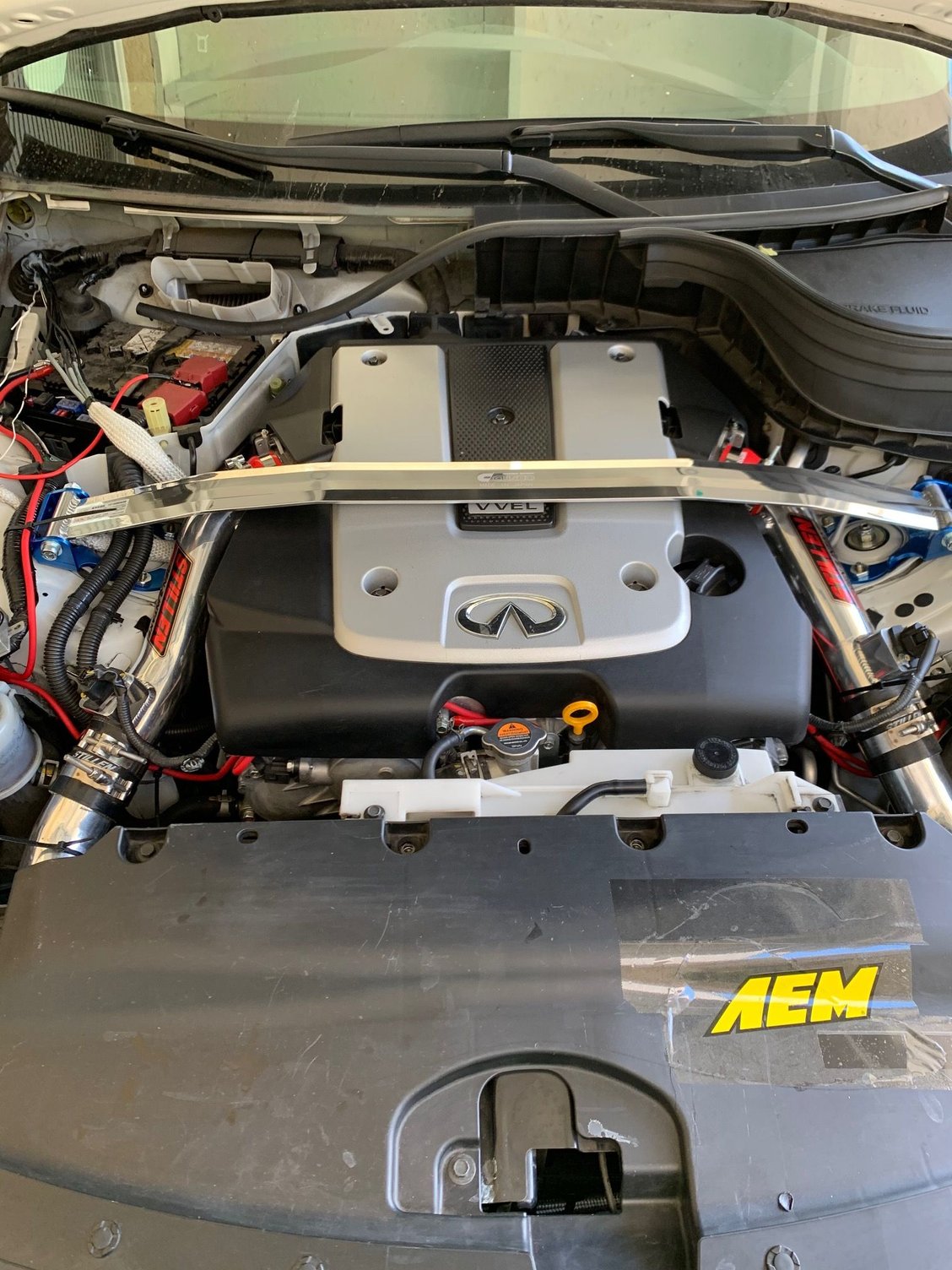

OP isn't around, and this is turning into an engine bay thread, so... I took this pic last week. Here's mine.
Basic stuff, mostly common mods... painted cover, dress-up bolts, P2M coupler brackets, FSTB, etc.
Some of the less common mods: a custom Infiniti emblem, CF wrap on the upper trim, a custom blank plate at the back with a single piece of trim seal.

Anywhere I could, the light wiring went behind the fenders, the Power wires were re-routed, same with the PCV. All of these just clutter the bay.
That looks sick
I'm my defense I have been rough on my car. Since I've put it on the road, it has become my daily and it's seen 20k miles already since the tuck.
Currently working on the engine wiring to see if I can make the VHR valve covers stand out.
I can't see any of your pics Roch and it makes me sad wonder if it's my work restrictions
