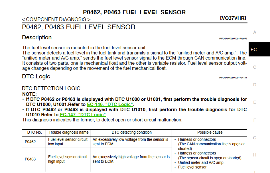

Well. Good news and "okay" news. The good news is that I am 99% confident that you do not need a new cluster.
P0462 refers to a issue with the fuel level sensor:
I take it your fuel gauge was not reading correctly?
There are quite a few threads on this issue including this thread and also this one. The "okay" news is that more than likely you need to replace the unified meter & AC amp. This is the plastic white box mounted atop your radio headunit. There are usually tons on eBay and good deals can be had. The only requirement is that the replacement part must match your car (sedan for sedan, Coupe for Coupe, no mix-and-matching). Should be a easy fix.
And, to clarify for those reading in the future, when replacing the cluster, the mileage stays with the cluster, NOT the car.
