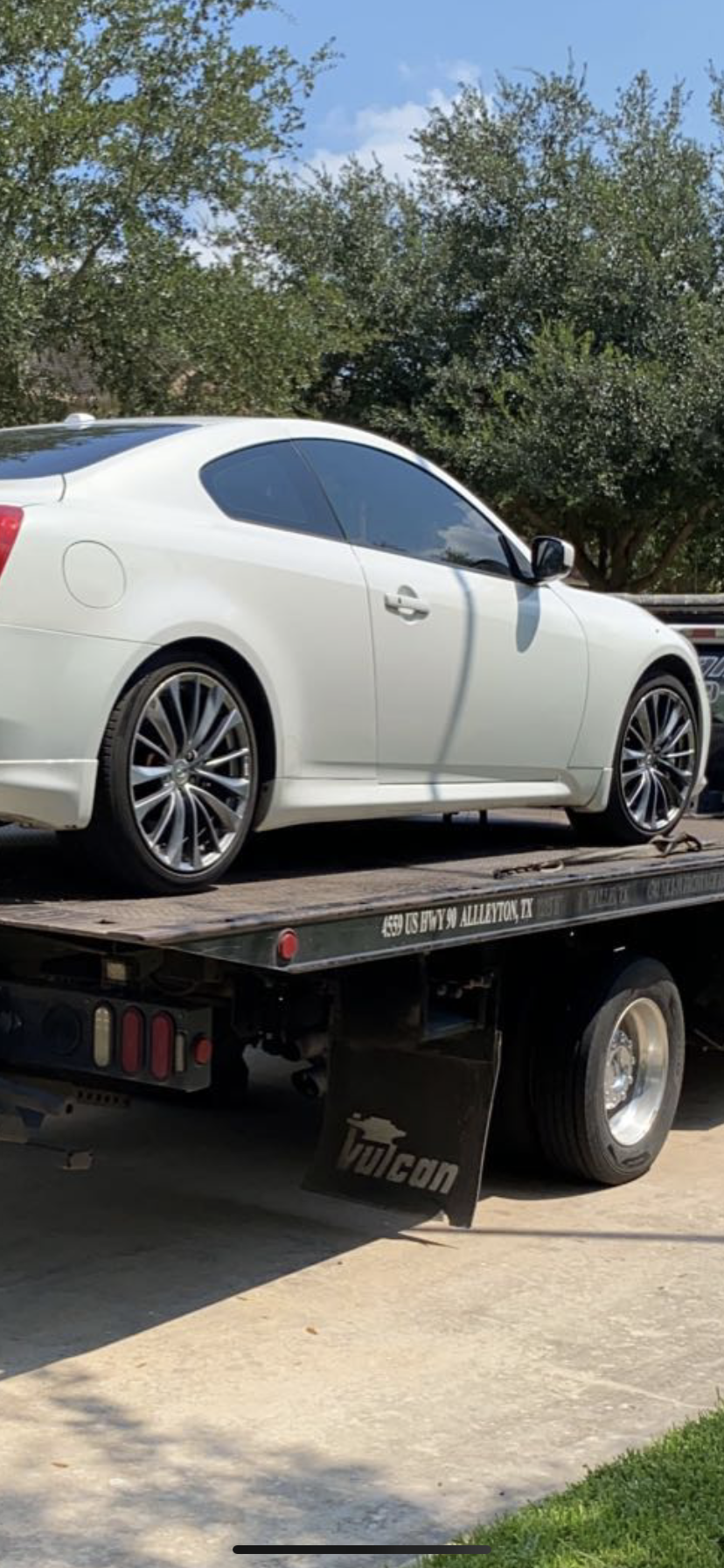

Hello guys, I am in the market for new brakes and I saw the Z26 Street Warrior Performance Kit
The kits come with the 355mm Front and 350 Rear Rotor Size if that makes a difference.
My question is if these will clear my wheels using the Factory Akebono Calipers all around ?
I have a 2013 G37S Coupe
My wheels are the Factory Enkei, I am assuming they are 19x8.5 in the front and 19x9 in the rear (I THINK)

those will fit and clear just fine with you 19" coupe wheels, and no problems with your Akebono calipers
