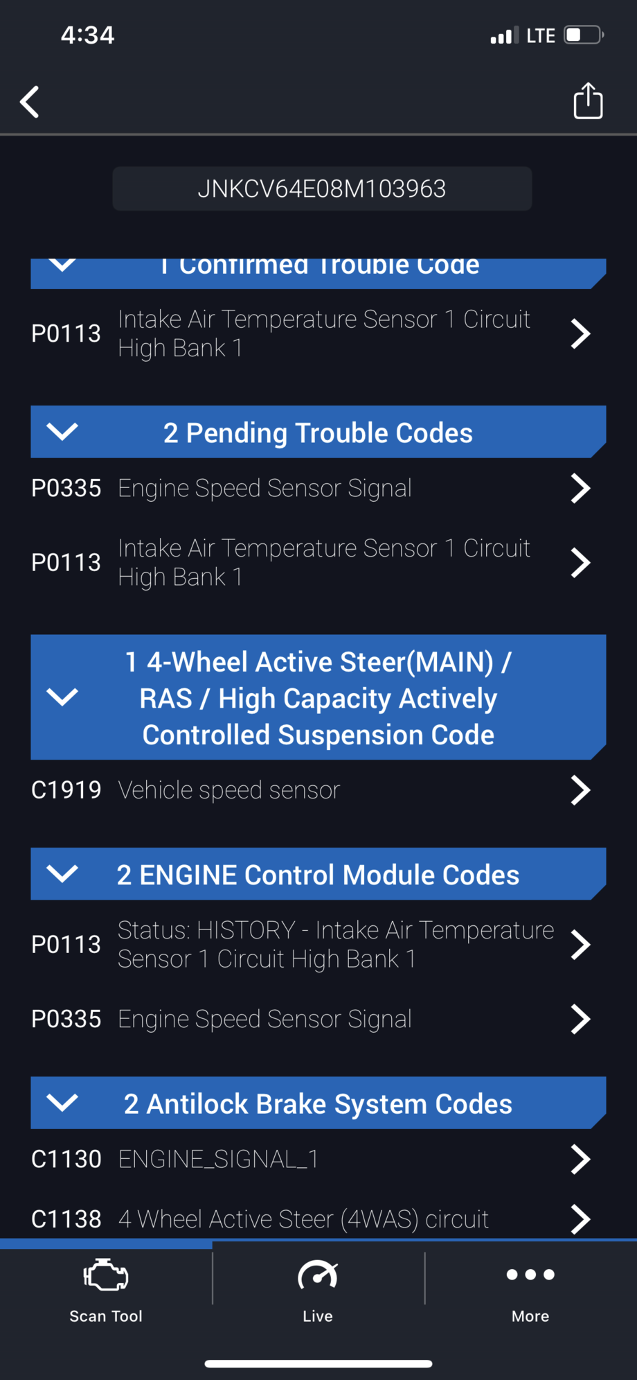

I bought new camshaft sensors, and new crankshaft positioning sensor. Still won’t turn on. Took the intakes off and sprayed starter fluid in as well... it sounds like it really wants to start but it just won’t. Checked all the connectors... even put the stock intake valve solenoids back in... and nothing. Any suggestions before I take this thing to the stealership. I re ran the codes and now I’m getting these codes

Okay so I bit the bullet and took it to the stealership so I can get a 150 dollar diagnostic.... They said the timing was way advanced to 110 degrees when it should be zero. They believe I will need a new timing chain seeing as I had already covered all my other basis. So open heart surgery it is again... They don't believe it is the sprocket so that's 500+ I'd be able to save on each so that's good news.. when I put the new solonoids on there im wondering if they advanced the timing that much.. or if it jumped timing or what. but im gonna do a complete timing chain install this weekend. should be fun.

I'm back lol. everything ripped back open and low and behold.... the "top" g37s timing chain tensioner failed. smh. new one ordered. should be back on the road by this weekend.
