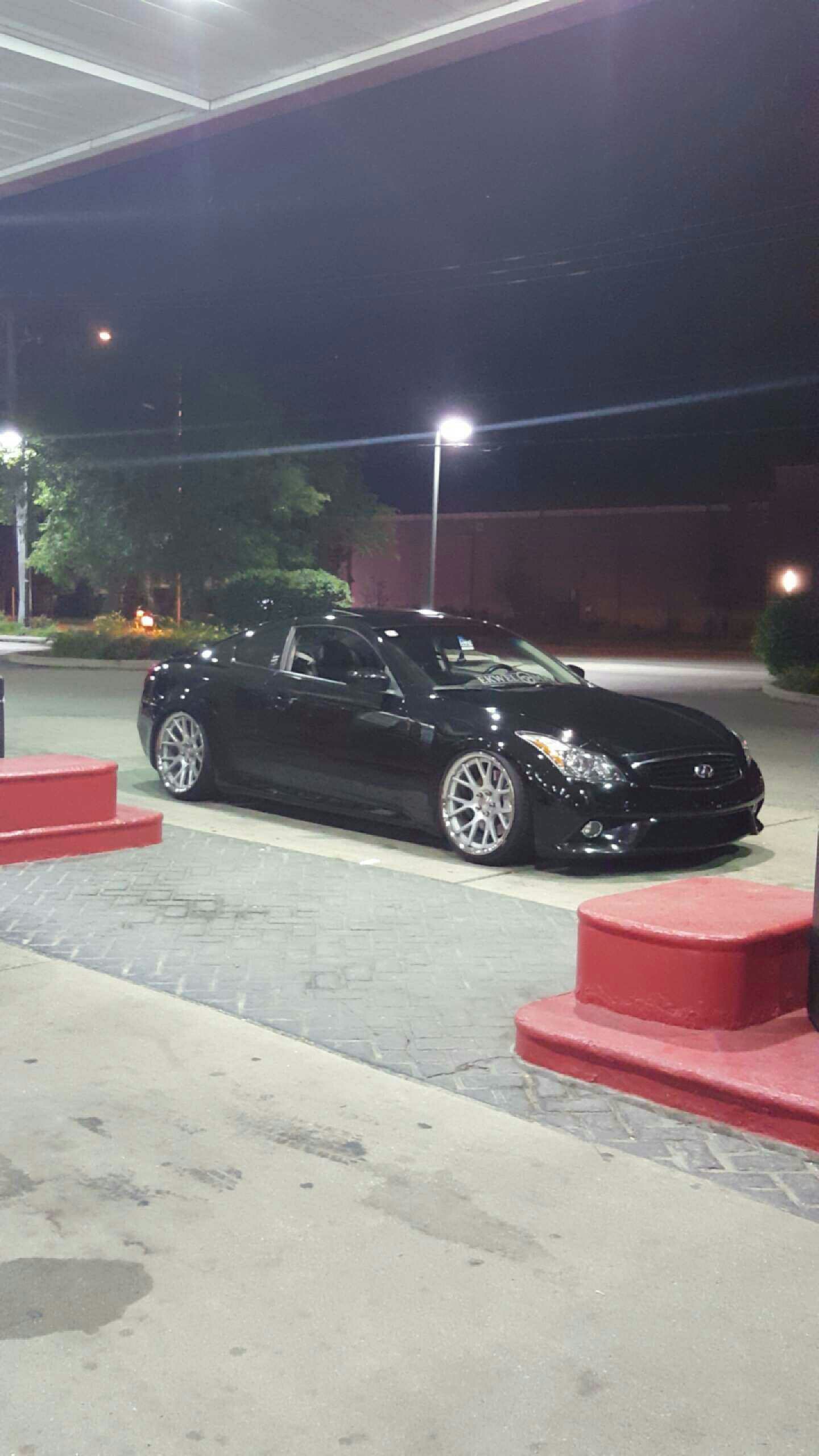

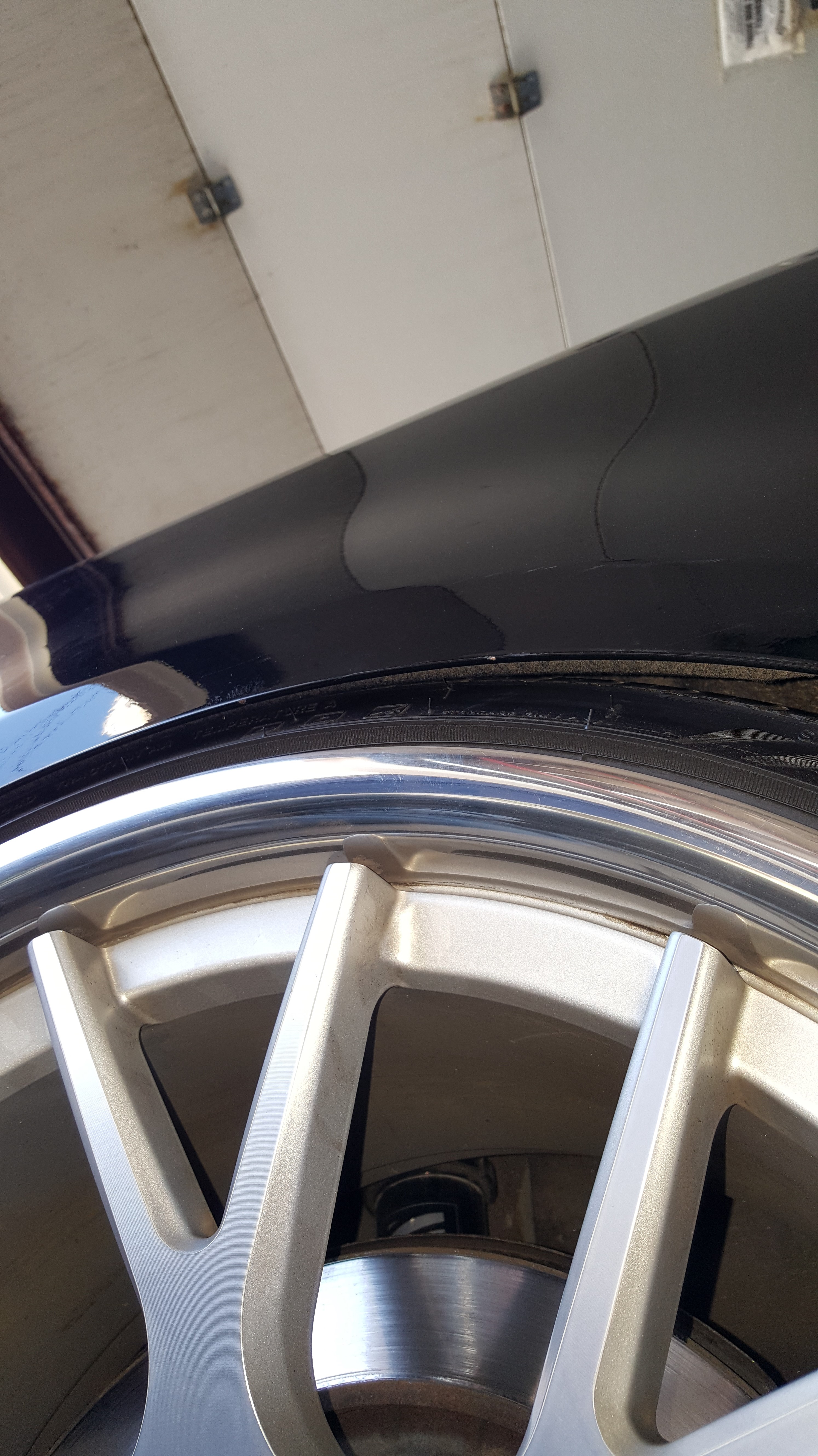

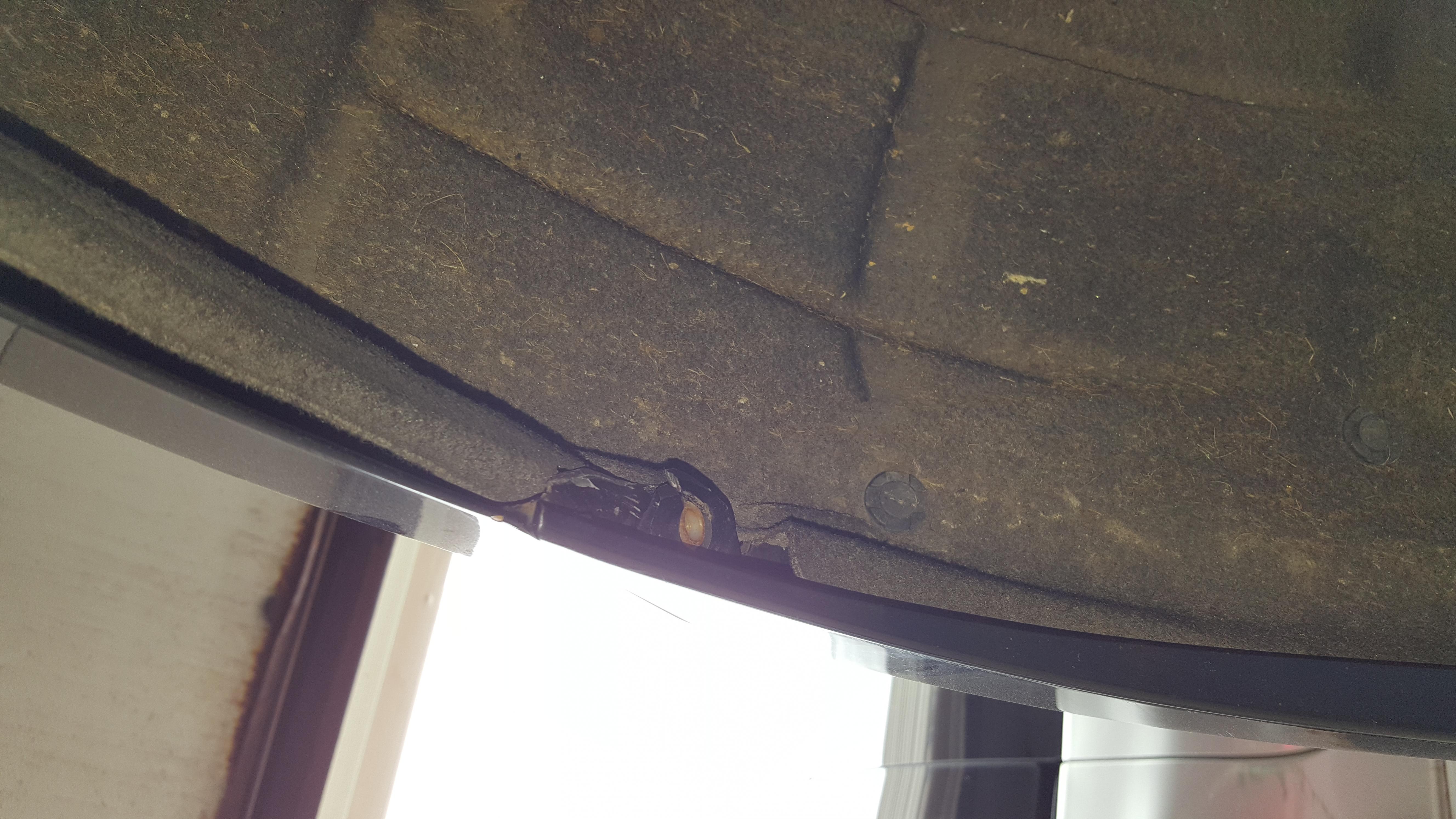

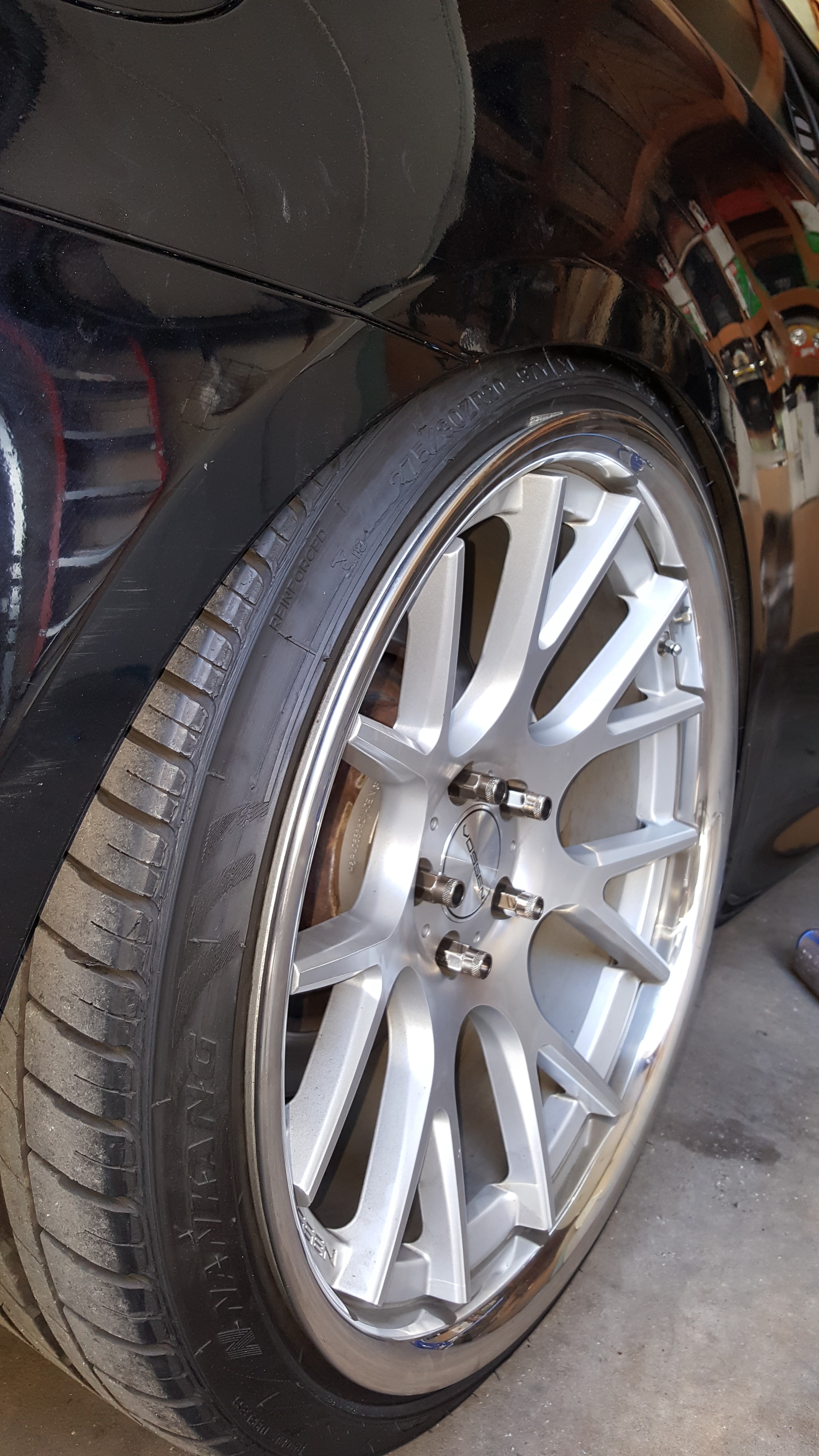

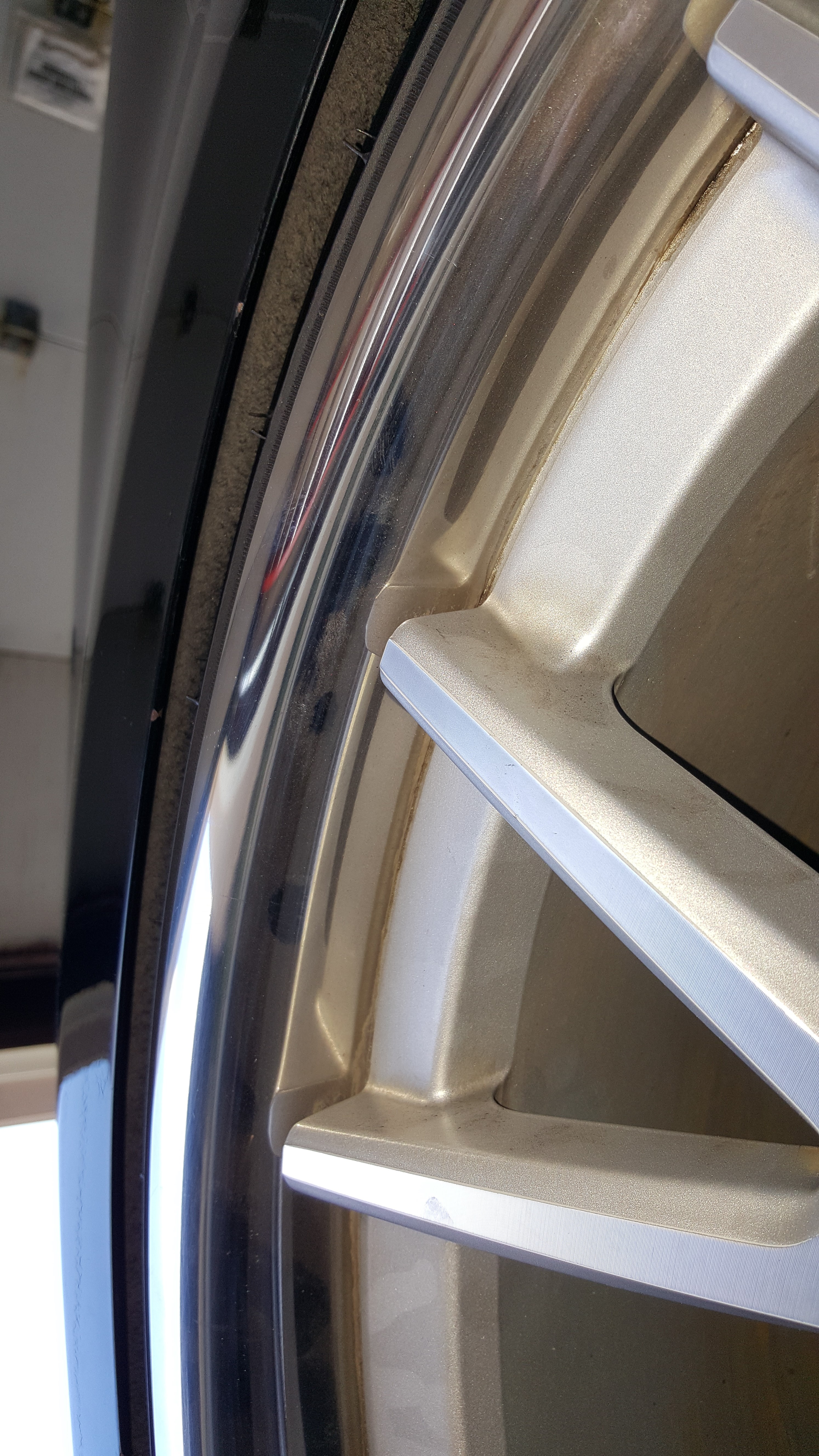

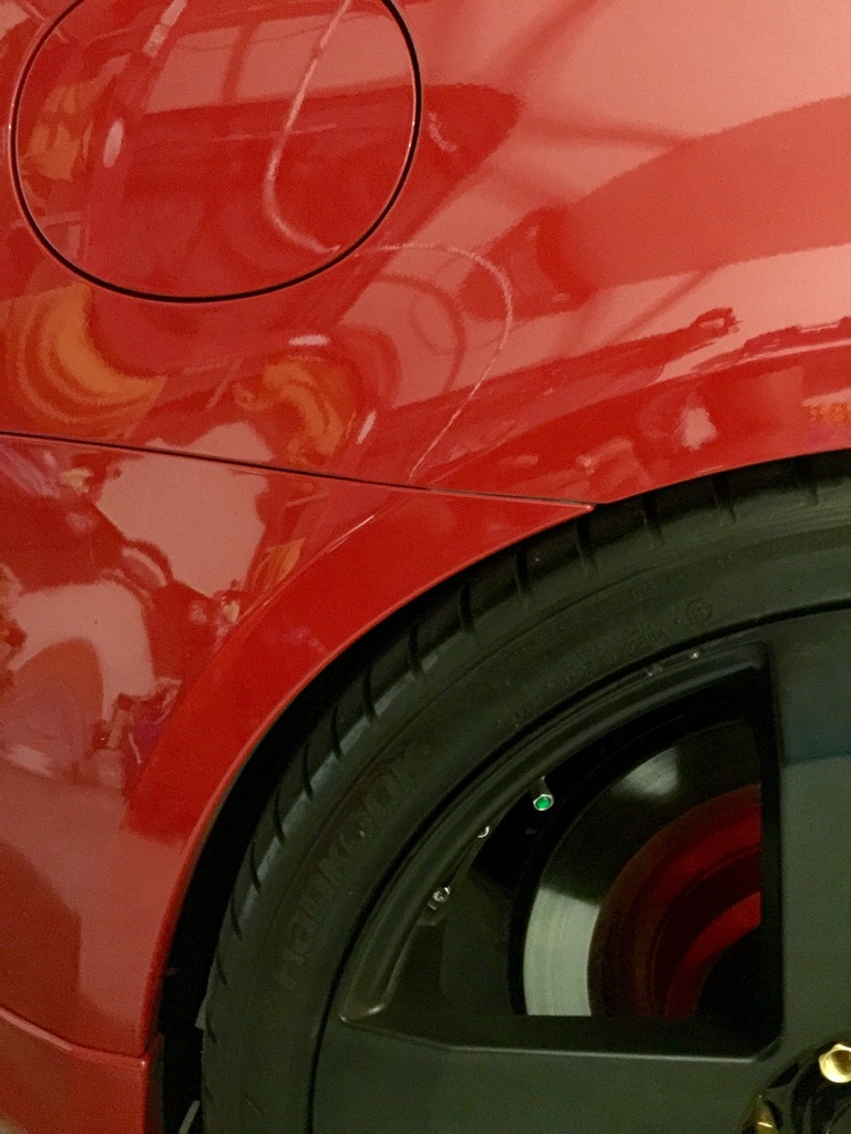

HELP: Horrible rear bracket rubbing with my new spacers :(-20160704_144116.jpg
HELP: Horrible rear bracket rubbing with my new spacers :(-20160704_144132.jpg
HELP: Horrible rear bracket rubbing with my new spacers :(-20160704_144142.jpg
Trust me trimming them down with a dremel with be the best thing you've done lol... please post up pictures and specs of the wheels! I was considering switching to 20mm spacers.
My wheel specs are...
20x9 +32
20x10.5 +45
With 15mm spacers all around.
Hey Kenny,
I didn't get to cutting the fender bracket and cutting a few inches off the wheel liner. I decided to spend some time with the family instead. I'll get to that this weekend though. Here are some pics I took. I just got these vossens from my buddy since he just got some sweet ag's. He had them on his g37xs sedan.
I have 20mm spacers all around. If you want anymore pictures of a certain angle just let me know. BTW My rear spacers aren't on in the pic that shows my full car. Hope this gives you a pretty good idea.
Specs: 20x10.5 +45 all around on some 275/30/R20.

Thanks for the pictures manny... and I can definitely see why you'd be having rubbing issues lol Best of luck with the bracket trimming and if you need any help just let me know!

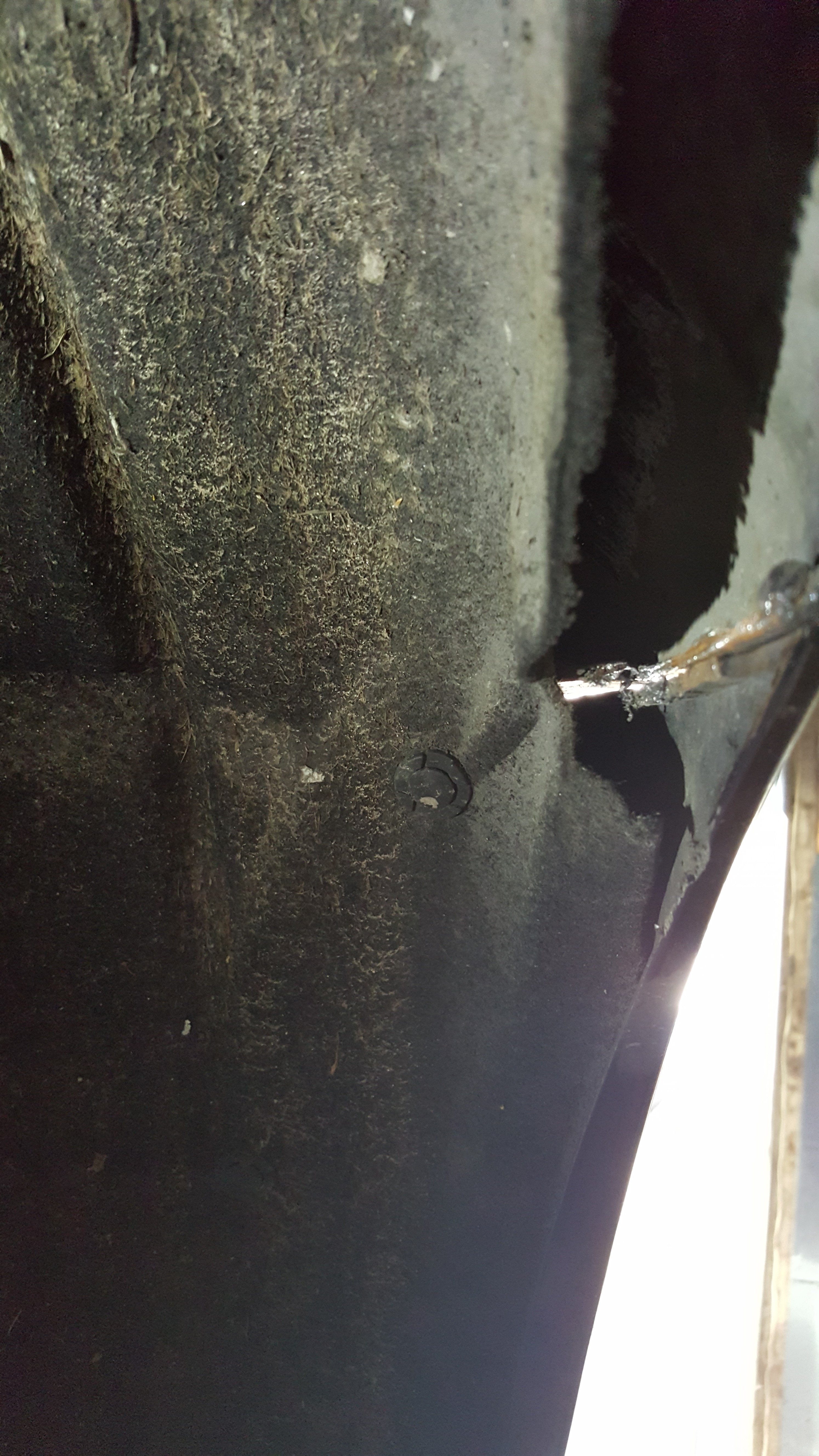

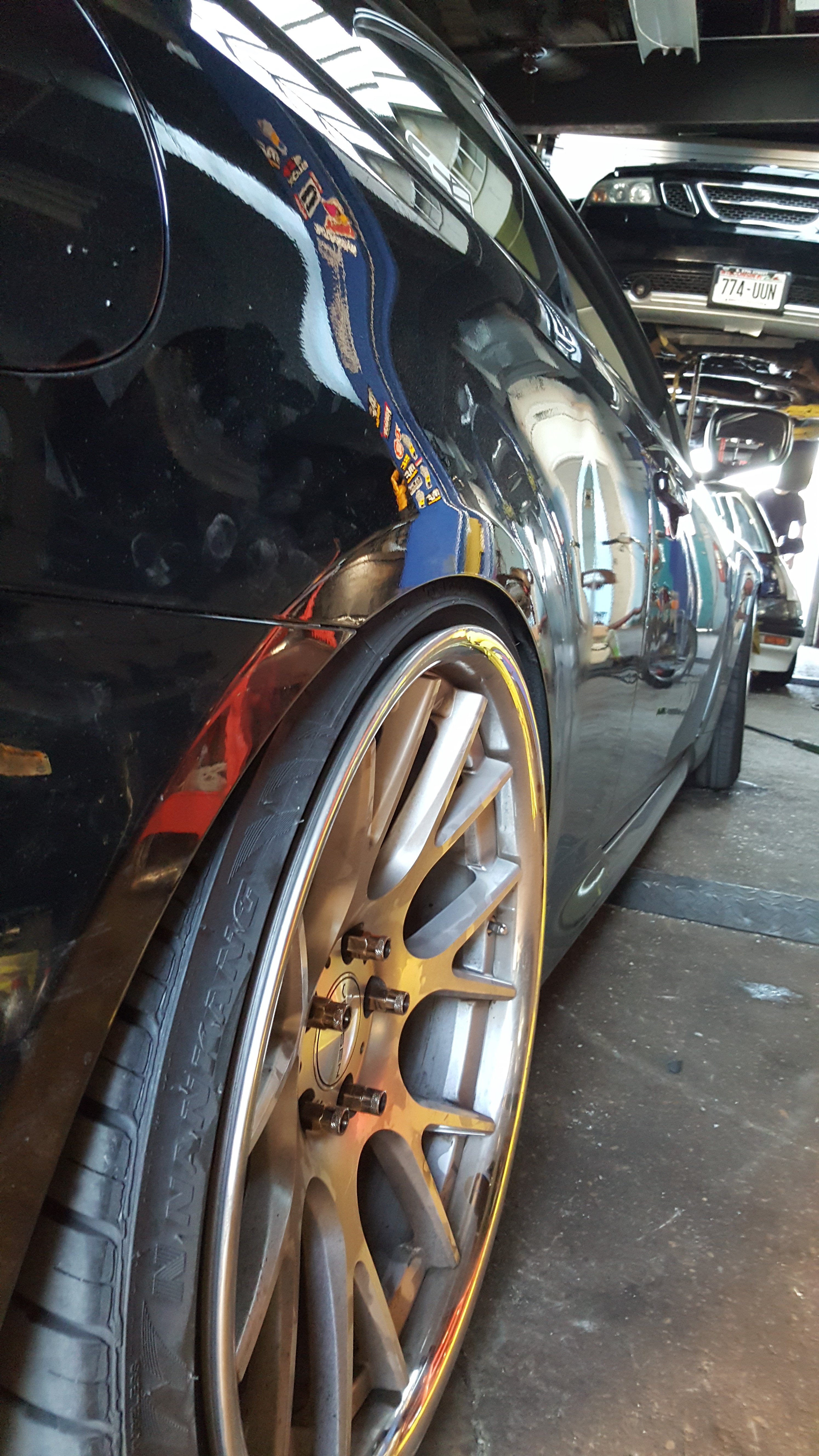

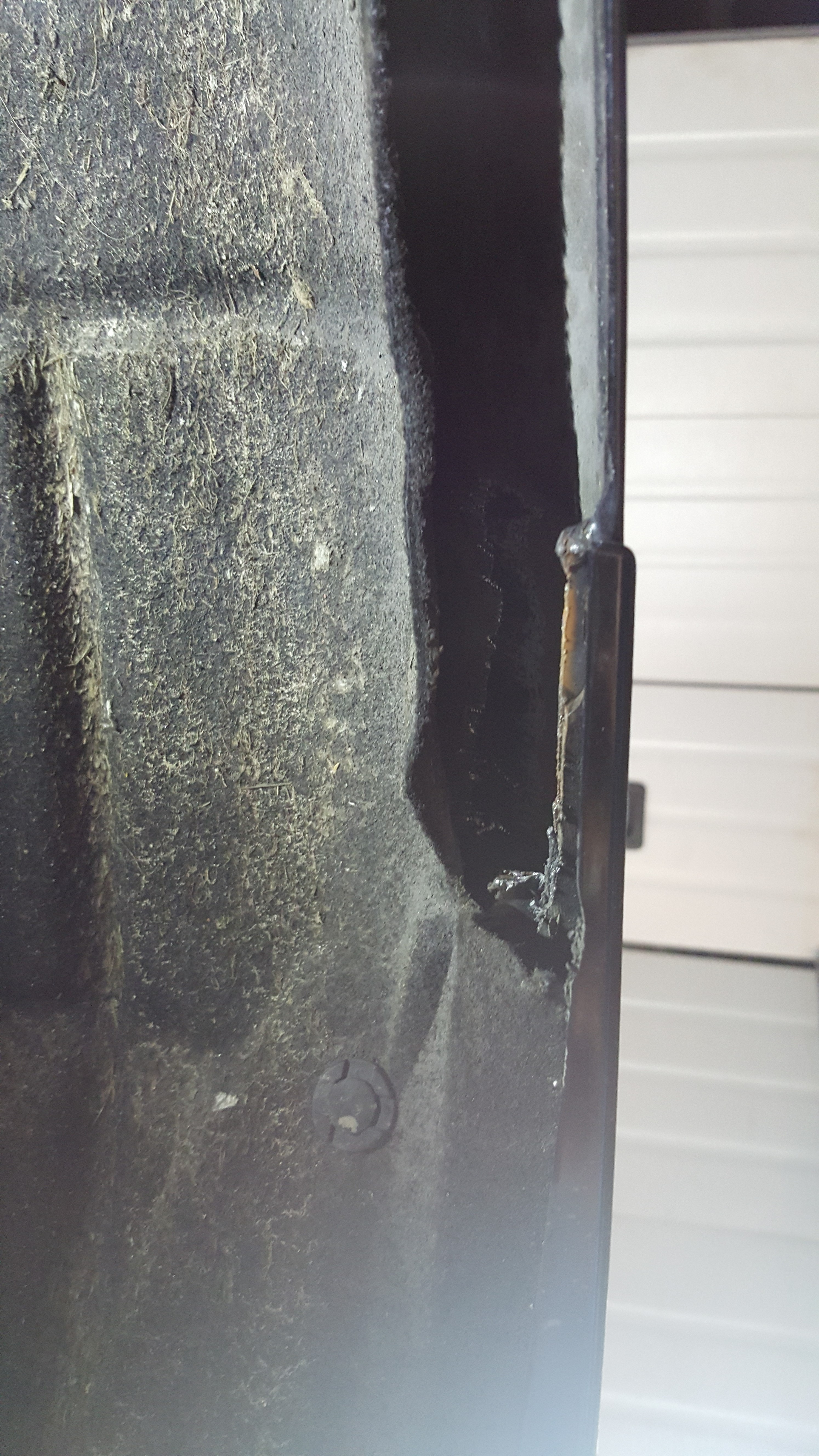

Thanks for your advice and help Kenny! My friend and I cut the whole bracket off with a sawzall. I used to 3m double sided tape just in case the nothing would come loose. Everything seems to be holding up fine and best of all, my 20mm spacers are on there and I am very happy with the results.
I also ripped off part the wheel liner where the tire was rubbing.
Attached Thumbnails HELP: Horrible rear bracket rubbing with my new spacers :(-20160722_191612.jpg   HELP: Horrible rear bracket rubbing with my new spacers :(-20160722_184850.jpg   HELP: Horrible rear bracket rubbing with my new spacers :(-20160722_184841.jpg
