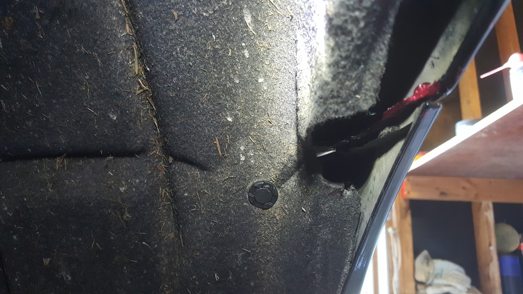

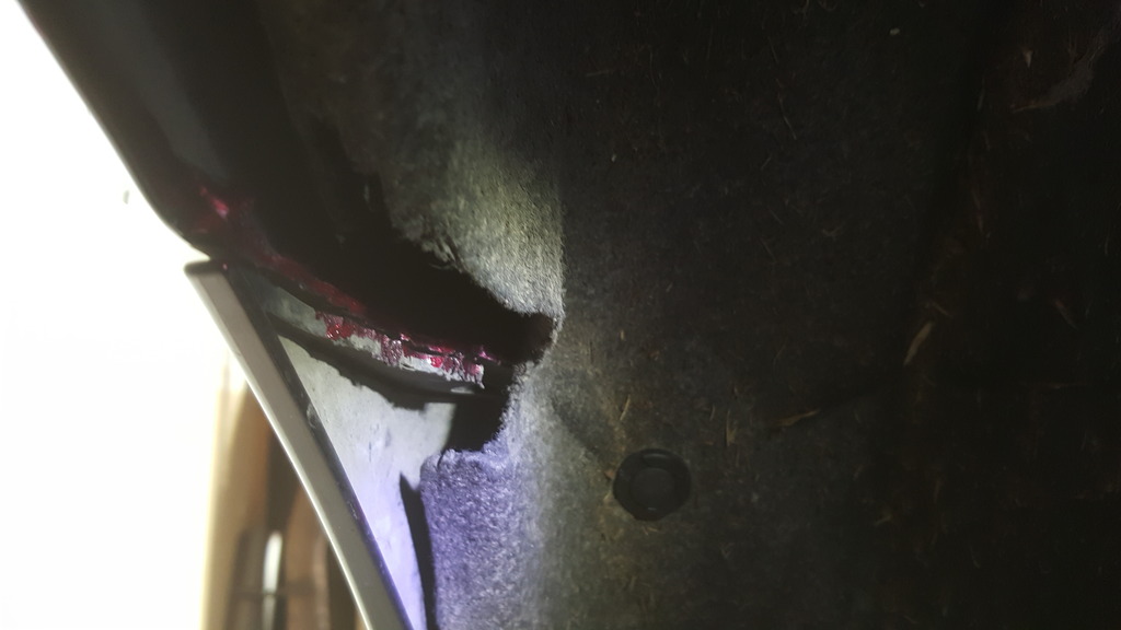

Kennys issue pursuaded to get mine taken care of. Hopefully i cut enough and am still able to get a self tapping screw in if the bumper doesnt stay put but for now it is tight and doesnt move at all.
Size:  82.7 KBName:  20160410_180358_zpsy4oql7az.jpg
Paint job isnt pretty but its functional
