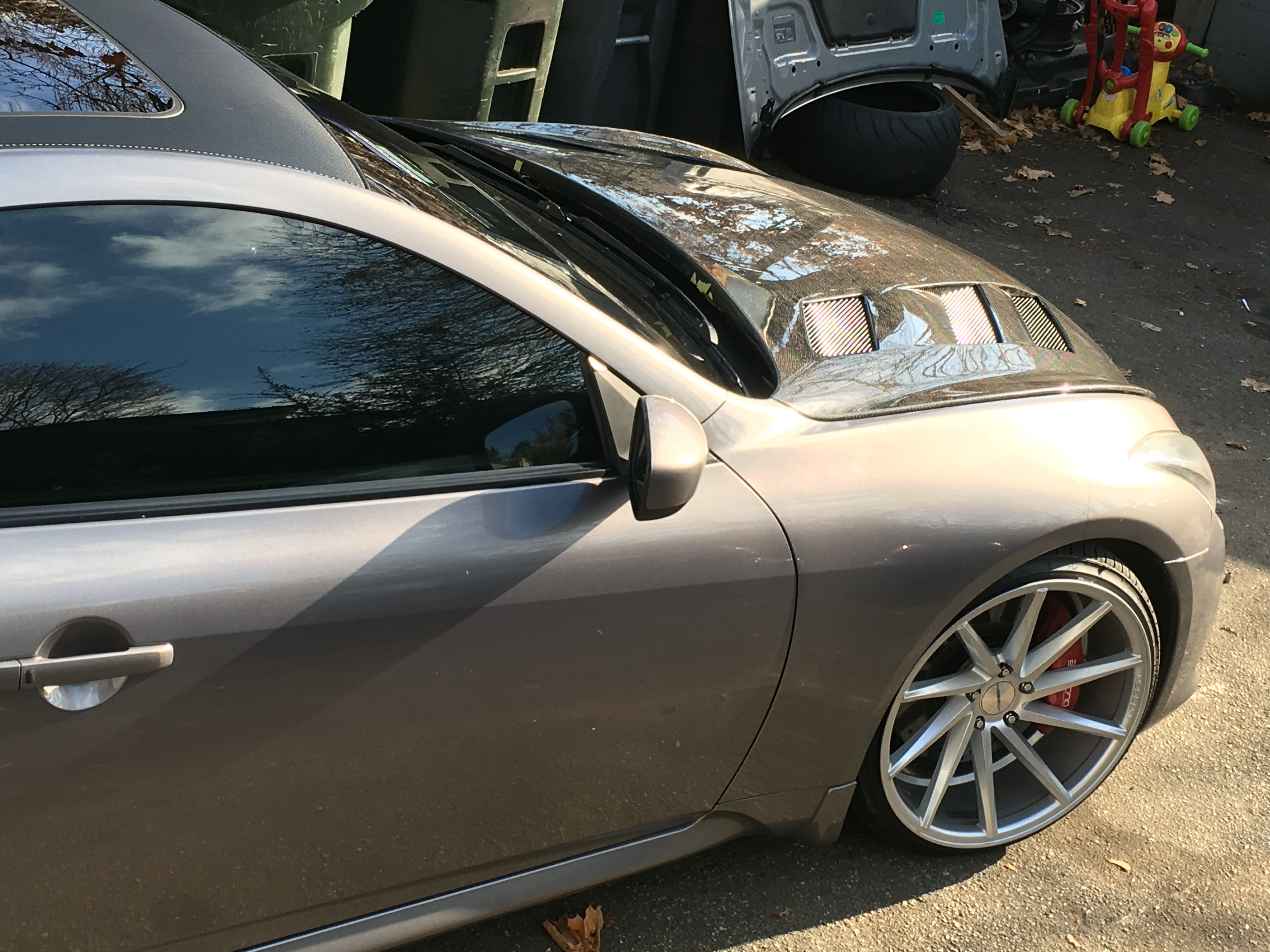

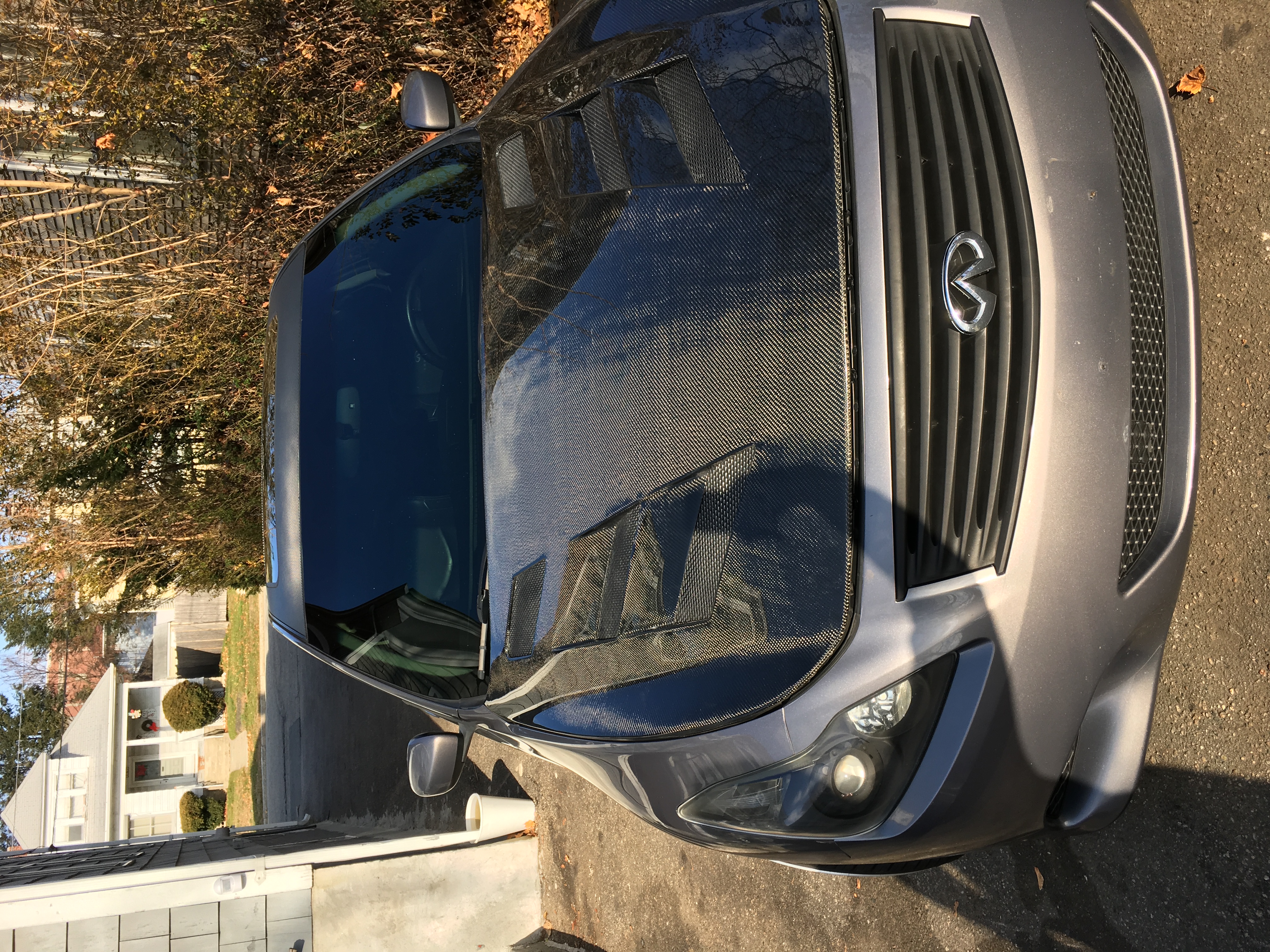

All the other hardware bolted right up. Except the latch on both sides. The hood was never installed because he thought twice about it. He also had a complete ILP kit still bubble wrapped that he also included with the sale, Along with tons of extra new parts. The car was a project that he lost interest in

smh... dude my oem latch are NOT cross threaded there is nothing wrong with my threads at all, The cut outs on the ams hood is larger than the oem bolt we discussed this already as well i believe 4 times in email. How can I explain this in a way that it is "appropriate"....my oem latch= my shoe size 9.5 my wife buys me a Size 11 sneakers. The AMS hood thread cut= shoe size 11 my feet wont fit a shoe size 11 my feet is loose in the sz 11 because I wear a size 9.5My oem latch= 9.5 in a sneaker size
AMS hood cut thread= 11 in a sneaker size
The pics speak for themselves I sent you these pics already through email awhile back. You also said the threaded ends that are glassed do not come from you guys but the pics you posted shows they ARE threaded so who is threading these? And you dont know the bolt specs to this thread? Have not answered that yet. Also I will repeat it again, My ams hood was never installed. NEVER til the day I tried and that was when I noticed the latch slid right up through the ams thread. The hood can stay in the dungeon for all I care Im just hoping this will not cause a headache for other potential customers you may have. However I did want to mount it when going to car shows/meets
