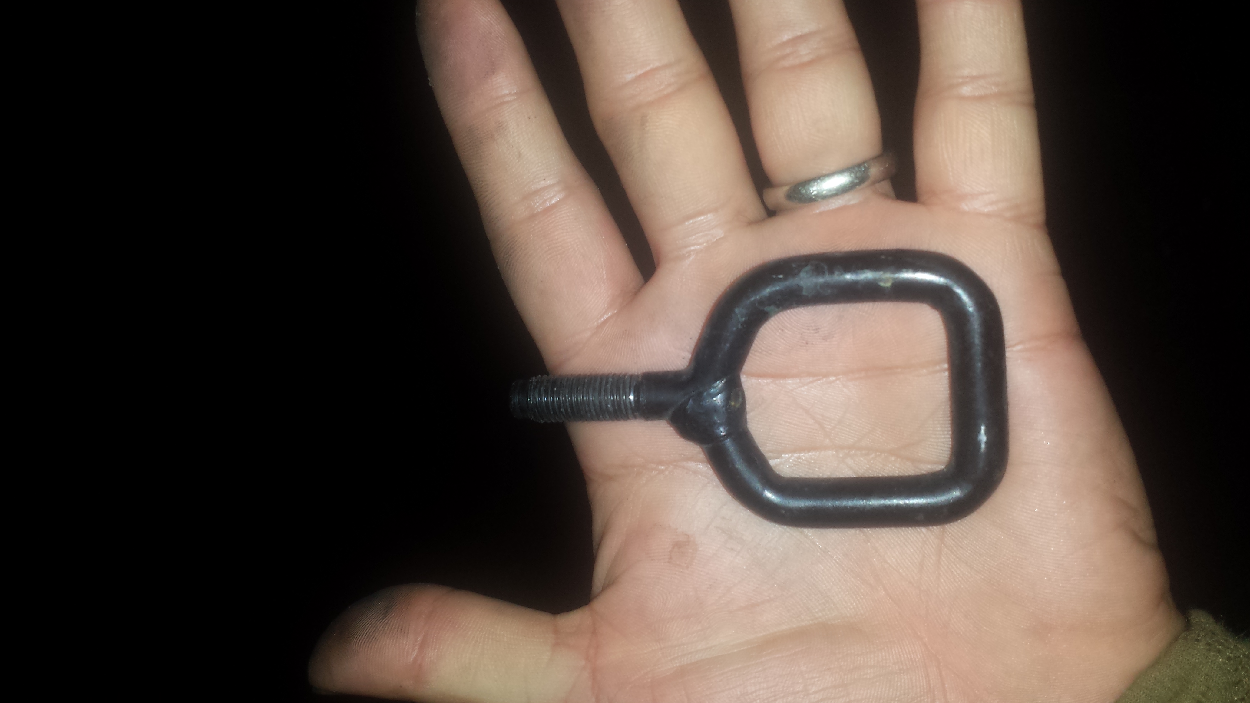

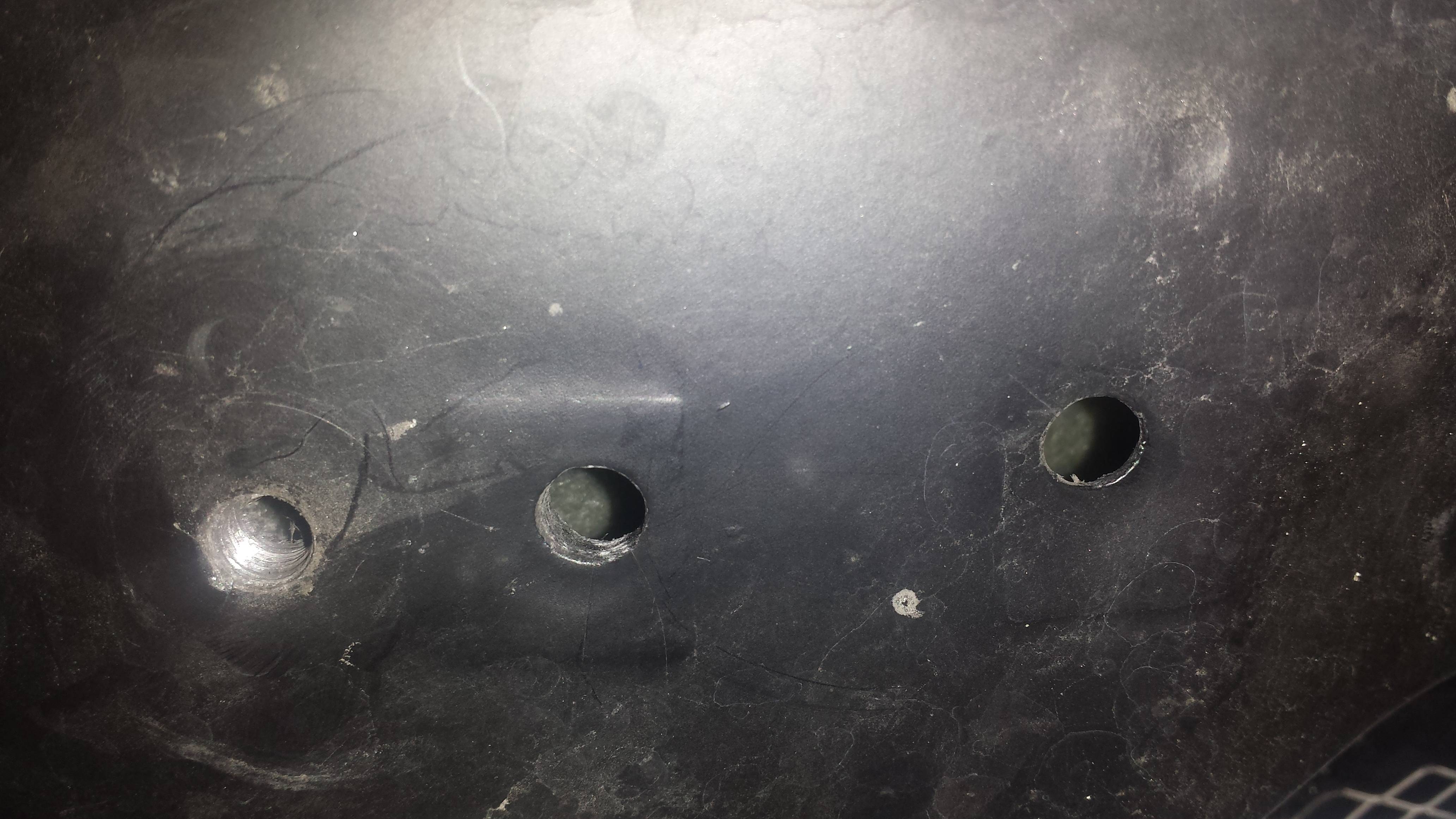

Those will work but a heads up. They will need to molded into the hood or bolted on. I would go with the latter. I could not find the ones used by siebon, vis or any composite hoods. As with mostly all aftermarket products, its recommended to have it installed by an experienced shop or installer.
The s/n is a play on my first name and nick name.
Attached are the strikers for hood that I have.

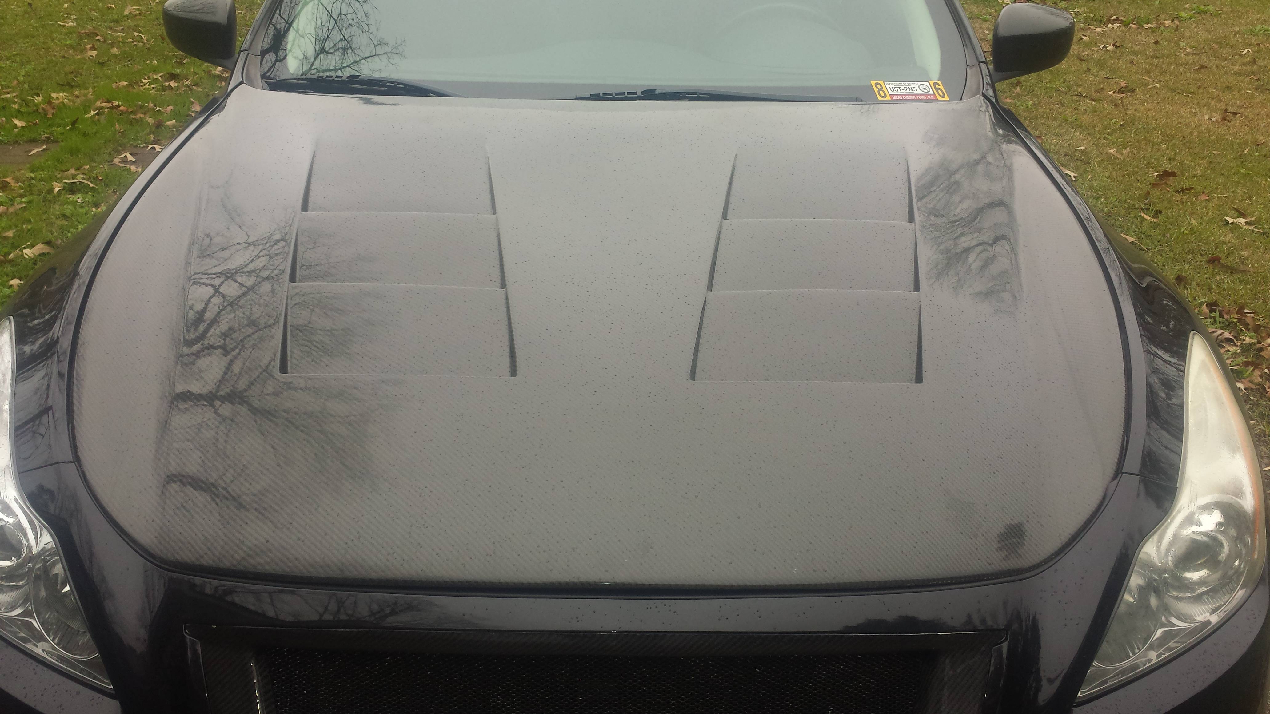

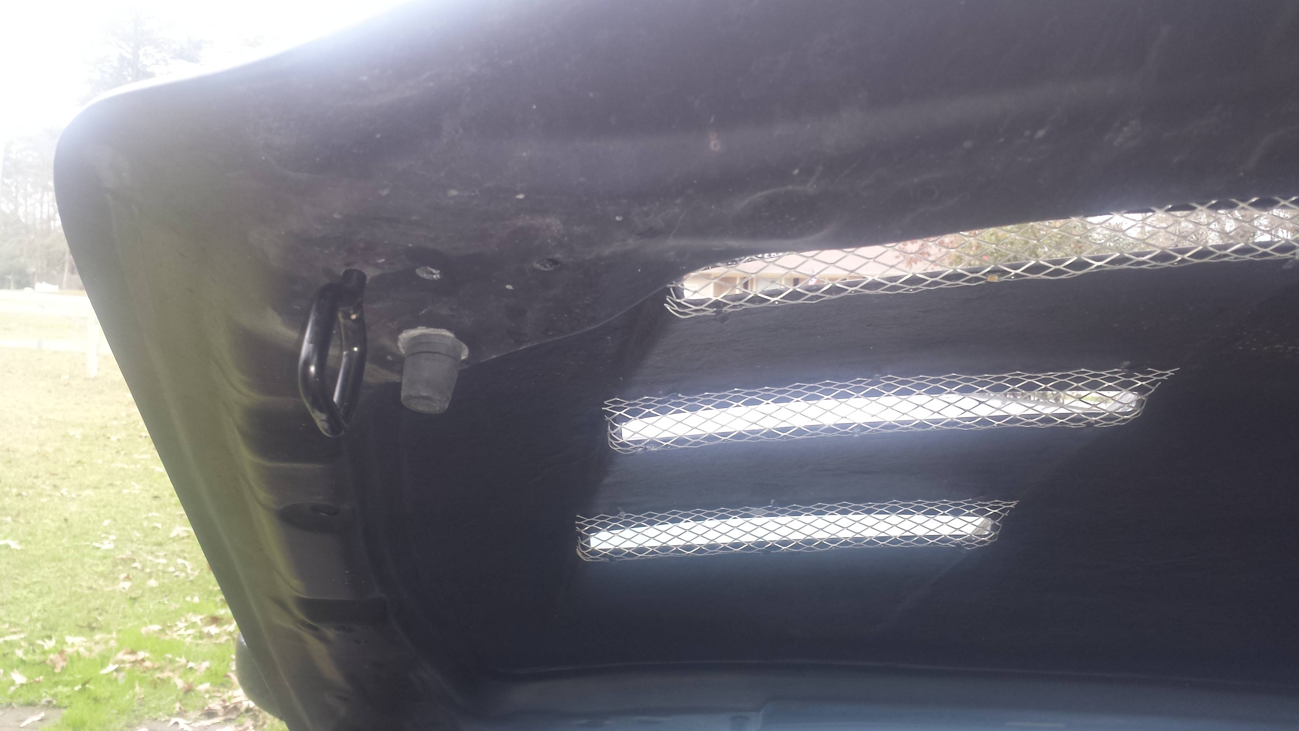

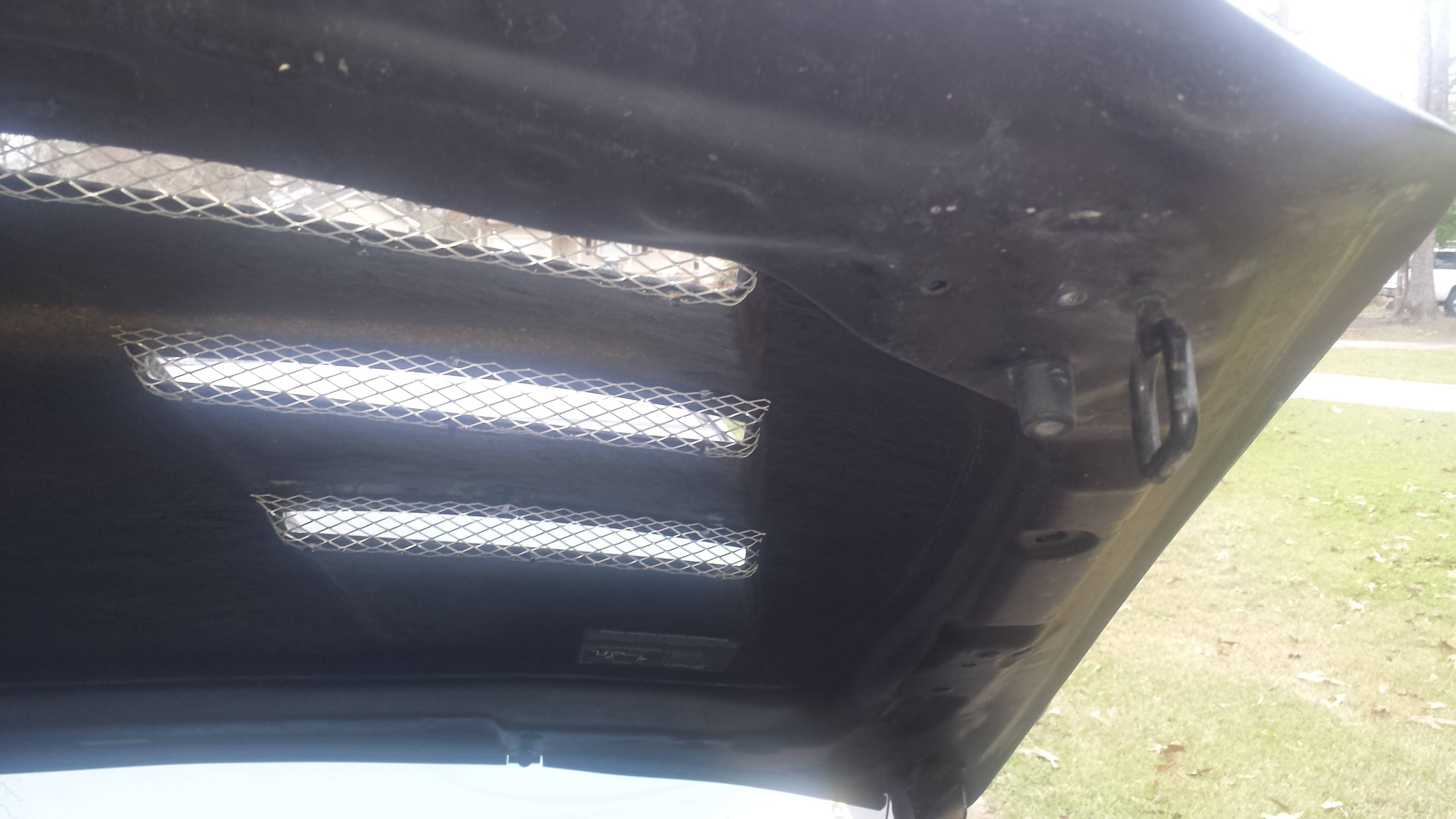

Would you post pics of your hood to show fitment and under the hood where these strikers are mounted?

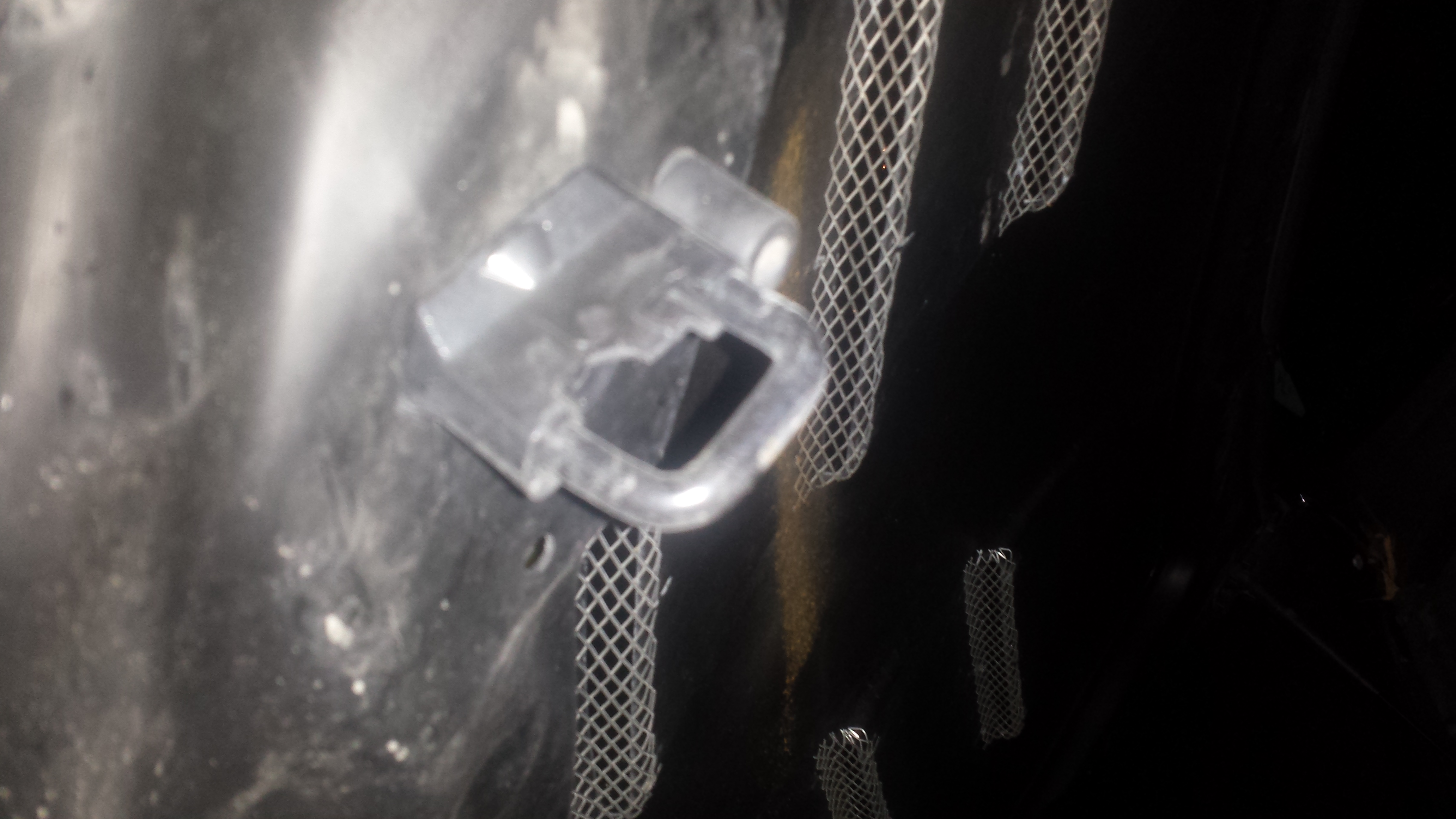

The hood that I have is a siebon hood. Can't say for sure about the vis hood but should be of same construction type. You will notice that on the last picture there is a helicoil insert type for the strikers to thread into. This is the most outboard hole on either side of the hood. I'm trying to locate a source to get the strikers alone.

Thank you so much for not only the initial explanation, but to elaborate and provide pictures too. It helps me to know, and for any other member that could potentially run into this problem.

bro the "vis" hood has like two holes on each side. one is threaded the other isnt, which is larger than than the OEM latch apparently VIS "doesnt know what im talking about" why should I take my time out to buy or fabricate a striker/latch because they failed to provide such a simple hardware? Can make a carbon fiber hood but cant thread it to the OEM specs then sells it to costumers and not tell them about it sounds legit? Reason i am supposedly the "first" customer with this issue is because they mostly sell to companies that sell them to their customers and they have no choice but to fab up the latch in order to "sell" the item and please the customer. they wont order a customer a hood install it half assed leaving it not locked to the car drive off and it pops up in to their windshield leaving them liable of course they are going to do whatever it takes to install it right. My hood mustve been purchased direct on their website leaving the purchaser stranded for all i know and left me with the headache when I bought the car. Makes sense doesnt it?
