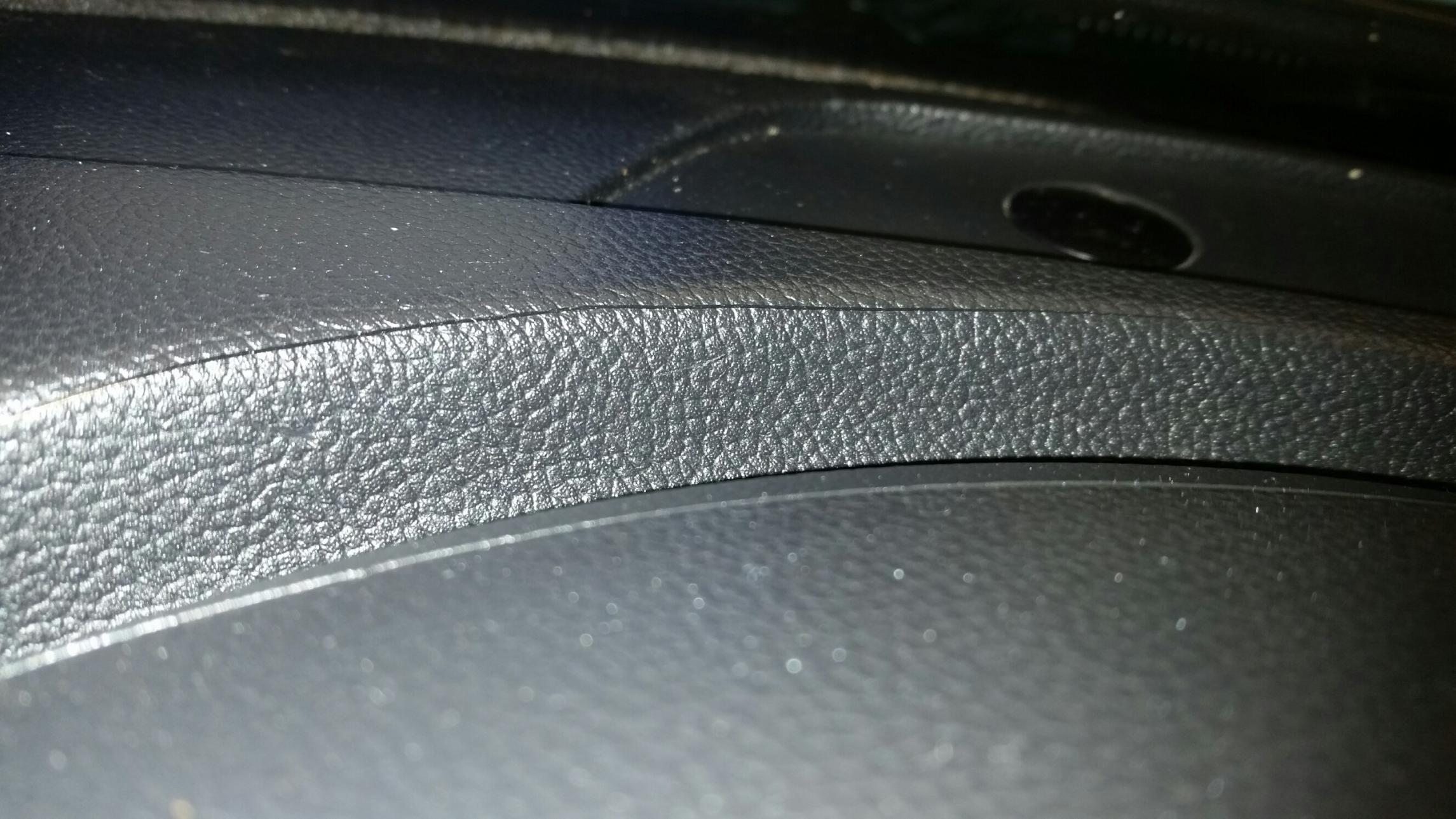

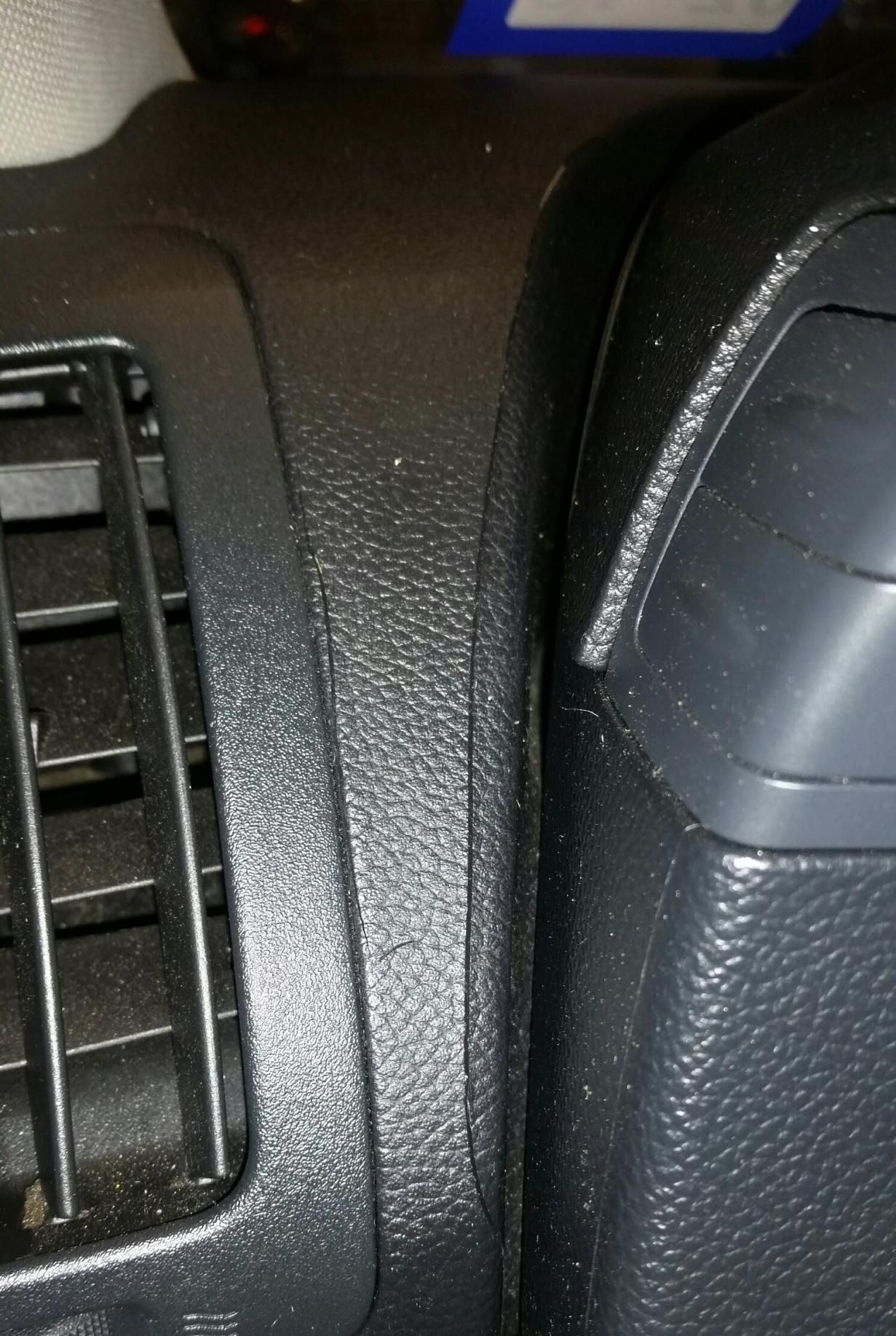

Mines cracking too, but I've never touched my dash other than to clean it with a damp cloth.
Attached Thumbnails Dash is cracking-dashboard-above-steering-wheel-1.jpg   Dash is cracking-dashboard-above-steering-wheel-2.jpg   Dash is cracking-dashboard-left.jpg
