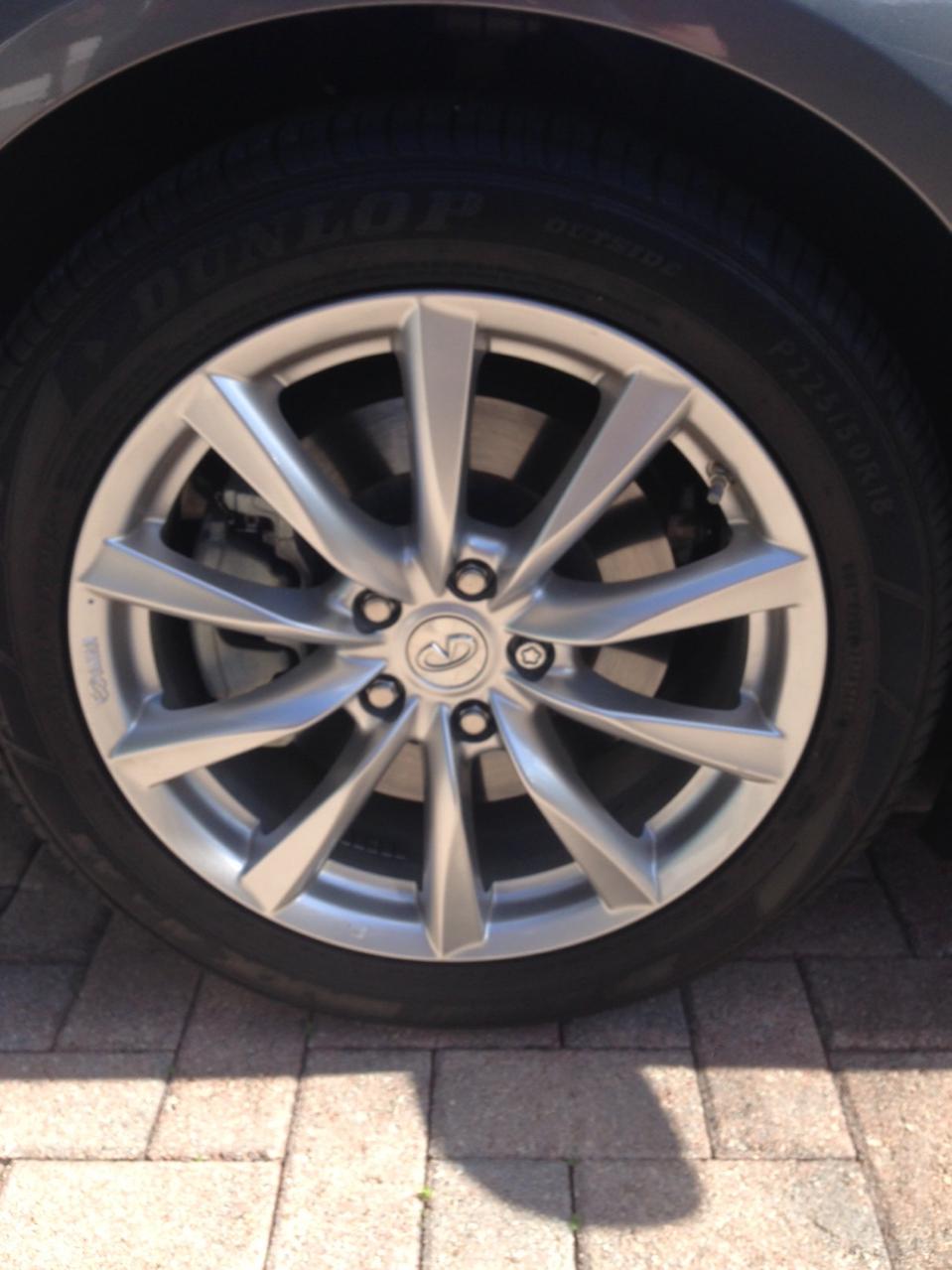

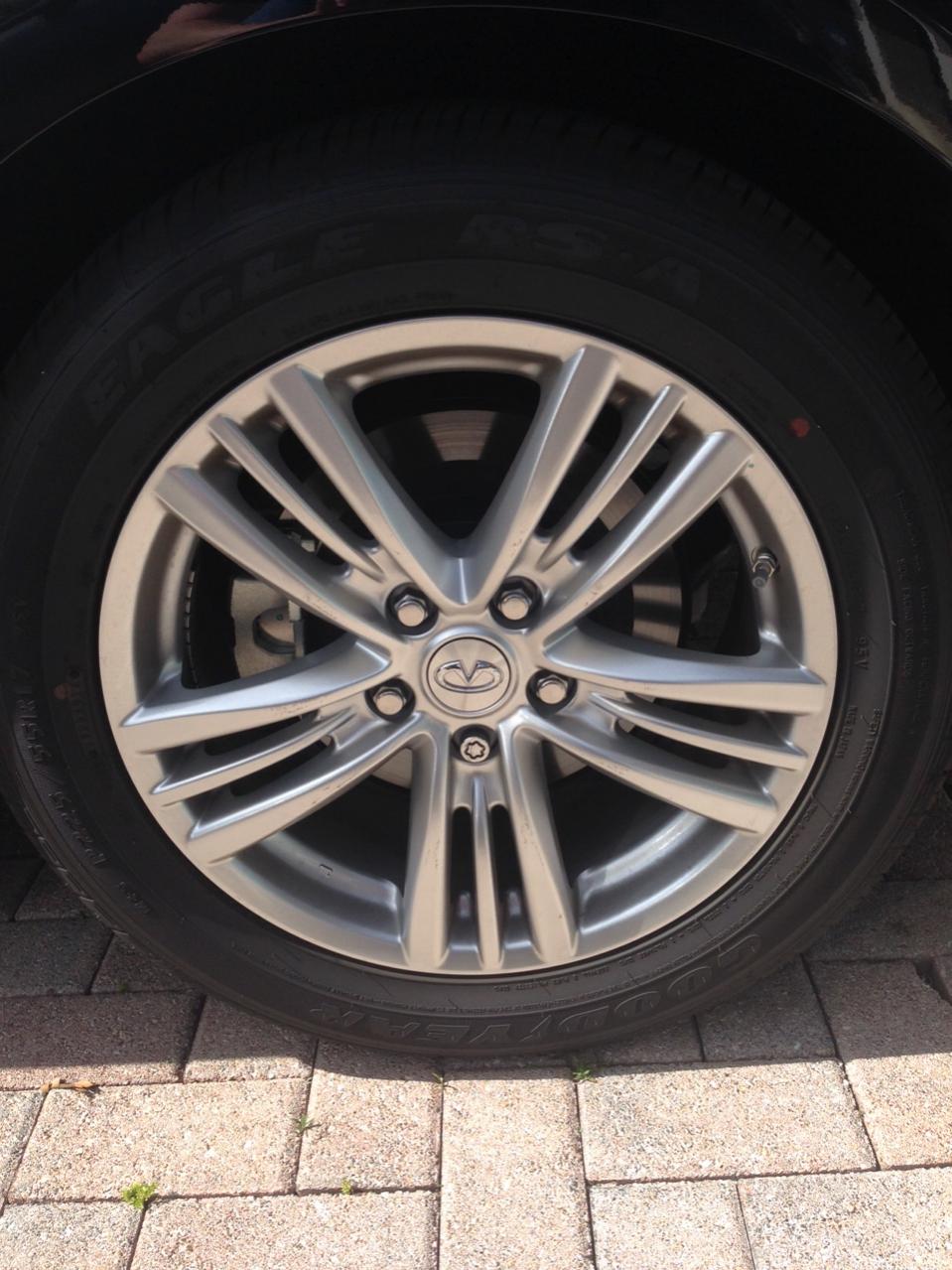

2015 G37 journey sedan is stock Goodyear eagle rs-a P225/55/r17
2013 G37 Journey coupe is stock Dunlop P225/50/r18
I did not want to cause any confusion or anything.
I noticed my sedan had a light feel and needs driver adjustment imo going straight.
The Coupe has a noticeable tight & firm feel when steering, as in more force is required to change direction. Plus does not need adjustment when going straight.
So I just thought I would ask if there was a known difference that would cause this. Like steering ratio difference but that would only apply to a sport model which neither is and was unavailable for the 2015 sedan.
My conclusion is I believe the 18"s are 8.5 and the 17"s are 7.5 the added width might be the cause of the tighter steering.
Thank you
EDIT Did not want to post again for this update. Turns out all the tires were cold 12lbs overinflated since I got the car. Correcting the cold tire pressure to the recommended amount has helped the issue I was describing.
Attached Thumbnails Why is steering feel so different between coupe and sedan ?-img_2997.jpg   Why is steering feel so different between coupe and sedan ?-img_2998.jpg
