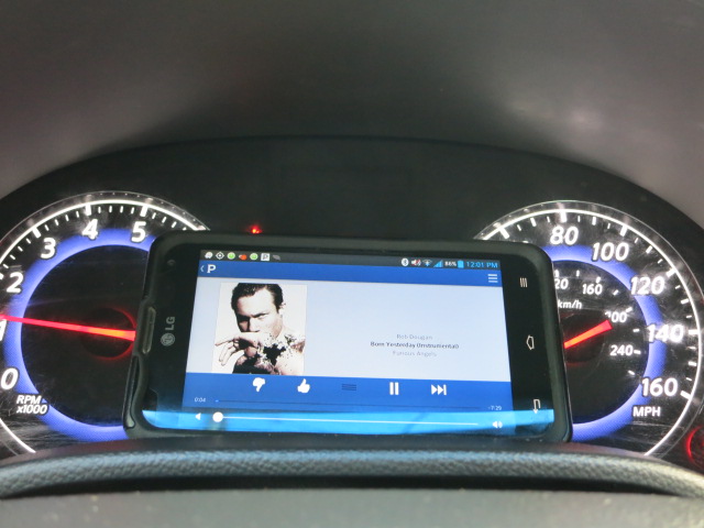

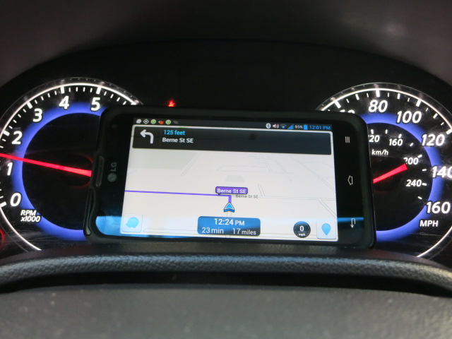

My phone fits - and stays perfectly in the center of the dash in front of me above the steering wheel - so that I can see the phone Navigation, Waze, Pandora, or whatever.
