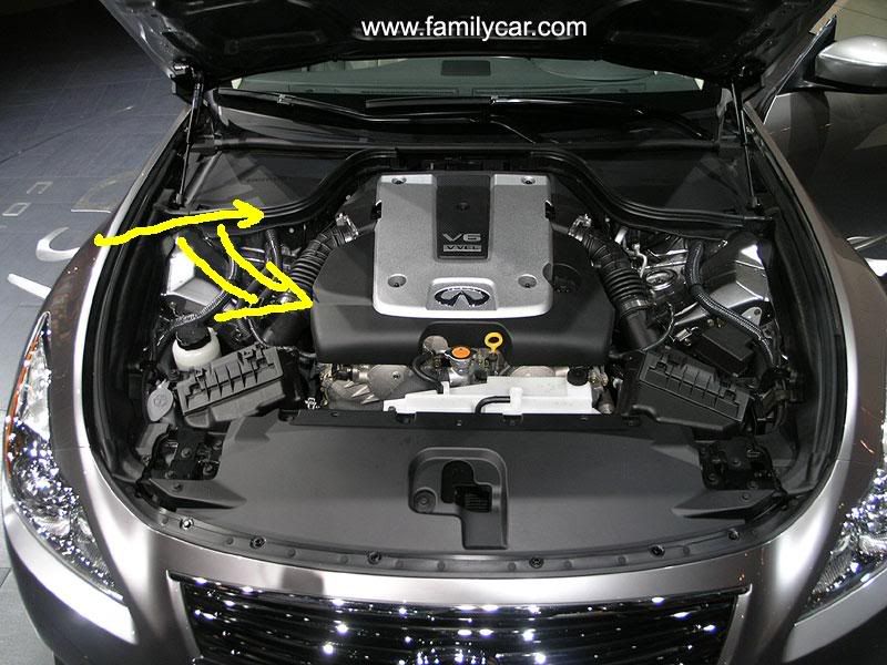

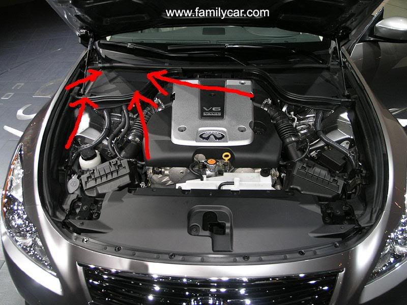

um ok so u pop off the battery cover, then there's 4 plastic snap locks u pop off with a flat head, then the u move it over and u can see it's attached to the rubber water catcher barrier thing to ur windshield, jsut slide over so that ur battery area is completely open and should be self explanatory from there

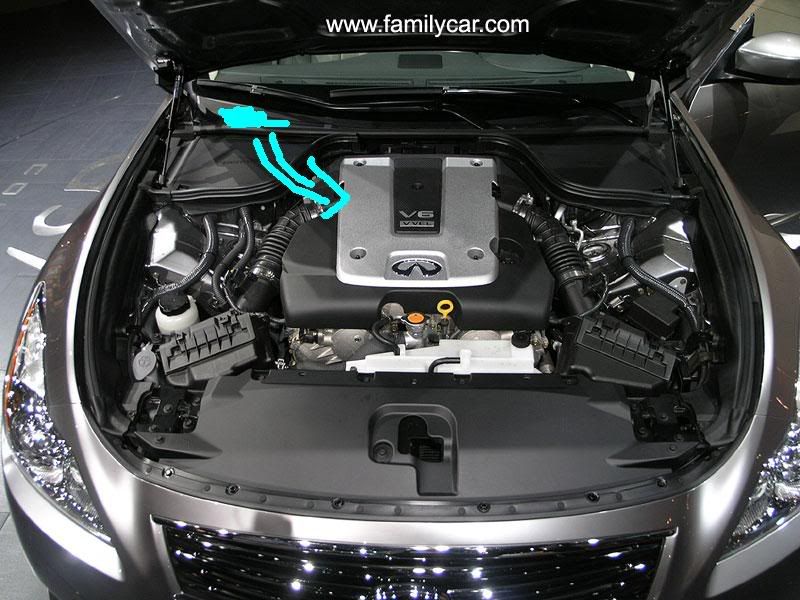

after u open the battery compartment, u'll see little plastic pop tabs, insert a flathead and twist the flathead so that it pops out and remove, forgot i think 4, or maybe 3 of them
now once those are popped off, move the things it was connected to, over basically opening the area where the battery is
last step is i think 1 more pop tab, and then move over this last piece to completely access ur battery, it's the piece that kinda shields water from the windshield from getting into your engine bay
it's really more complicated than it sounds, i also asked for a DIY when i wanted to remove my battery, but then when i looked and messed around, it was way easier than i thought, gl!
