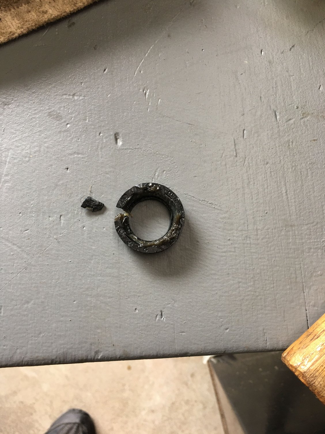

Thumbs up just did Left flipper door-Dranik gear (didn't know about Guy when i bought this
Couple thoughts:
top down, trunk open, place a towel under the area you will be working to prevent things falling as well as protect hood which you will be leaning on
i did this method-only drilled out 4 rivets-removed flipper before starting. Only hassle was lining up drive shaft from motor to the gearbox on reassembly-you will need the #1 square drive to line things up
you can see the piece of plastic in my pic-found this in gear box "hiding" in grease. use a small flat head screwdriver to search for these when you get it apart
seems to be working well so far and will be replacing right side soon. it makes the racheting sound like the left did for months before finally failing

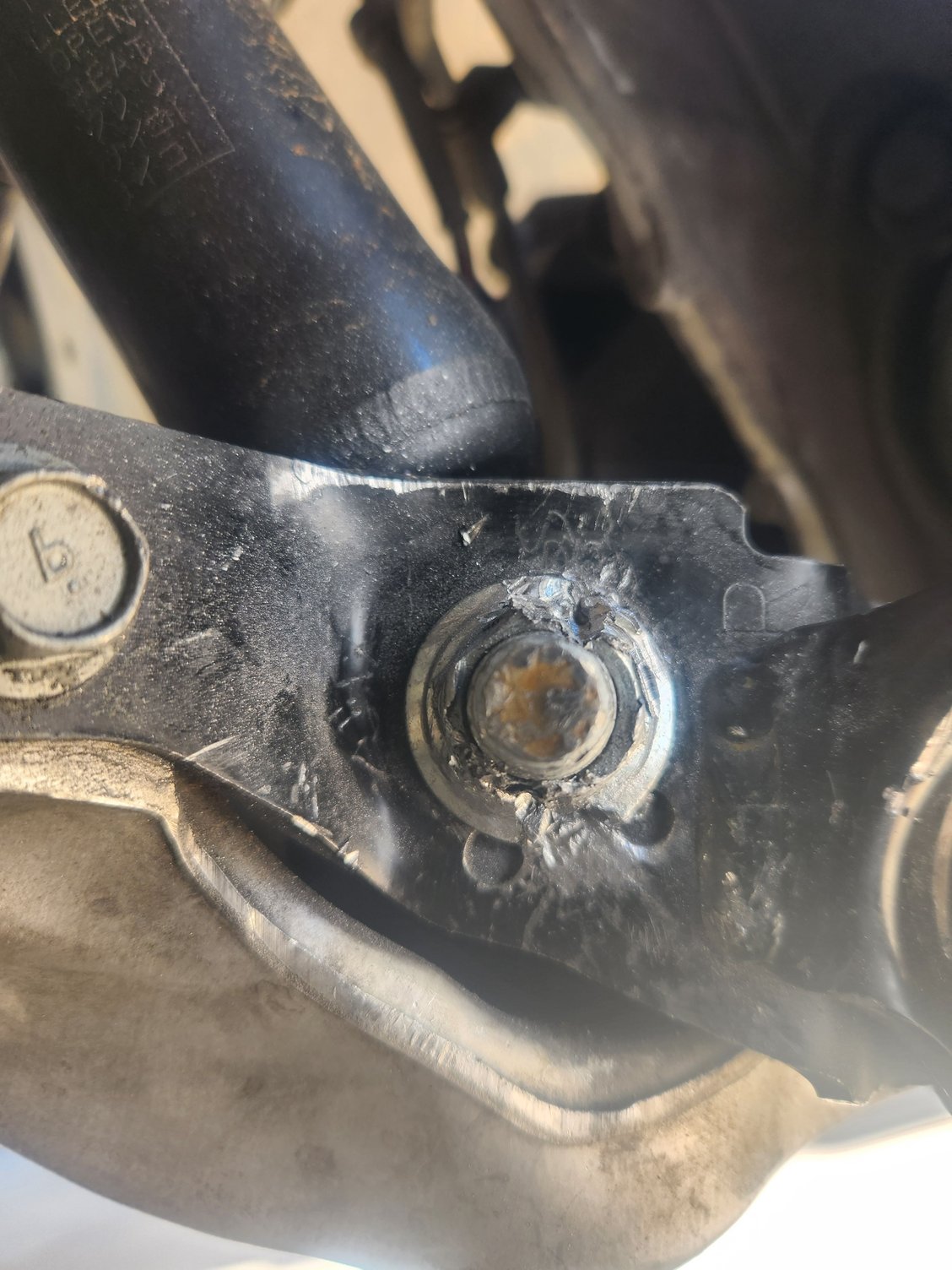

Absolutely miserable experience replacing just the passenger side. Took literally 45 minutes to drill out the rivets because they kept spinning. Had to have one person hold the back side of the river and the other drill all 5 of them out. Then trying to put the arm back in place took another 45 minutes. You must loosen ALL the bolts besides the few that you remove or you ain’t getting that arm back in place. Overall it took 4 hours. Yes I only paid $99 for the gear but even looking back I would have gladly laid out $1200-$1500 for someone else to just replace the arm assembly. I am no longer as nimble as I used to be and I was challenged to bend in all kinds of positions to get this thing completed.
Ha! I hate bending all upside down with that stuff too. I'm 6'2" with a crappy back and neck. I understand. You probably needed some better drill bits to drill out the rivets. The rivets are pretty strong. Those carbon fiber gear wheels on Ebay are very good quality, but a bit overpriced. $100 ea. The guy made me pay separate shipping for left and right wheel. REALLY!? Not cool! I also had the bolt that went "into" the rail that holds the mechanism pull the supporting threaded bracket off. That shouldn't have happened. I J.B. welded it back in place, then threaded in that last bolt. Kinda a PITA, but still worth it. No way I would ever pay $1200 to fix something that was really not all that difficult.
